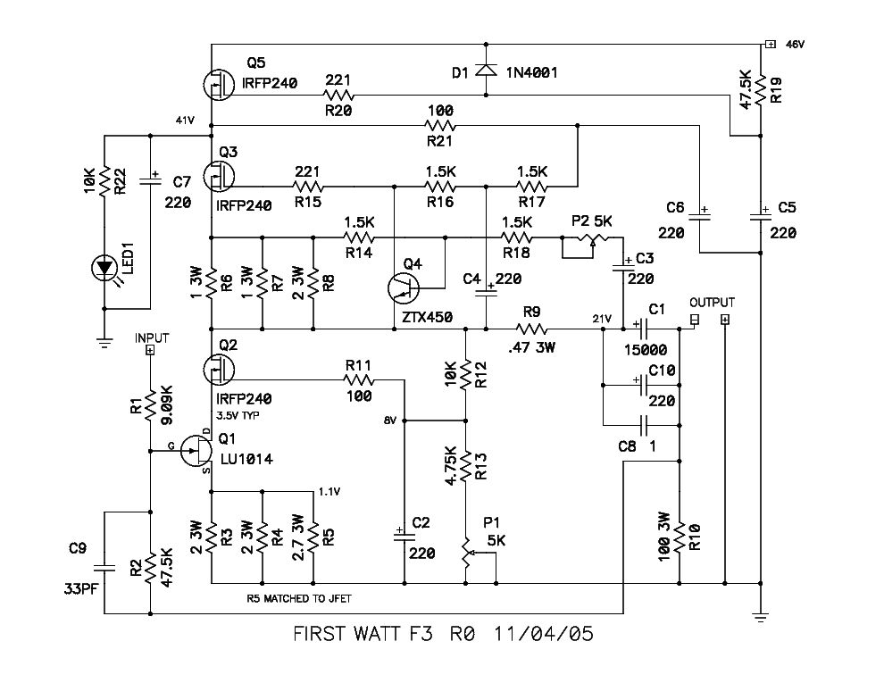

The attached F3 schematic indicates that the bias conditions are Vds 2.4v and Ids 1.5A. I plan to perform a Vgs-Id curve at Vds=2.4V. I can obtain transconductance and Rds while performing the sweep. The measured parameters will be Vgs, Vpinch, Rds and transconductance at Vds=2.4V and Ids=1.5A.
We shall see what the population distribution looks like after some numbers of devices are finished characterization.

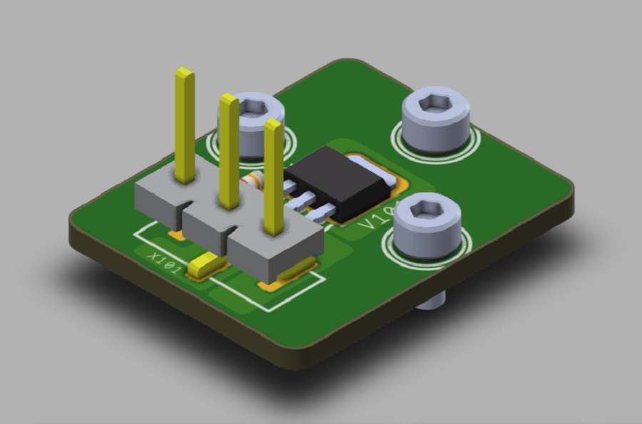

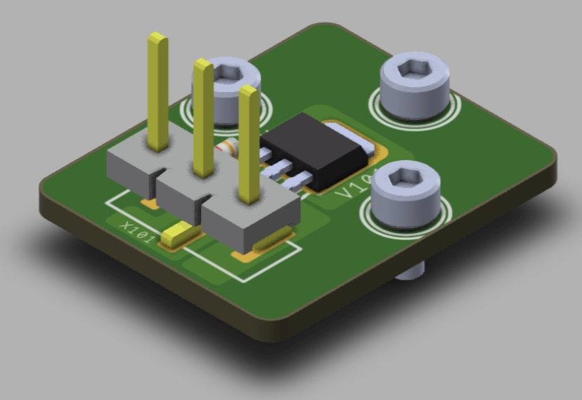

A big thanks to JPS64 for making the design for LU1014D to TO247 adapter in IMS. Full manufacturing data is availble here. I will order a few to make a verification build and wg45 will then provide them as part of this GB as an option.
I am curious about the thickness of the assembly vs. the thickness of an ordinary TO247. Is there a dimensioned drawing of the LU adapter assembly?
What about a through-hole mounting of the 3-pin header? A surface mount header may be difficult to align so that it is straight enough.
We want the PCB to be flat and smooth on the bottom for good heat transfer to the heatsink. So through hole is not possible if we want it smooth on the bottom. Note that the metal PCB is conductive and holes and vias in general, are to be made conductive to the substrate. Most IMS PCBs are strictly SMT. The soldering of the 3-pin header should not be hard using paste and a hot plate. Once it melts use a tweezer to nudge it around to align with the pads. Then cool it to lock in place. The pads have solder mask and are well defined.
The IMS board is between 1.6mm and 2mm thick. The SMT header is a standard part - you can look it up with the part number. JPS64 might have the part number handy.
The dimensioned drawing is in the manufacturing zip file I believe.
The pin headers use 1.14mm square pins spaced 0.200in apart.

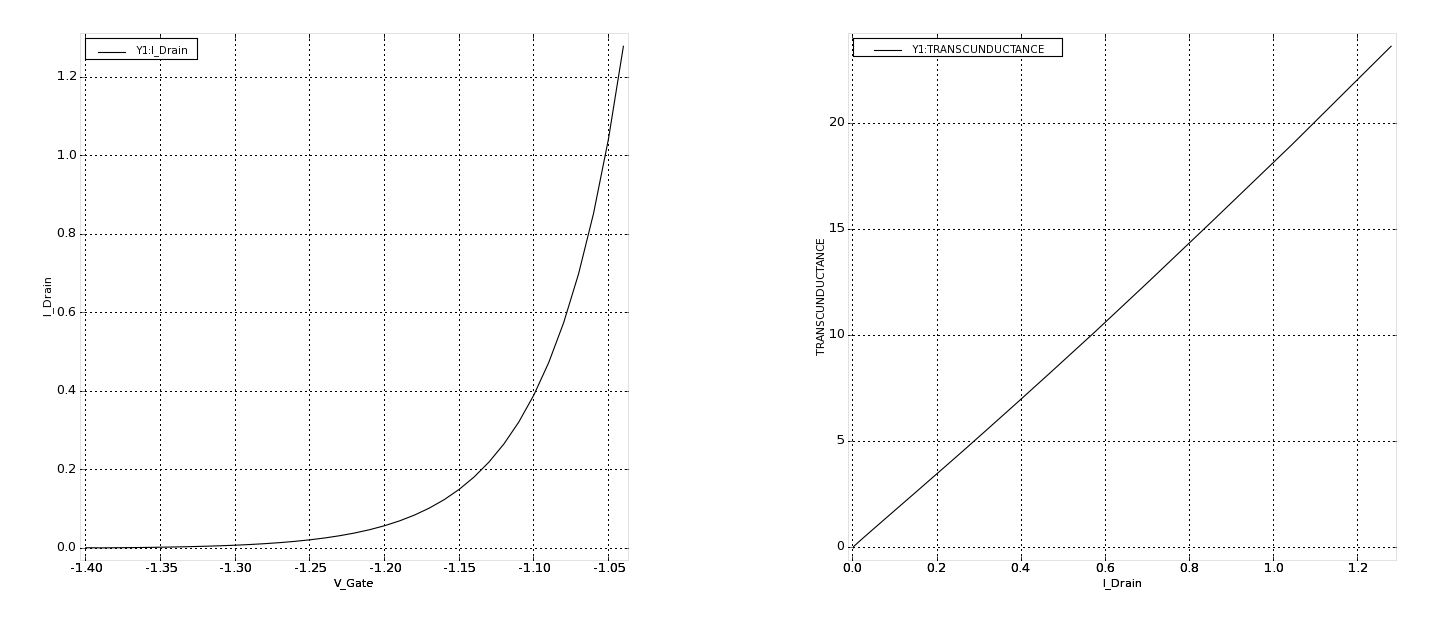

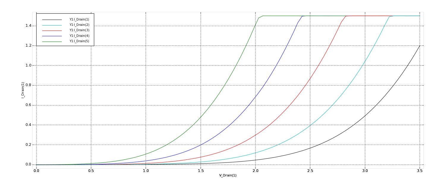

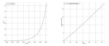

I am getting started creating the setup for matching devices. Attached are family of curves and transconductance measurements for one of the devices in my personal stash. I had to resort to 6-wire connection to make the D-S measurement 4-wire Kelvin.
I can see that I need to measure beyond 1.5A which will cause a re-stacking of instruments and recabling.
