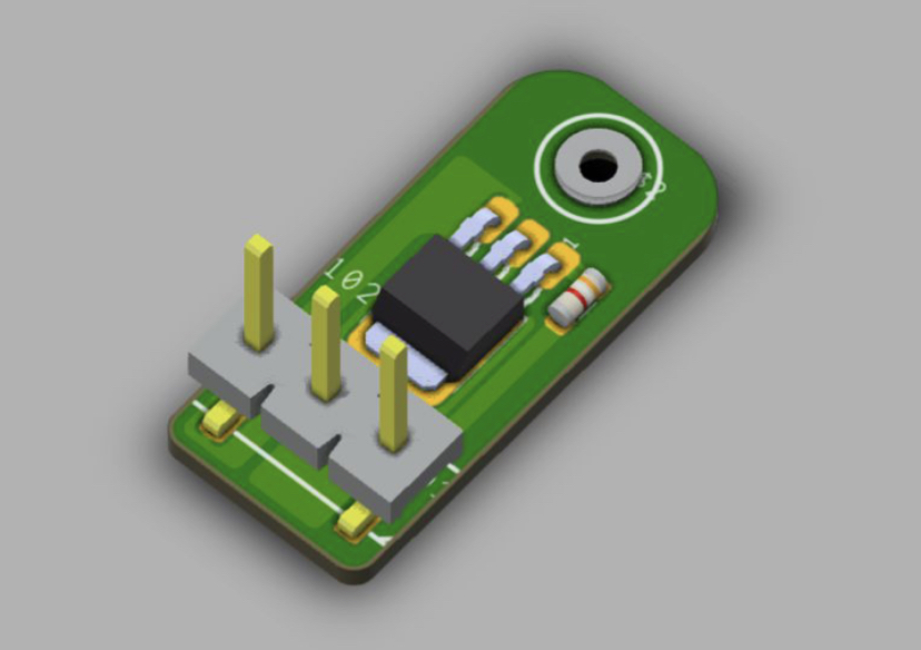

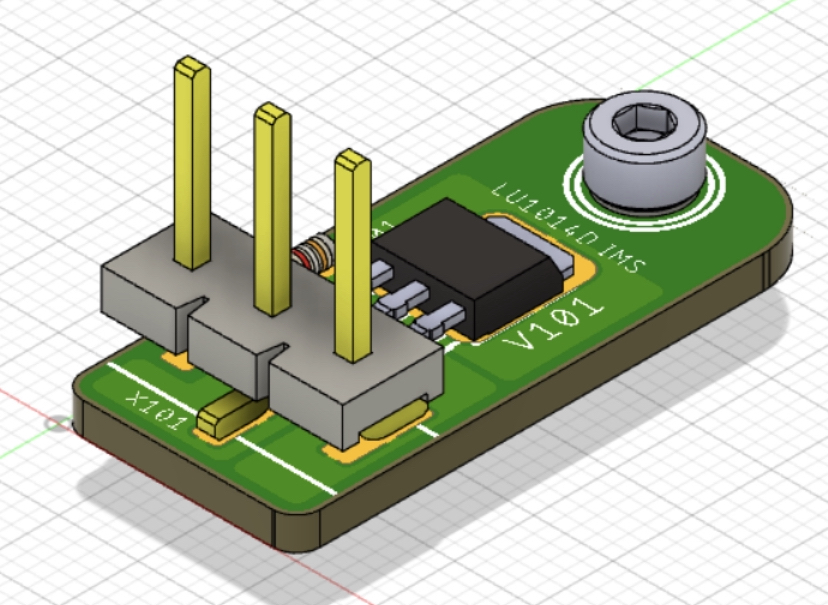

JPS64 is developing an adapter aluminum PCB to mount the LU1014D on to convert it to a TO-247 footprint. Also adding a gate snubber on board. The LU1014D is soldered in place using solder paste and hot plate/hot air and it will use the thermally conductive aluminum PCB as the thermal spreader to the heatsink. Aluminum PCBs are often used to mount high power LEDs to allow them to have heat conduction to a heatsink mounted to the bottom side of the PCB.
This configuration is for underhung mounting.

The aluminium PCB is a very nice and probably best solutions for this.
Low thermal mass and thus you can quickly solder the FET to it.

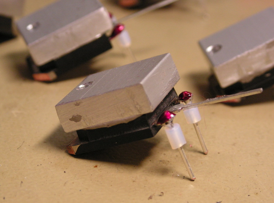

Mounting LU1014D
One can strip the copper plate from any scrap TO220 device, such as 78xx.
10 minutes work. Costs nothing.

We will post the full binaries for the LU1014D TO247 adapter board shortly for anyone willing to handle the GB. I just checked and PCB way will make IMS in small quantities no problem. Single layer 1.6mm is only $26 for 10. A panel of 100 is only $43. So one does not even need to do a GB, although that would be great if someone could organize this with the devices themselves as most folks only need 2. This thread seems like the appropriate place to do this in addition to the devices themselves. It certainly looks a lot better than any makeshift copper spreaders - which don’t give you the nice solid upright pins for attaching to a PCB in an underhung fashion. Also, the temperatures to reflow onto the aluminum PCB will limit possible damage to the epoxy of the device itself as pointed out by joensd.

Installation of the LU1014 on the IMS PCB would be very simple - get an aluminum skillet or old frypan, apply circa 150C solder paste to the pads, place the LU1014 on the pad and put the frypan on a hot plate and use IR thermometer to make sure temps don’t exceed 260C for 10 seconds. But with 150C solder paste, you won’t need to get anywhere close to 260C Have a towel soaked in water nearby to cool frypan once melt is achieved. If the part hits 150C under normal use the solder will come apart of course. But that would be indicative of a bigger problem of either too much current or not a good thermal contact.
You can also heat frypan up to 125C and apply hot air from SMT rework tool over the top and extra heat liquifies solder paste and parts float into correct placement. Then remove hot air and part is never exposed to high temps for more than needed to liquify solder. Cool pan with wet towel and fan air over the top to cool part quicker.
I'm organizing the GB for the Lu1014D. We're using Papa's supply. Still sorting out a few details before I post a signup spreadsheet with costs. I hope to have those details next week.
I like the idea of offering the Lu1014 PCB. PM me and lets see if we can get the PCB design finalized/tested so that we might be able to line up the PCB with GB device shipping time. I know ZM has some thoughts on the PCB.
