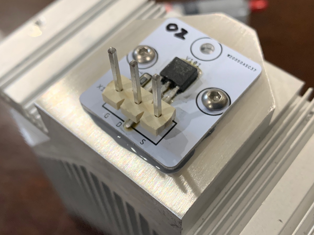

Good news - the installation of the LU1014D's onto the IMS PCB went without a hitch. You too can do this - all it takes is a skillet and hot plate set to low heat and tube of Sn63/Pb37 no-clean solder paste.
Here is the finished integrated LU1014D / gate stopper resistor / header pins on the aluminum IMS PCB:

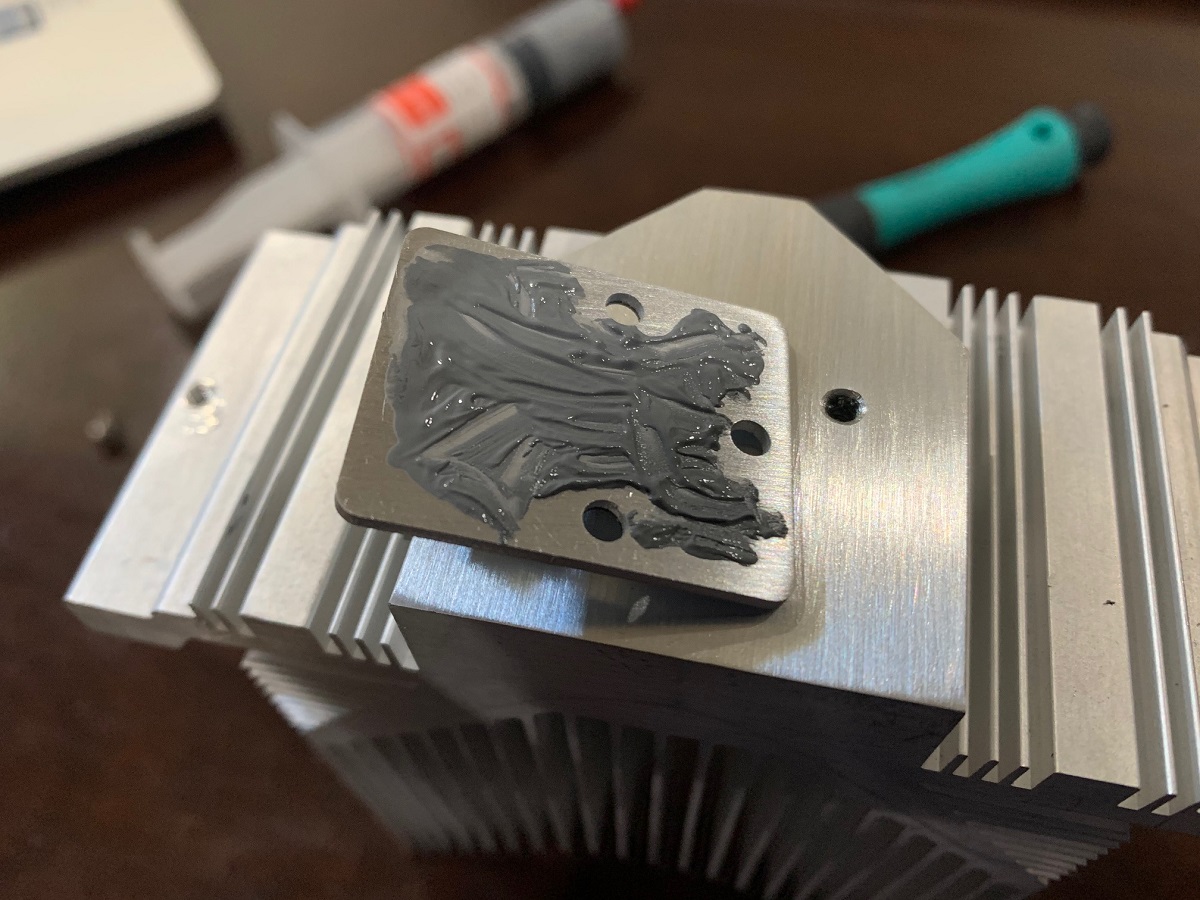

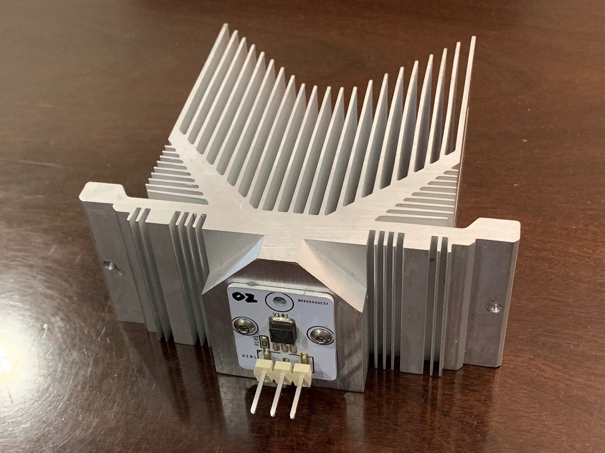

Heatsink is now mounted. Used a surplus HP CPU cooler part number CN-0RC651-41362-033-06TC. Drill and tap two M3 holes. Sanded surfaces flat with 120 grit sandpaer on flat surface. Thermal paste.

Looks great...love those heatsinks! Are all CPU coolers forced air?
They are intended for forced air if you want to cool the 100w they were designed for, but this size heatsink can handle 15w passively cooled no problem. The ones with copper pads and heatpipes I have pushed to 160w for a single IXYS MOSFET using a quiet Noctua fan.
