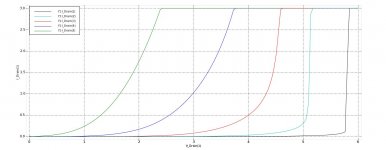

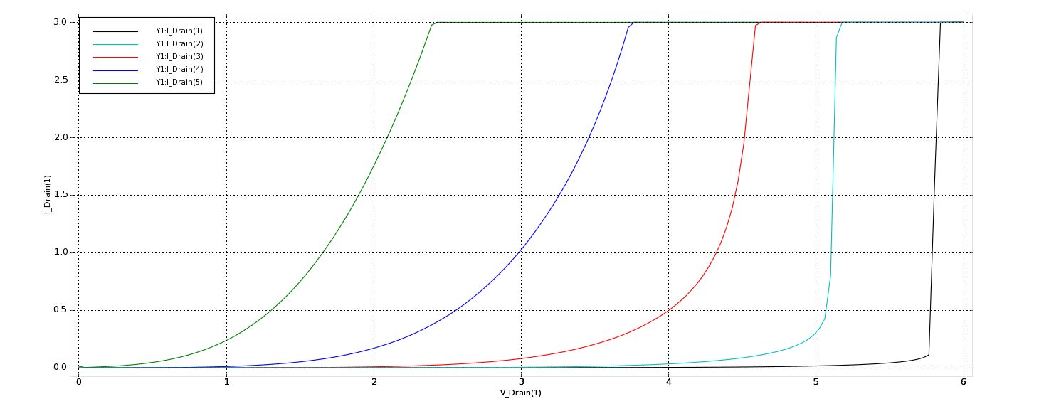

How are the curves for the Pass LUs after 5V, do they have the same strange bends as the Ebay LUs ?
Here is a device from the eBay stash. It has the same flavor of runaway. I think that the bend back was either the instrument or the test configuration. Recently I have changed to 4-wire Kelvin on the D-S connections to eliminate the voltage drops in the D-S wiring. The instrument used is brand new to me. It is the latest production model.

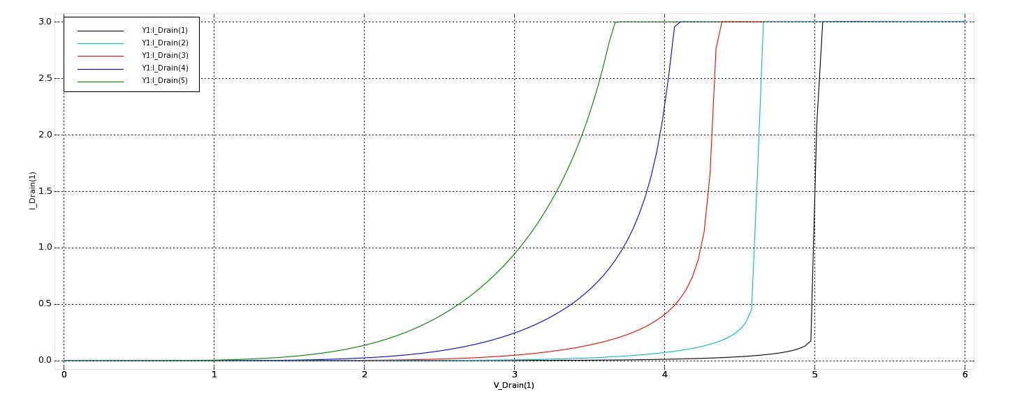

Nice, so the ebay stash are probably also genuine LU1014D.Here is a device from the eBay stash. It has the same flavor of runaway.
If they are not genuine, they are the only fake semiconductor with triode curves that I know of. If they are fake, the are the best fake ever and worth every penny I paid for them. The price is around USD $1 /each. In that range.

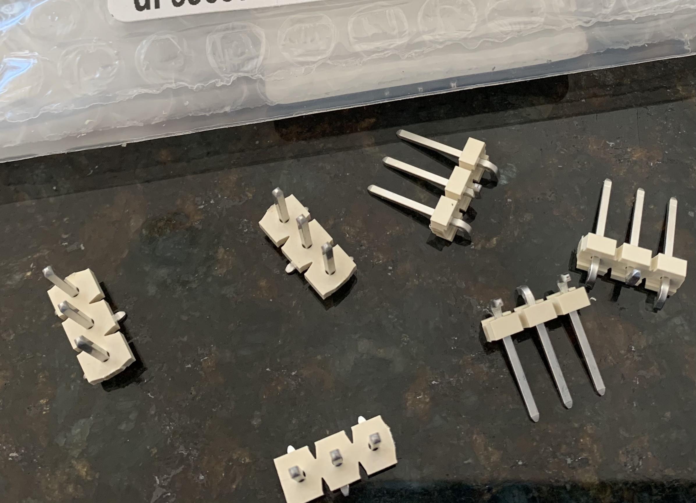

The Samtec 0.200in pitch SMT header pins arrived. They are beefy - I have never seen such thick surface mount pins. Thicker than typical legs on a TO-3P MOSFET that’s for sure. There is some weight to them! Looking forward to assembling a few of these with hot plate/hot air combo.
We have a lot of interest so there might be room to make these ENIG, although really no benefit as there are not a lot of small SMT parts that require a smooth surface afforded by ENIG.
These are HASL but since applied on insulated aluminum substrate, they have a mirror finish. It’s reflecting some ambient light that gives it a pale champagne glow. It really is just mirror polished Pb. 😛
The headers look like normal headers with the end of the pins bent 90 degrees.

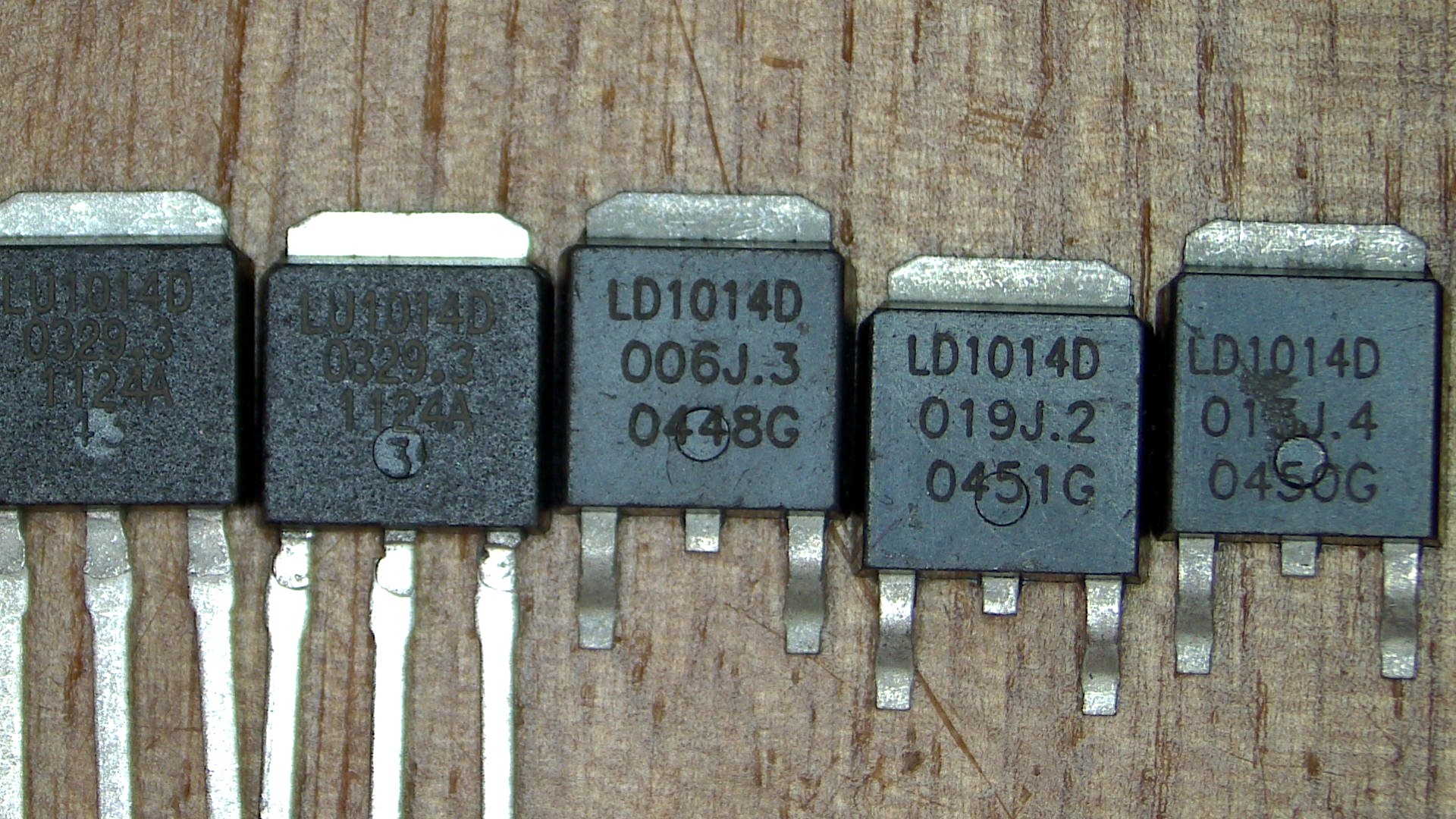

I also have some LD1014D, it's the same as LU1014D but in a DPAK package.
Here is a trace of a LD10114D with Vgate -0.8 to -1.8,
it has also those nice curves 🙂
On the picture you see also two LU1014D with new legs attached,
it seems that the surface has been sanded and reprinted.
In the circle that is a little deeper you can still see the original number 3, and that font type corresponds to the original font of the DPAK.
Now the speculation part:
I think those are refurbished, sometimes when components are installed the lettering is removed to protect against copycats.
Later they were recovered and new legs attached + new printing.
I meant the pins are thicker than the 0.100in pitch ones for signal cables.
