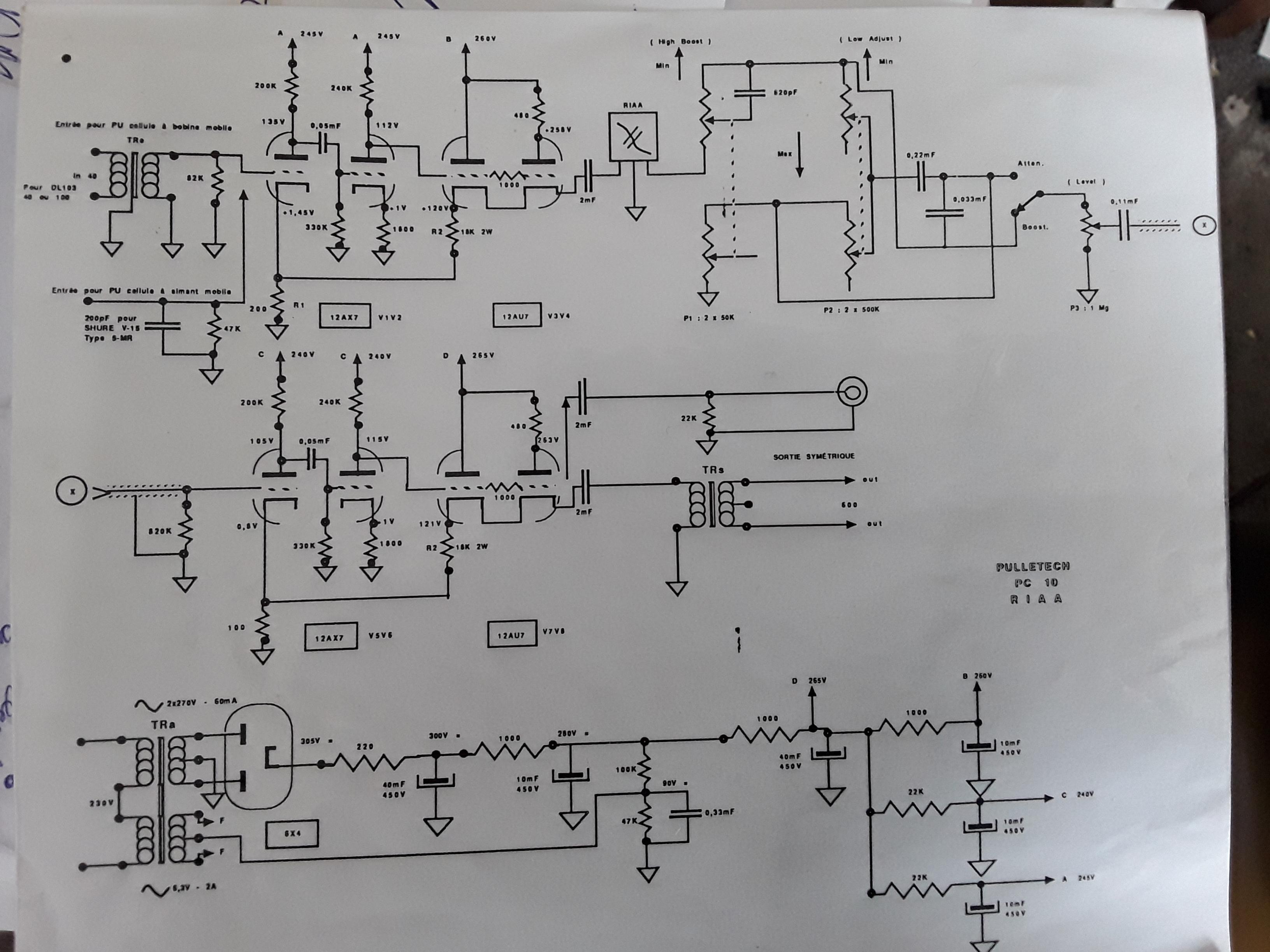

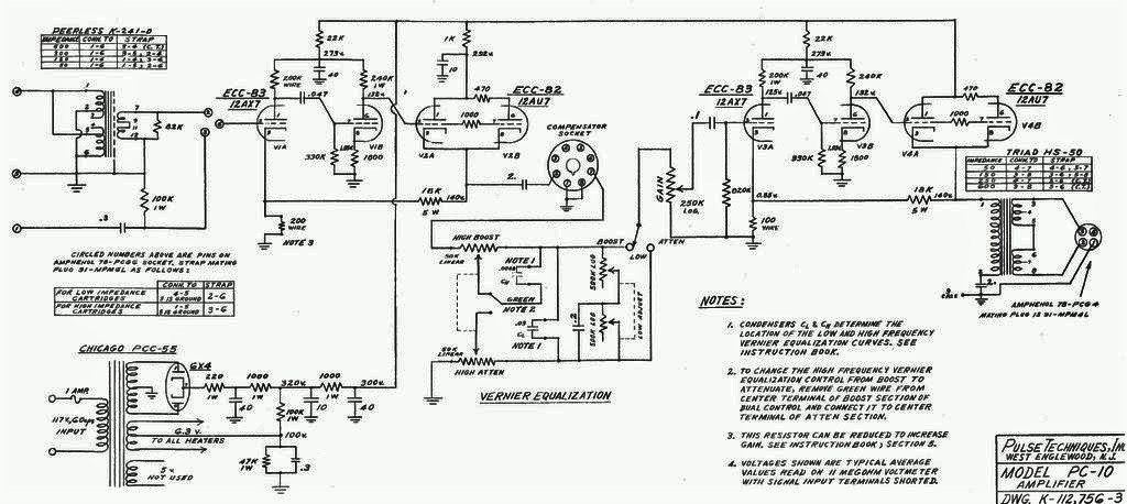

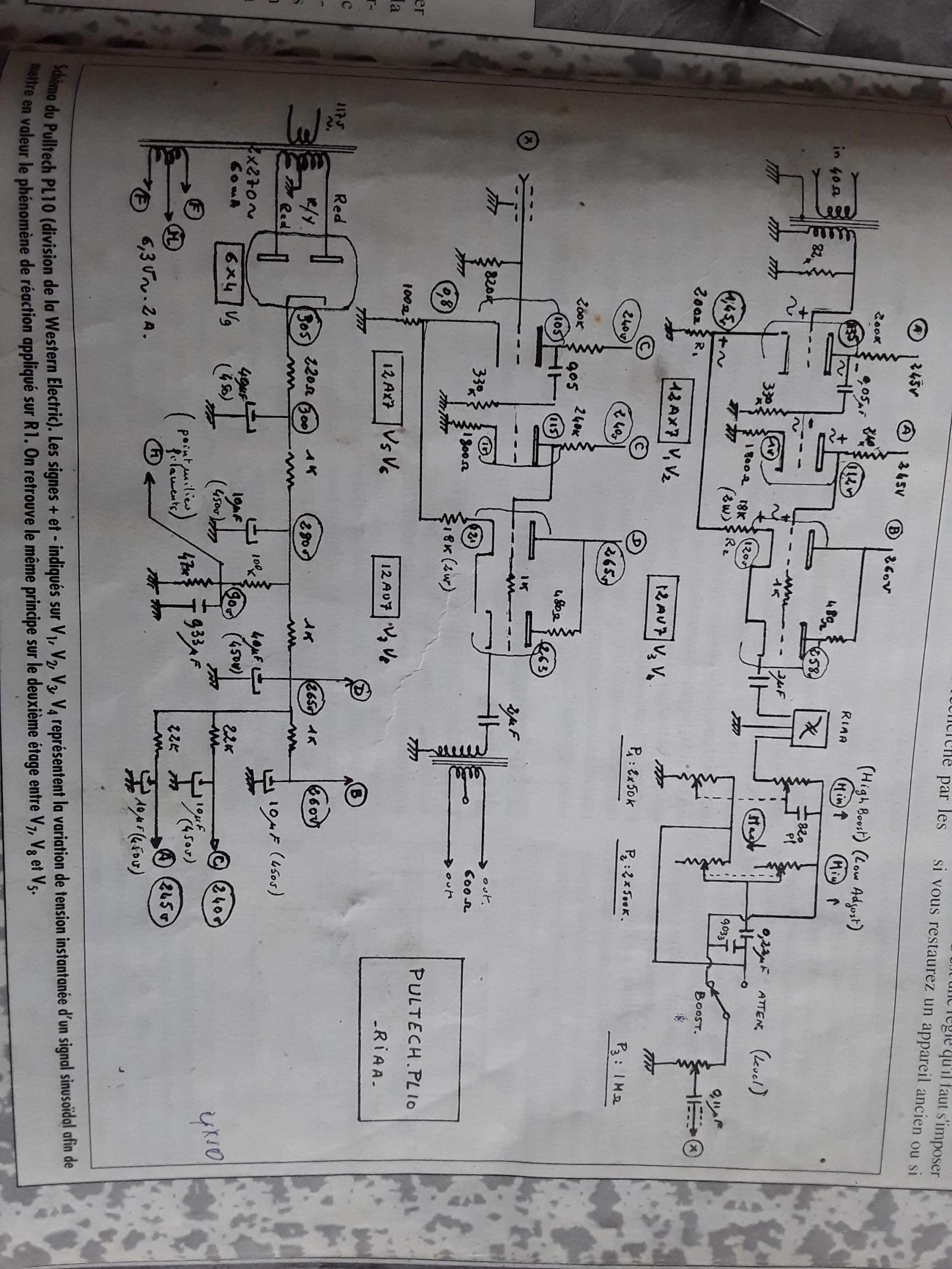

Attached Pulltech PC10 LCR phono RIAA kindly supplied by Eduard.
