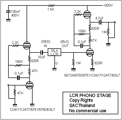

Today tried the Silk circuit with voskhod 6n2p-ev + ge 6072A, sounds much better than shishido though Thorsten mentioned the first stage current maybe too low to drive the LCR.
Only annoying is the grid leak, will try LED bias with Gyrator to keep the current at 1.5-2ma.

There is a bit distortion using Silk circuit, so I decided to use Valve Itch Phono's first stage and added a source follower (10ma), now it has enough power to drive the LCR while the sound is too aggressive. (http://emisukeaudio.sakura.ne.jp/EM-TUBE_EQ3_Ver2_KAI.pdf)
Then I built the gyrator hybrid mu-follower (bartola.co.uk) to replace the top tube, had to increase the Rmu from 470ohm to 50K, running at 1.5ma it drives the LCR well and better than previous experiment. IMHO this is not really the place for 6n2p as the hybrid mu-follower expect around <5K range of Rp, 6n2p-ev is 40K+.
Next step is to try the E88C and EC8010 as first stage.

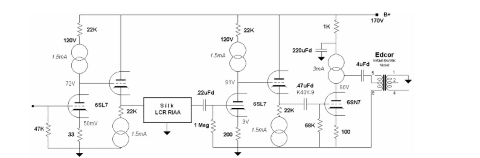

6SL7(with CCS 1.5ma) + 6SN7 CF(6ma) + 33uf + LCR600 + 6SL7 (1.5ma) + 6SN7 CF (2ma).
The CCS for first stage really makes the difference.
The gain is pretty high already.

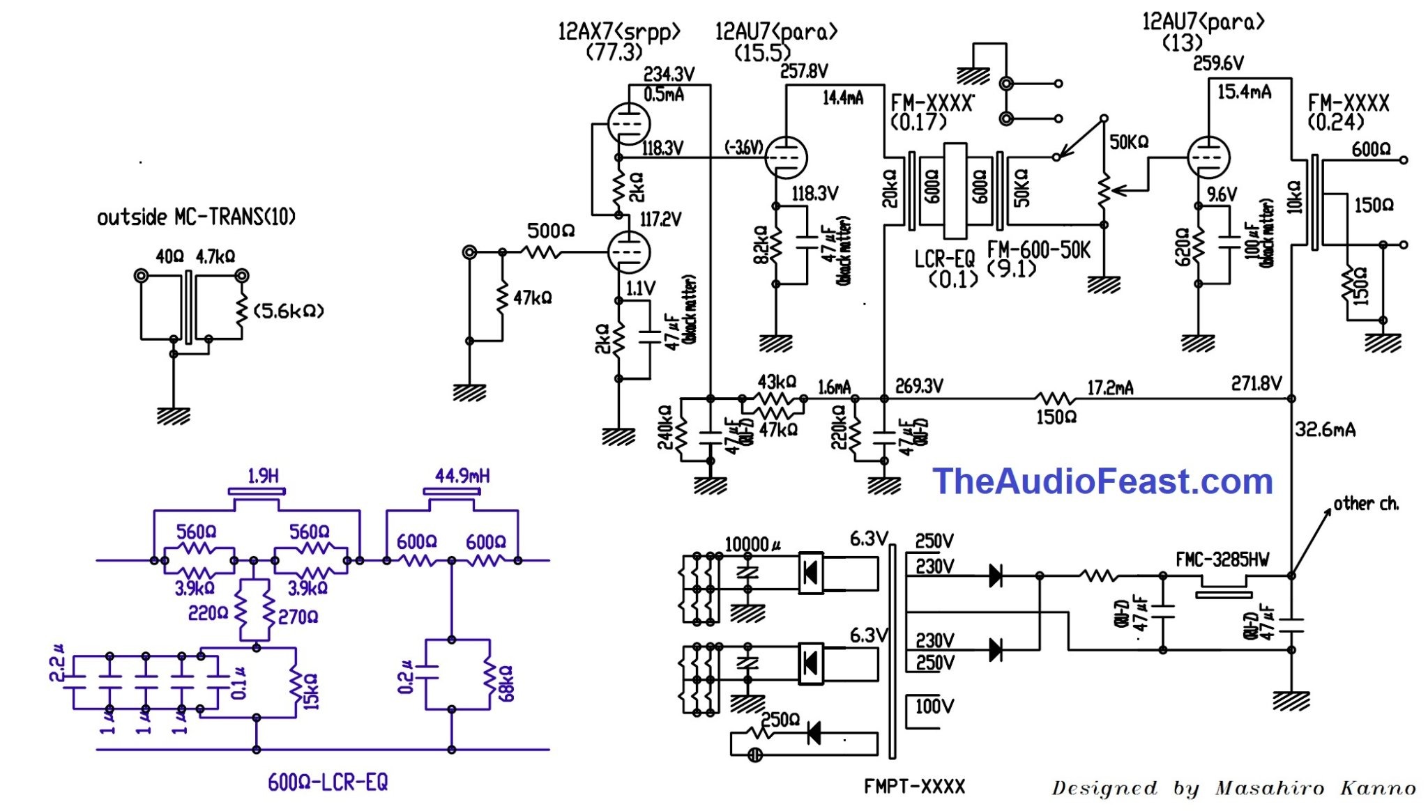

I just got the hashimoto 20k/600 and H-EQL. They were reasonably cheap and I have the rest of the stuff in hand, so why not? I am building the Salas valve itch first and I will get the PS and the basic building blocks ready.
I am liking the first stage of the Kanno to the H-EQL, no caps but adding two more xformer/channel seems crazy and I am having a hard time following the step ups&downs in the voltage and figuring out what you get as output. However, the lower circuit with the higher gain 12AT7 + follower seems interesting as an alternative to the Shishido and its huge output caps that to me seem counter to the whole LCR philosophy.
Making a hybrid circuit results in only one small cap in the signal path at the end, after all amplification and equalization are done.
Comments appreciated.

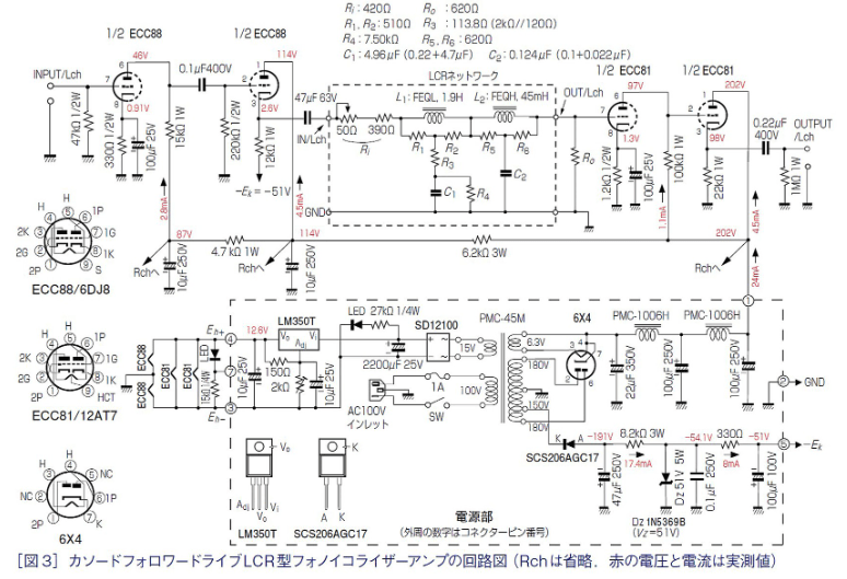

Just finished this one: https://www.dhtrob.com/projecten/phono_lcr_d3a_ec8010.php#* From my country man. Sounds excellent, better than anything I have made before. I used Sowter LCR units, with Silk from Thailand for the other.

Are there actual schematic for these? I don't get audio review here and I am not good at turning words into schematics. 😉
