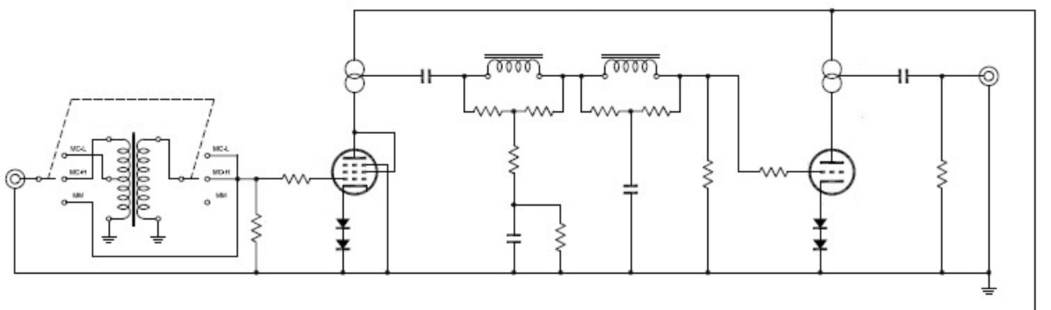

Would you like to share the design or parts of... I’m very interested in LRC RIAA and I would like to use triode cascodes as much as possible (personal preference). I have played with ltspice last night and concluded that a 6k approach is the best compromise (in a simulation). The problem with 6k aproach is I can’t find the coils anywhere.
Silviu
Sorry not to pick this up earlier, but there is a thread on the valves section now. I had the inductors wound to spec by Sowter, but as they have a design number now (on the circuit on that thread) they could be remade by Sowter quite easily.

I have 3 stage phono preamplifier with riaa separately between stages. What if keep this topology but use lcr for one of the chains olny (or both)?

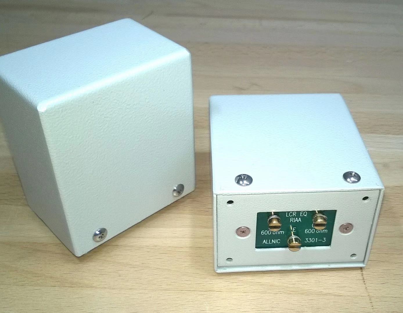

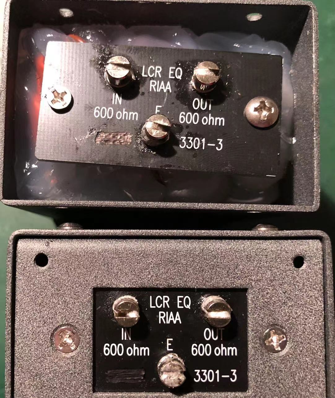

Just got a pair of LCR from acoustic dimension, seems oem by ALLNIC? Also saw similar module on Thomas Mayer's machine.
Thomas Mayers uses LCR from Acoustic Dimension.

I just build the shishido today with acoustic dimension LCR and ssvh2, it sounds bit better than salas valve itch, quieter and more refined.
I am using an external tube regulated power supply, I have no noise.
The gain is low, and the sound is not impressive at all and looks like bit distorted
Gain is a bit low but not too far probably 35db total, my others are 38-40db.
I am using 6n23p, at 17ma they are very hot.
What LCR modules are you using and what coupling capacitors? Do you have also bypass cathode resistor with capacitor?
Acoustic dimension LCR 600 (oemed by allnic), first stage 33uf obbligato bypassed with ft-3 0.22uf, output stage obbligato 1.5uf. Rk is bypassed with 1000uf.
