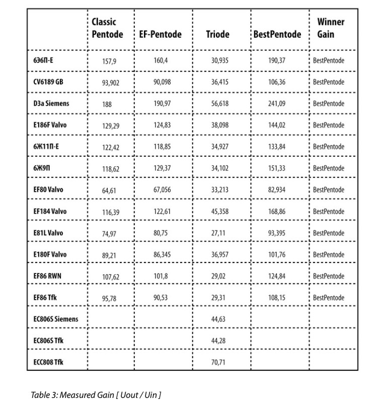

Try the best pentode circuit for first stage, you can get 200-400X gain before the step down IT.

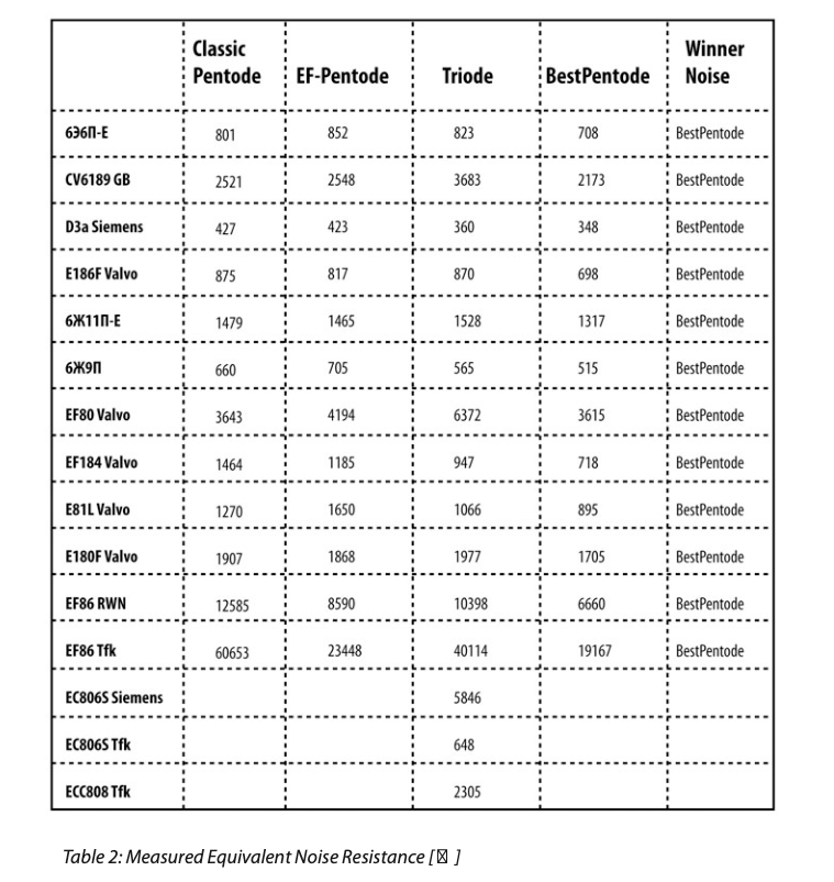

I the last LCR I get around ( and more) 80 dB if s/n with 32-34 dB of gain that I consider the minimul legal value for MM.

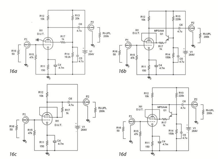

Are there actual schematic for these? I don't get audio review here and I am not good at turning words into schematics. 😉

LCR benefits from strong input signal, you can either get from a high ratio SUT, an active pre-pre, or high gain best-pentode.

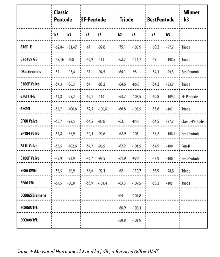

Best pentode (16d from linear audio article by Frank Blöhbaum) sounds more similar to triode than regular pentode, personally I prefer it (6j9p, 6j49p) over lots of single triode/strapped like e810f, d3a and ec8010.

Best pentode has 10-20% higher gain than classic pentode (gmXRa).
So overall gain is 3-4X than triode mode, saved the step up IT after LCR.
