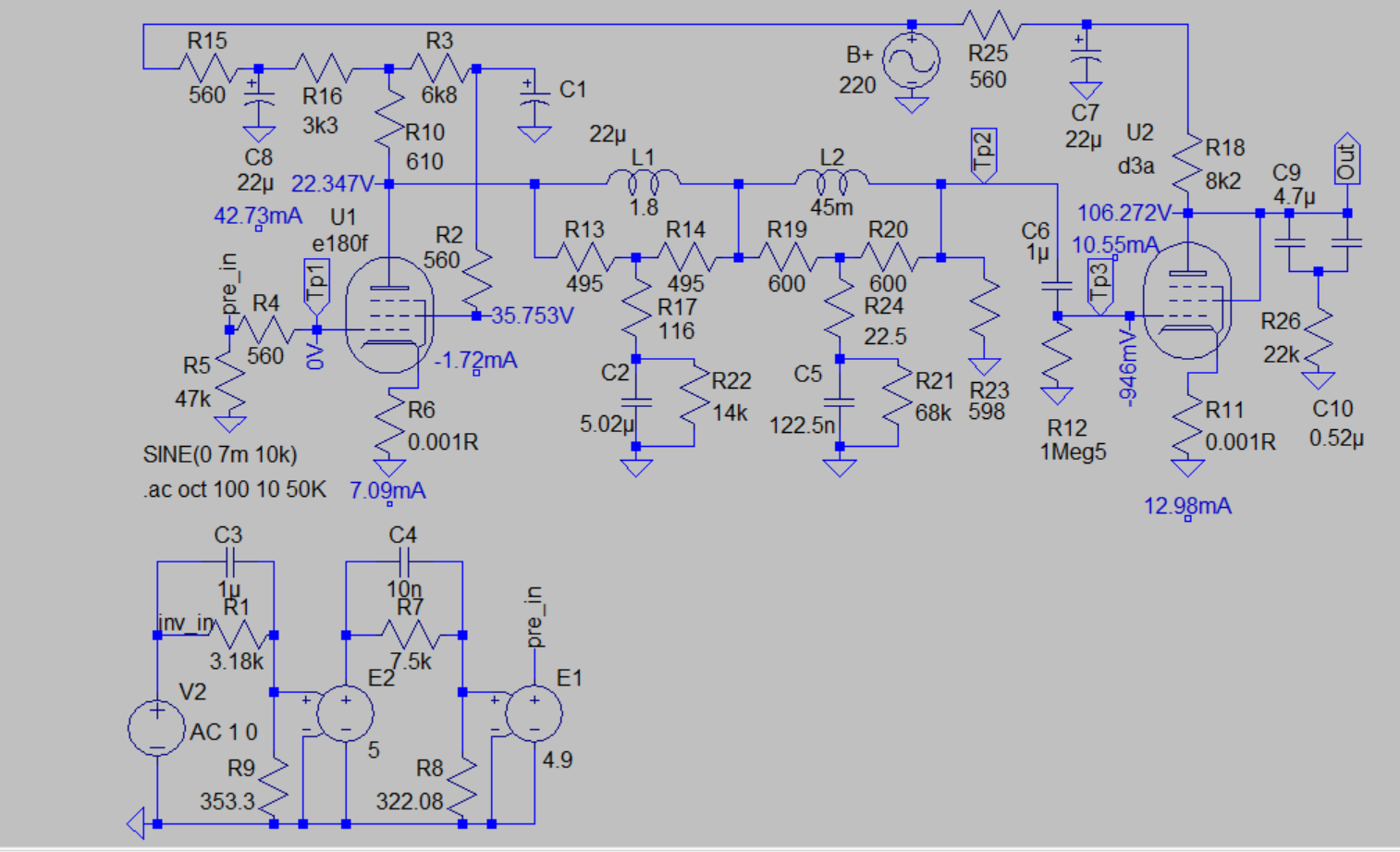

If I remember correctly, this schematic original was in Dave Slagle's forum:
:: View Forum - Phono
D3a as VAS, DC coupled 6N30P (russian 6H30) as CF (the another 6N30 half as active cathode load).
The output impedance only 41R!
Correct 600R loaded LCR, another AC coupled VAS stage with OPT.
If you don't like OPTs, try Aikidio.
The attached schematic is only a simulation not your LCR RIAA?
Why ebay shows E810F and D3a like the same tube?

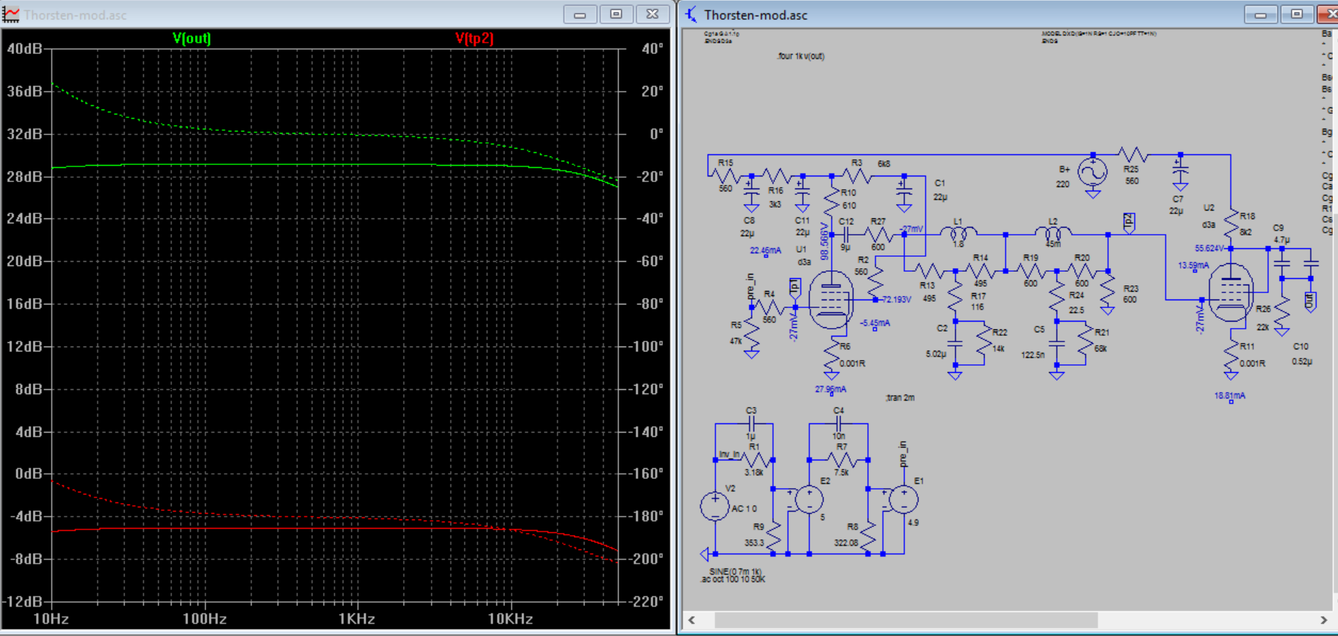

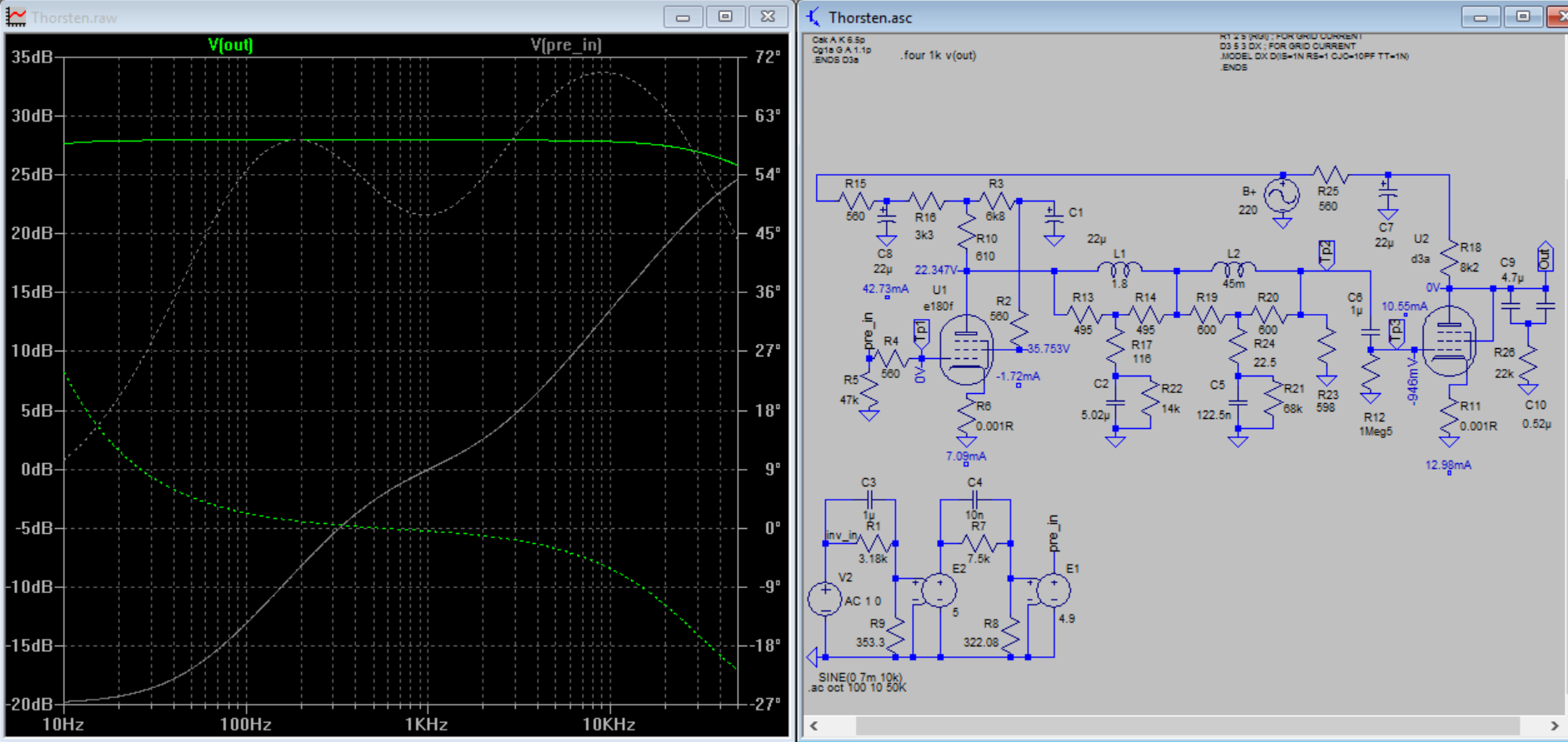

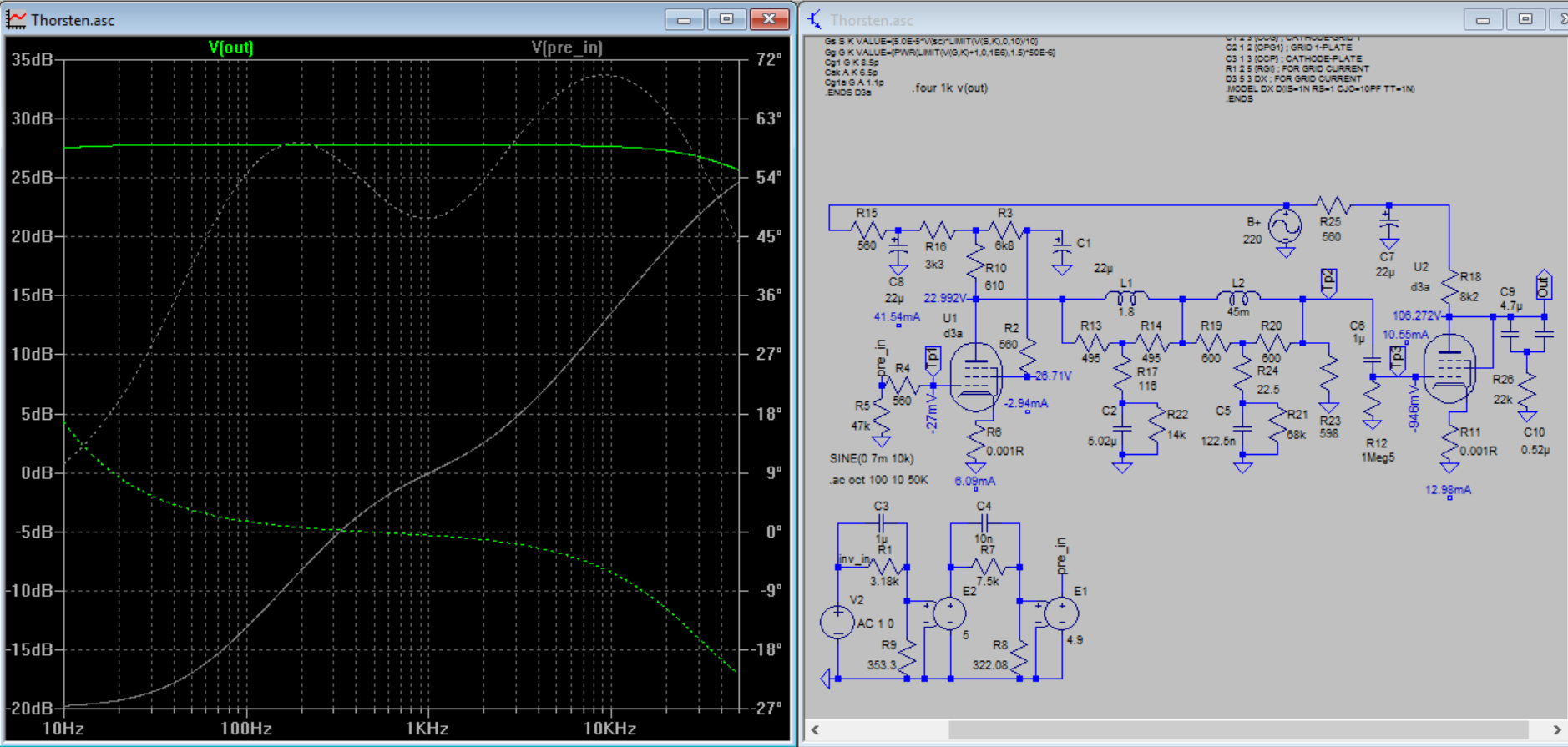

It'll work, according to the SIM plots, but for e180f, the grid is 0, for d3a is a bit on negative(?)
There is a capacitor in the path, since the plate voltage is low, should be direct coupled to 2nd stage IMO.
Thanks Koonw.

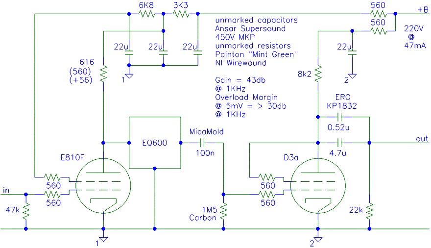

But I still got it incorrect, regarding the terminating resistor R23, it can not be grounded as it'll carry DC current, therefore it's better to insert right after the plate of the 1st stage as DC will be blocked by capacitor C6. In the original sch you don't find 600 or 10k terminator I think, maybe pre-installed in lcr unit(?)
I now removed the terminating R23, and put C6 back as 100n as in original, the plot is stil quite flat. C6 and grid resistor R12, 1.5Meg are involved in 2nd stage output which now is a bit tricky..
Yes it's installed in the EQ600 unit
If it exists, then you can not directly ground the terminating resistor(?), and an IT is in order to ensure LCR pad can be terminated properly without the DC or remove it for this sch to work.

If I remember well from old story about LCR RIAA; input tube should be strong to good drive LCR circuit in RIAA.

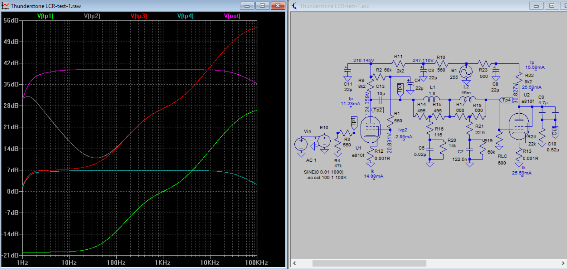

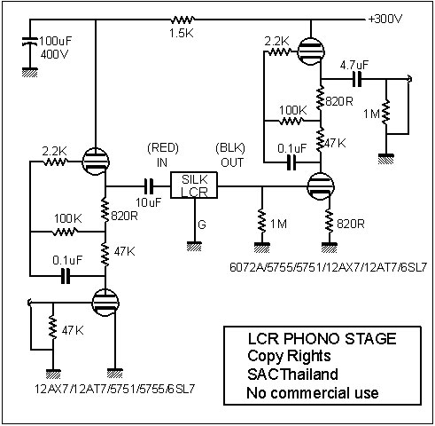

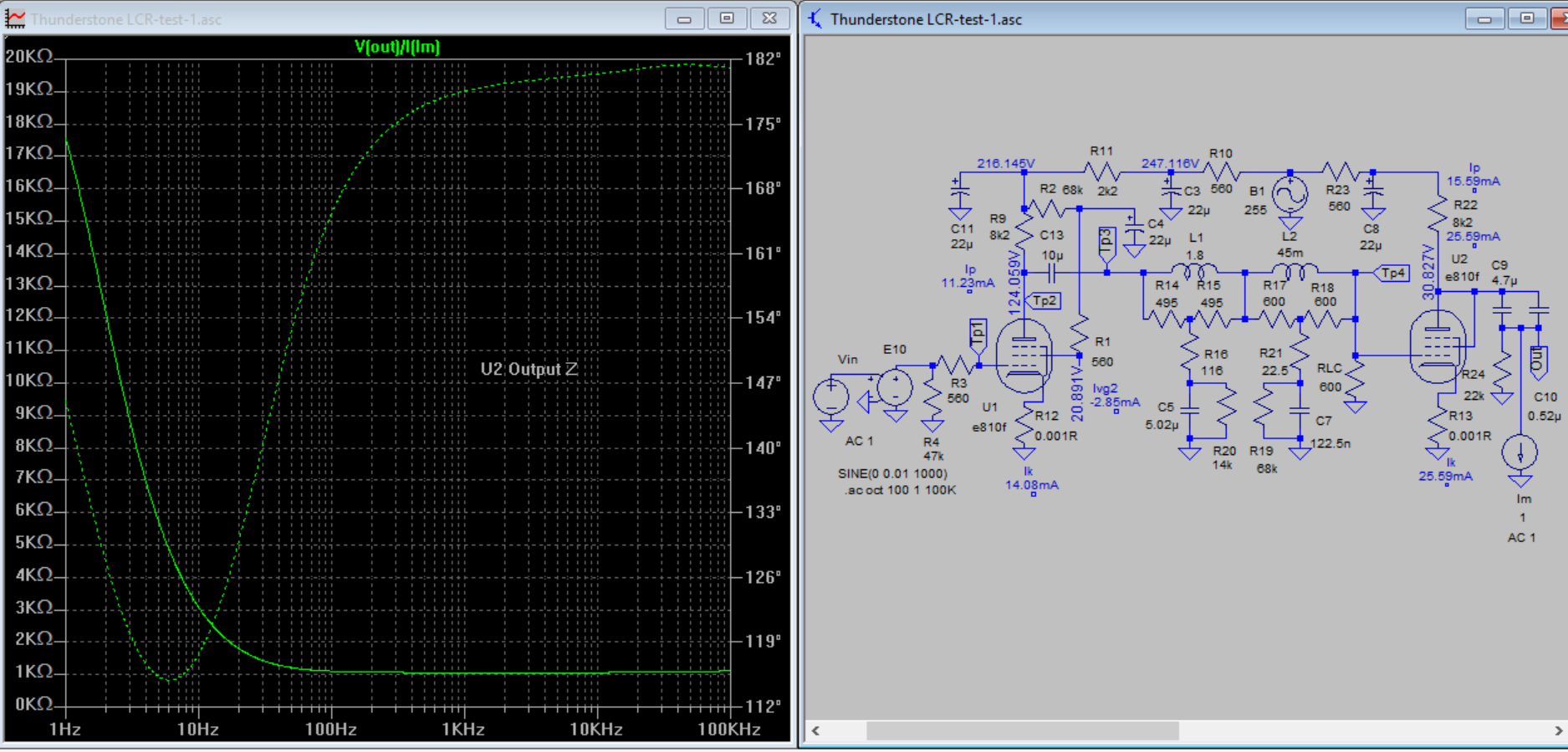

Now back to SIM. Now that I inserted after the plate a 9u cap C12 in series with 600R, R27, therefore do away direct grounding part. Checked that Silk LCR sch, you'll notice the connecting component is also a 10uf cap. so I don't see why this shouldn't work as well.

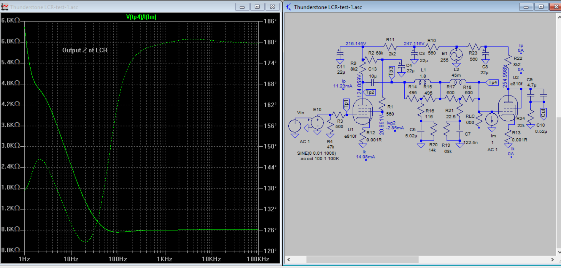

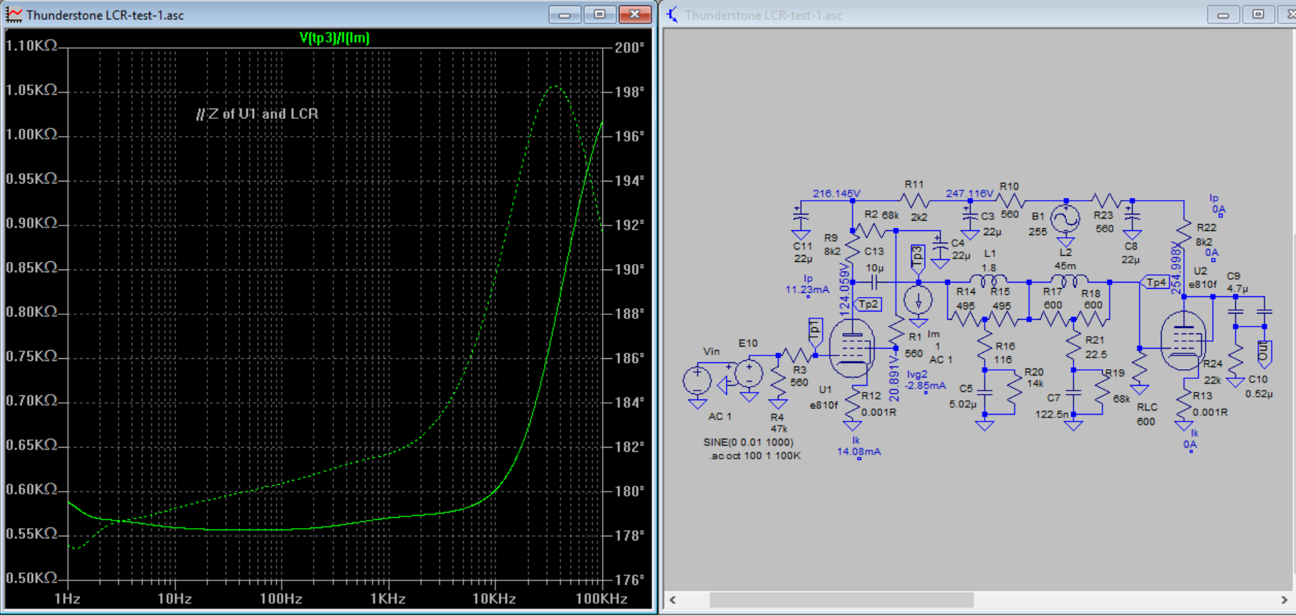

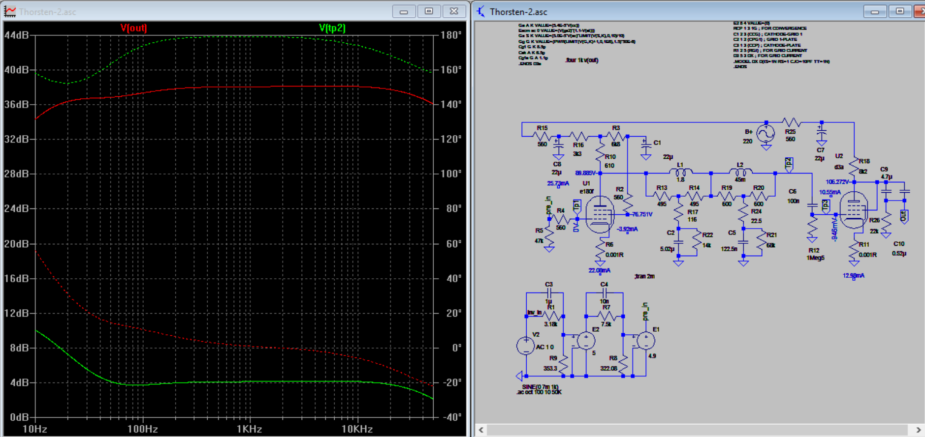

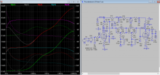

Now I have a few sim plots of LCR phono using E810F. It's a combined sch of zero bias of Thorsten and cap coupling of Thunderstone. I plot the input and output impedance at various test points to verify that they're technically correct, it's quite an exercise for me. Sonic wise you only know as you build it. Likewise I hope this help you to understand and raise appropriate questions. For example output impedance of input LCR driver has been raised so the combined Z is close to LCR input Z, do you agree?

note C13 10µ vs 100n ....
I noticed that. That 100n and 1Meg5 pairs or any others pairs is no where close to termination resistor of 600. If you think you can get away with it think again after you verify the impedance at each point, then you'll be surprised to see that the characteristic of 600 ohm LCR unit has not even properly utilized. I like to leave the verification to others to be meaningful if they have not done that already.
