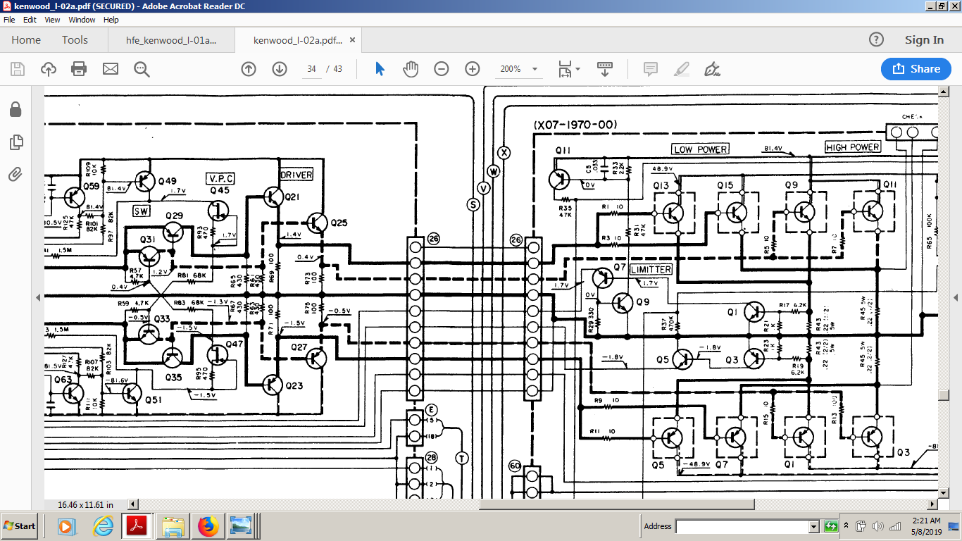

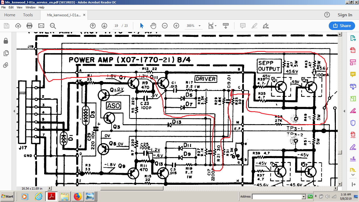

Just a simple question:
You have here a transistor in class a driving a final transistor in class b forming together an atypical Sziklay pair, it can't be actually named a Szyklay pair at all...
Apart from its merits in controlling crossover distortion in class b ,
is this a form of controlling the final transistors quasisaturation too with the help of the emitor and collector resistors?
Are we not trying to push "signal transistors" into power application? A 600mW transistor is too small for the VAS in an amp with more than 40V rail-rail, unless you run it at a tiny current, where their quasi-sat curves are not that bad. The diff-amp also should not be more than a couple mA. Higher power amps need a VAS in a 10W package like to-126, where you will find things like mje340 and mje243. Some of these are a bit slow but we usually saddle them with external compensation caps anyway. So, something to be aware of, but not a real problem.
If a cascode is used, a small signal transistor with beta of several hundred can be the gain device and it can be operated at 10mA while a medium power transistor can see most of the voltage.
I am working on characterizing small signal devices for maximum linearity at minimum voltage at 10mA bias for both input stage and VAS.
Be sure to read the sections of Bob Cordell's book which describe how to get another, somewhat higher voltage, supply rail for the low power sections of a high power amplifier. Now you can cascode to your heart's content without compromising the final output voltage swing.
It's pretty obvious: wind another few turns on the power toroid and put that in series with the main supply. Voila, another 5V or 10V or 15V, whatever you want. Filter it, regulate it, smoothen it, do whatever you like, and apply this to the IPS and the VAS. The extra supply means you can cascode freely. If your amp has bipolar supplies (+V and -V), do this twice.
Do you mean a, b or c?

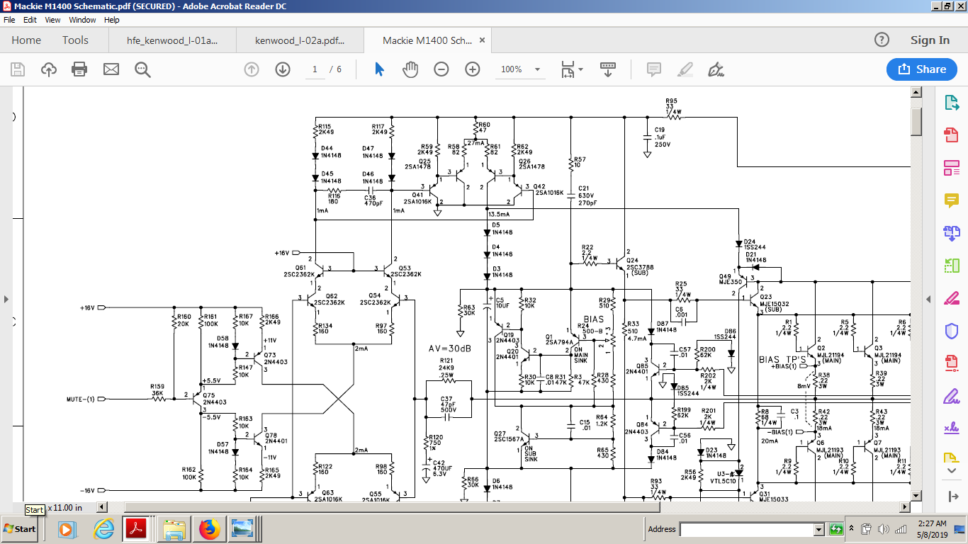

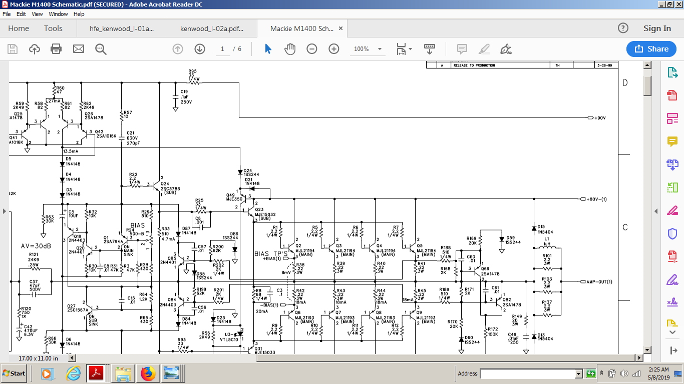

A cascode eats up a couple of volts keeping the high gain tranny biased. Quasi sat meany you just lose a couple of volts of undistorted voltage swing. Either way you lose a little output. Ok on 50 volt rails but maybe not on 10. You just need the right transistor - one that keeps all its beta at one or two volts. That’s why you were supposed to buy up a bunch of those C6043’s and the PNPs when they announced EOL.
