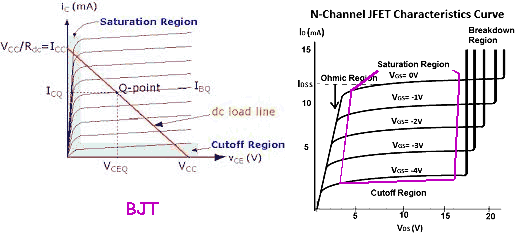

Shockley used the term saturation region for a JFET in 1953 this is in all major texts.
I have often been bothered by this.
A JFET is "saturated" when Vds is above say 5V-- where the curves flatten-out like a pentode. The middle of the curves.
In most BJT chatting we say "saturated" when Vce is *low*, tenths of a Volt. The left end of the curves.
These are not even the flip-side of the other, but very different concepts.
It's actually when the gate to drain pinches off and there is no abrupt knee like that graph it's a nice parabola to find the knee and a transition that (in the level 1 model) unfortunately has only the first derivative continuous. That graphic also loses the fact that JFET's have a triode region which can be put to use when one is pushed up against trying to get something to work on a single cell with 1V Vp FET's.
Scott, I am also a bit skeptical about the sales pitch. "Dear stranger, please figure out the fabrication details of the 2SC3503 discrete transistor which is no longer sold new, please put those details into SUPREME or another process simulator, and please run some simulations to show exactly what's going on in the so called quasi saturation region, then please post them here for us to all read. And please accept our grateful thanks in lieu of pay or barter."
....there is no abrupt knee like that graph... That graphic also loses the fact that JFET's have a triode region....
I will not argue the artistry of anonymous draftsmen found in a hasty Search. Yes, that JFET knee is ugly.
My point is: "saturation" in a JFET is "above the knee" and Shockley is our authority; OTOH "saturation" in a BJT (or pentode) is generally understood to be "below the knee".
I'm sure you know the difference. But I see less-experienced folks flummoxed by the different meanings.
And the ugly-knee JFET graphic shows an "Ohmic" area, your "triode region".
The point being, I guess, is that there is ample tradition in the literature for the term "saturation" having some semantic flexibility.
Except they drew it to imply only one resistance with no Vgs modulation
