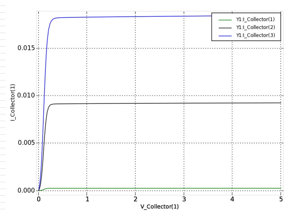

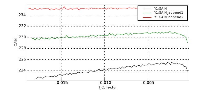

KSC2690AY
PB2 was kind enough to send me a few devices to run through the curve tracer.
The family of curves show that this transistor turn on quickly and turns on hard. No squooshy transition into saturation.
The gain curves are from Vce of 0.5V for the green curve at the bottom to Vce of 8V for the purple curve at the top.
Used in a VAS at 10mA, this transistor will have no more than 0.5 lost to gain compression at clipping.
You could also use this in a current source where you want minimum Vce.

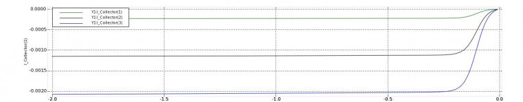

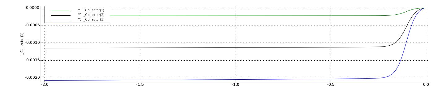

KSA1220AY
Family of curves and gain curves. The gain curves from bottom to top are -0.4V, -2V, -4V.
At -4V Vce, this transistor is nicely liner and would make a nice gain device.
