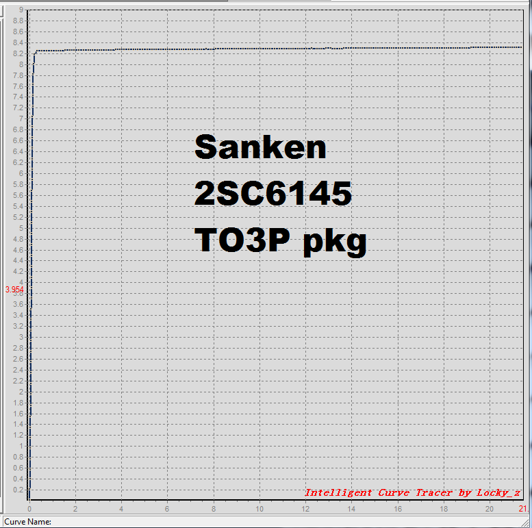

Hi Bob, please look at the plot again. The measured Ice vs Vce curve is ruler flat. That means very little Early effect. Here are the numerical values which I measured on my curve tracer.
2SC6145: Vearly = 1650 , Beta = 80 , product = 130K
2SC3503: Vearly = 560 , Beta = 200 , product = 110K
BTW the "champion" NPN for Beta*Vearly was the (discontinued) Toshiba 2SC5171. It had Vearly=1600 and Beta=180 for a product of 288K. A factor of 2.6 higher than the '3503. I know you don't mind using discontinued parts if they're really excellent, for example the 2SC3503.

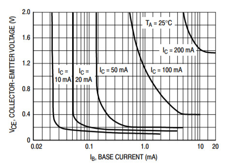

Hi Mark,
Can you confirm manufacturer brand of test result as your post #15 about BC547, here is your result: Its looks into quasi saturation.
On ON-semi BC547 datasheet i see it does not look too bad. On other hands, BC547B together 2SC1815, BC337 all they are usually used in industry as relays/contacts driver. If they too bad, they're will not used by designer due this thing cause efficiency decreasing.

Quasi saturation doesn't means, that the device is not working as switching bjt. Just just need to push more base current to reach the lower Vcesat. Of course there some more apropriate device for that.
BC547 can switch 100mA collector current with 0.8V Vcesat, if You apply 1mA base current. BC337 do the same with 0.5mA base current, or BC337 will reach 0.15Vcesat with 1mA base current.
Sajti

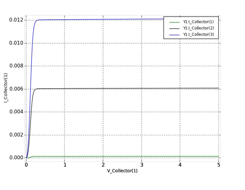

Hi Sajti,
I means that BC547 can pass 10mA even 20mA Ic/1V Vce with no sign of quasi saturation.
With higher levels the quasi-sat is clearly as graphs line shows.
I would say 20mA/1V is a bit optimistic, but 10mA/1V is fine. My opinion based on the left graph. The right graph satisfy your point of view.
