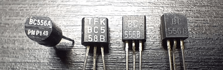

The curve of the silver face looks good. I hope the complement is also good. I'm going to get 546B/556B from NXP, made in china, I'm hoping they are as good as the ones you've measured. There could be a difference between older Philips ones and NXP, does yours look like the attached one? @stormsonicTwo BC550C transistors from different manufacturers. First one with black faceplate and the second with silver colored faceplate.
Thanks,
Alex
Thanks.
