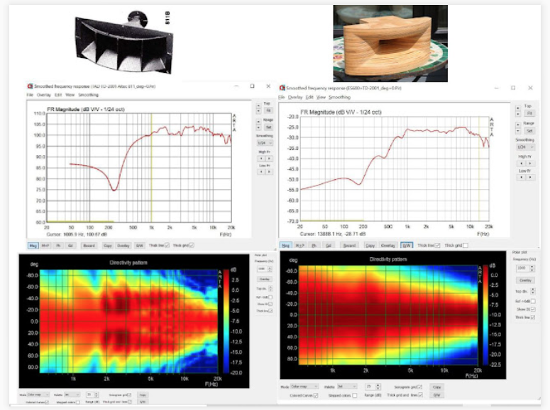

Please describe these benefits.
Soft termination or rolled back mouth edges reduce edge diffraction.
As Joseph Crowe puts it:
"severe edge diffraction effects the off-axis consistency as well as all time domain aspects (step response, burst decay) which would result in a blurring of transient detail across it's bandwidth."
It is easy to see those effects in a comparison of a horn with severe edge diffraction to a smoother edge bi-radial similar to the one you linked:
https://croweaudio.blogspot.com/2020/05/altec-811b-with-tad-td-2001.html
Would they also be equally realized via rolled back mouth edges, like those in this horn?
Since the rolled back mouth already mitigates diffraction effects, a soft termination using damping material like terry cloth, foam or felt would make little difference.
