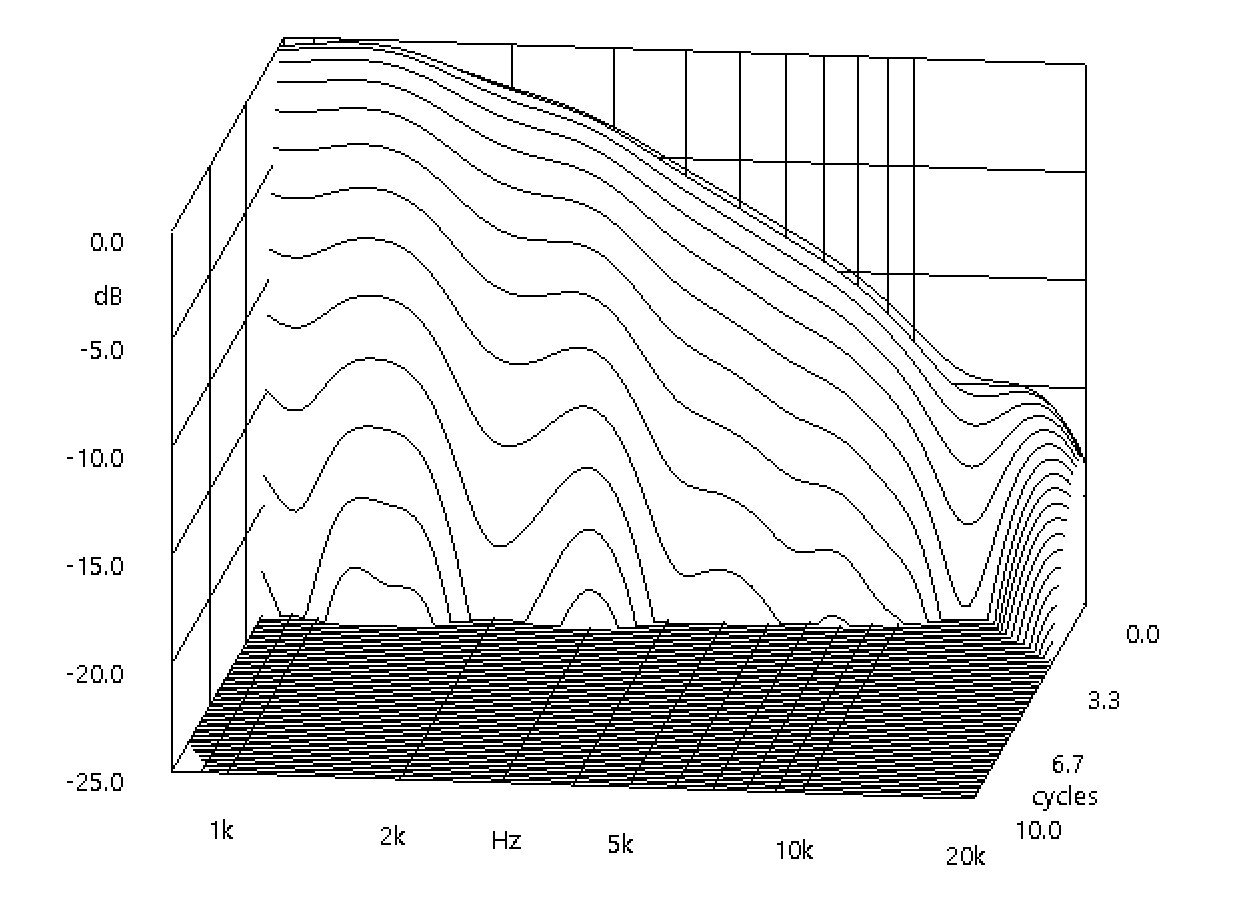

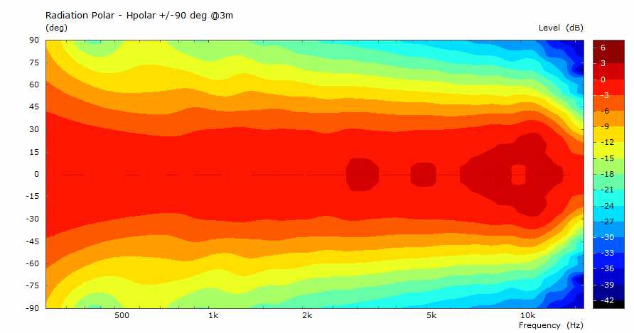

Here is one of the variants without fins:
Now you need a very detailed understanding what the fins change wrt this polar. This example is an almost perfect behavior before adding the fins.

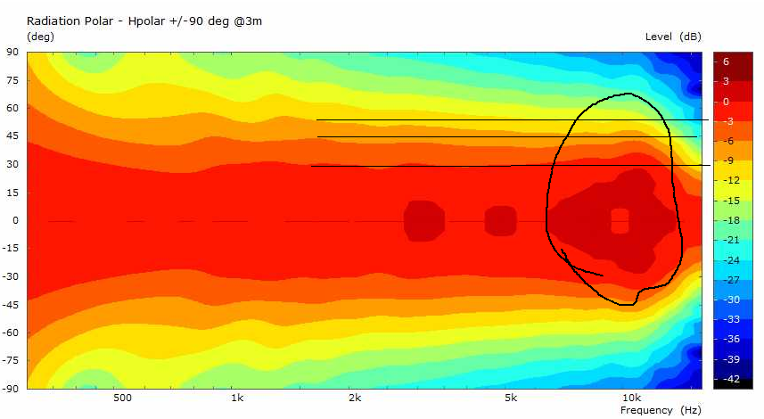

Strange the kind of diffraction after 6kHz but this is that allow to be constant upper apparently.
About this and constant aspect at -3/-6/-12 dB, I don't said that it need to be constant at -12dB at all but -3dB is very important to be clean and regular as it's generally this that early reflection will sent to the listener in a room (sides walls).
The diffraction can be avoid in all design but may be it's due to 2" throat, if it's a 2" throat horn, I don't know.
The aspect "partially hyper constant" can be only found with fins, but again I don't said it's better or whatever, I use both with and without fins horns, I haven't any religion about it but all my designs are free of diffraction by nature 😀.

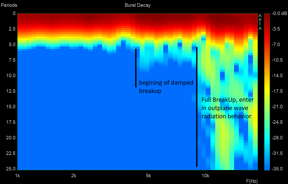

For the JBL 2450SL aquaplus (that is "aquaplus" the blue treatment ? I don't remember what is after the "aqua"), I have the same driver :
It still a good compression driver, I have it too and appreciate it but the breakup begin seriously at 9khz and show sign at 5kHz.
It's why she begin to act a little bit on herself after 9khz in a horn (like "shaking"), if we compare to others one, the plane wave radiation is not more plane wave.
This was pre-optimization step before adding the fins as I wrote so putting lines here to show anything is meaningless.Strange the kind of diffraction after 6kHz but this is that allow to be constant upper apparently.

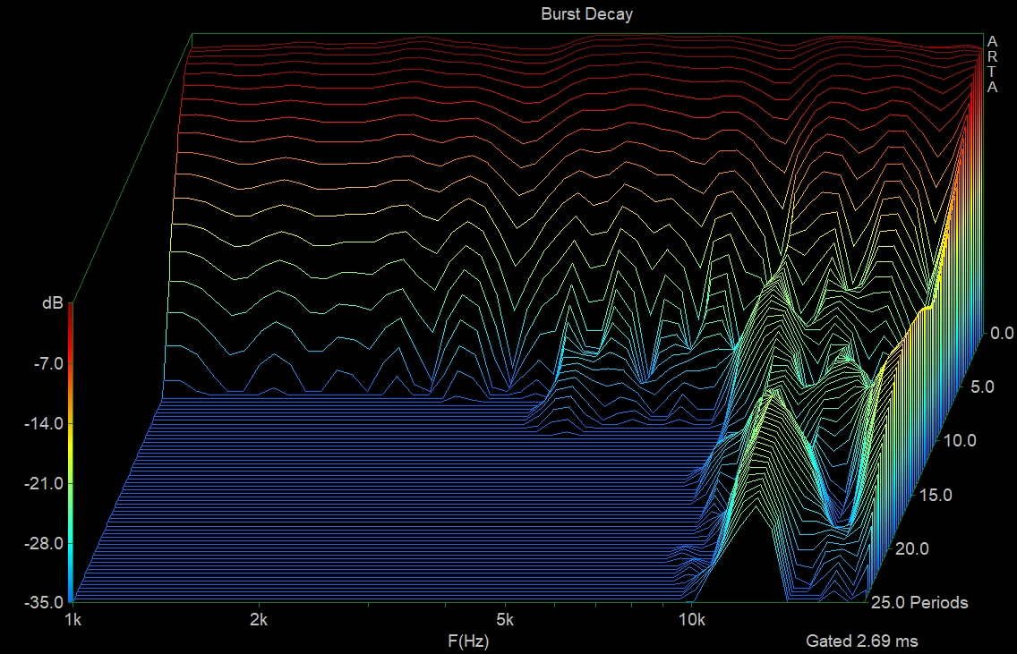

yes a dark blue, I have the same, well in your burst the breakup is hidden, outside scale, look :
I thinks you can see it with your horn, put your mic at 0cm of the mouth and EQ the driver flat until 20kHz, then you will see the same basically 👍

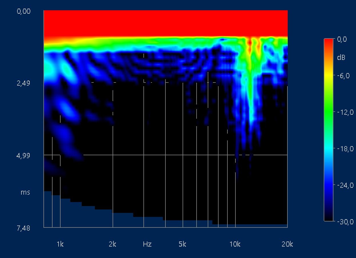

Actually, when comparing my Altec 416 to what presumably is a very similar 15” ElectroVoice woofer (see attached T/S parameters if this helps), Weltersys seems to predict that it will be free of beaming as high as 1kHz, yielding 90 degrees coverage; see posts # 185, 205. Thanks to Weltersys for this comparison.
So while Troy Crowe’s measurements do site 500Hz as ideal, that range in between does not appear problematic.
Nice view, could you measure EQ flat until 20kHz at high volume and not just selected "relative" ?This is all I get out of this SW:
This is an excellent sounding driver. If there are any break-up modes, they do not harm imo.
As if you use only relative alone a part of the information have disappear in the room's noise, as the driver goes down in HF naturally, thanks 😀.
Yes after 10k it not harm, I like this driver to of course.
