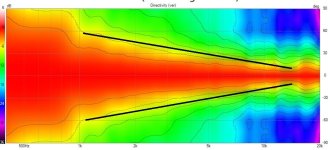

The website now includes the vertical polar response data for the 48cm horn. While we don't currently have the vertical data for the 54cm version, the 48cm data can provide a good starting point.
You can find more information and the 48cm vertical polar data here: https://audiohorn.net/next-gen-bi-radial-horn/
Of course if you need to cross low, choose 60cm version.

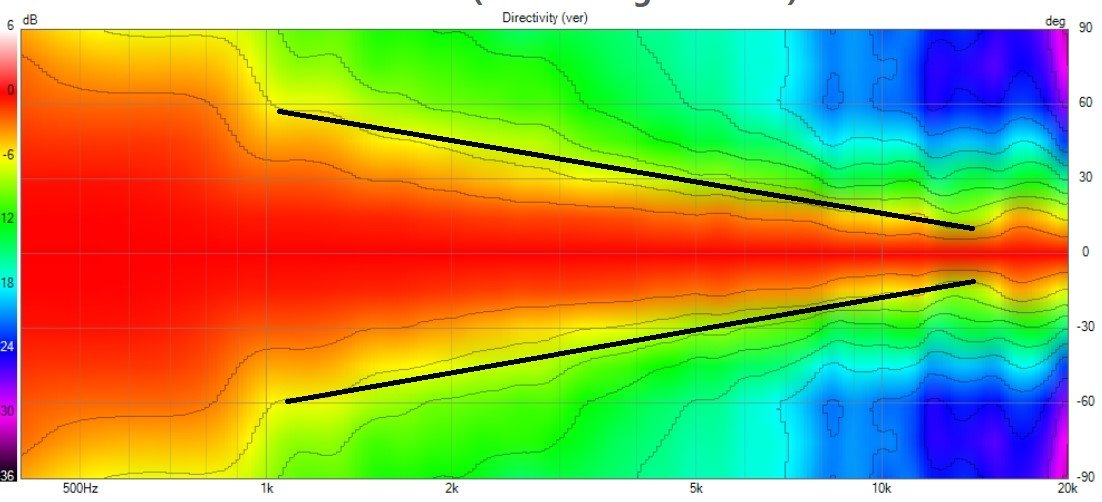

As I already expected, imo a beaming device for the vertical. It looks as if you have sacrificed vertical dispersion in favor of horizontal dispersion. It is not constant directivitity anymore for the vertical. Wrt designing such radial like horns, it is all about to get the vertical right and one single profile does not work. For me, 90% of optimization is for the vertical. And a plain radial profile is not able to provide better controlled dispersion.

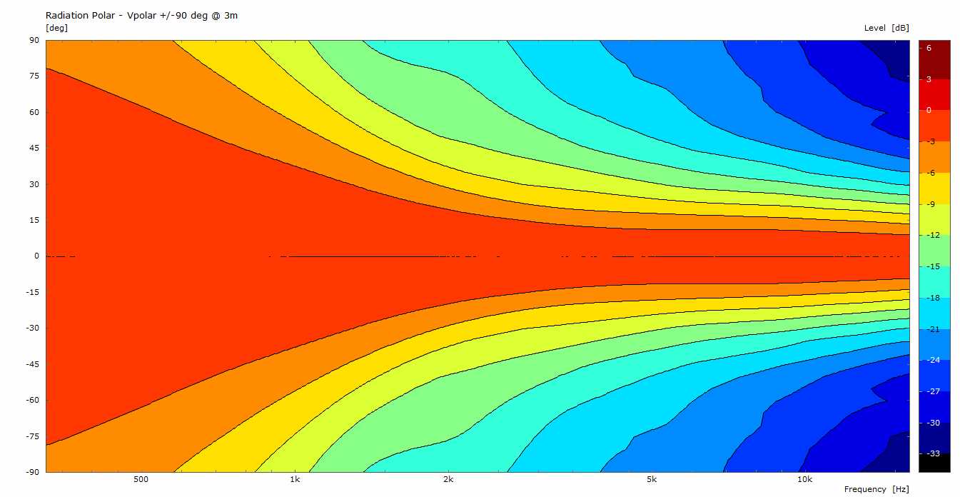

What I prefer is a knee-less behavior and almost constant in the upper octaves like for my radial fin-less designs:
With an outer profile added, this figure would even look better.

What ?! I sacrificed nothing and there is no device "beaming" on vertical, it's the normal vertical behavior of biradial in vertical, show real measurement of yours instead of BEM sims... I have even more coverage of yours sims at 5khz, Your are at 40° when I'm in 50°... I offer more opening vertically.
Your beam doesn't take in account the how the driver behave when the wavelength is shorter that the throat size, is comparing orange and apple...
You make speculation on simple BEM simulation... your vertical sims will NOT behave like this in real measurement, it's acoustics basics...

imo this is a typical example of a beaming device.
Beaming of what ? It's not constant vertically as all biradial in real life... it's just profile then natural directivity of the compression driver itself, without midrange beaming or narrowing...
If this is not beaming, what else is? 😀 🤔

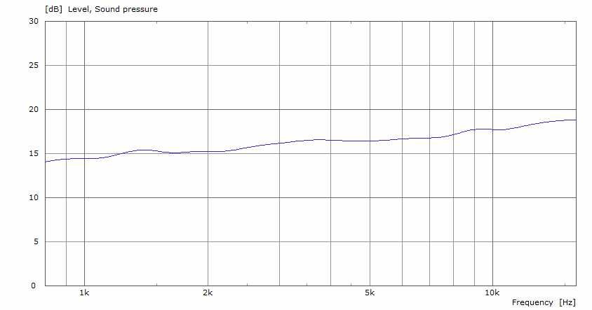

I have no problem to show my design study of my radial like horn with full acoustic loading down to 400Hz.
For such asymmetric device the vertical show always a faster rising DI, but I think it is ok and it should be fairly linear. Keele showed more than a half century ago how to further improve the vertical, but the horn then will become very long.
hrz DI90:

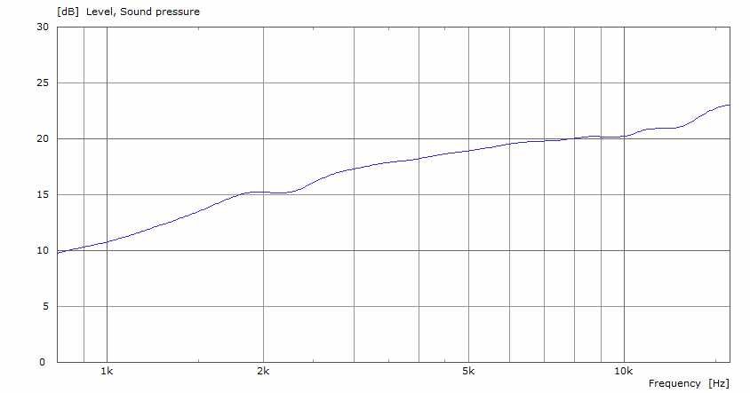

vrt DI90:

The problem with this is that both the pictures are inaccurate. I guess the real DI will be somewhat closer to the vertical, but someone would have to do the actual data gathering and processing. Definitely it's not just an average of those two.

Beaming is for long associated with the notion of a steeply rising DI with frequency. That's really what "beaming" is.
How "steeply"? Nobody knows for sure 🙂 I would call the vertical DI above pretty beamy.
