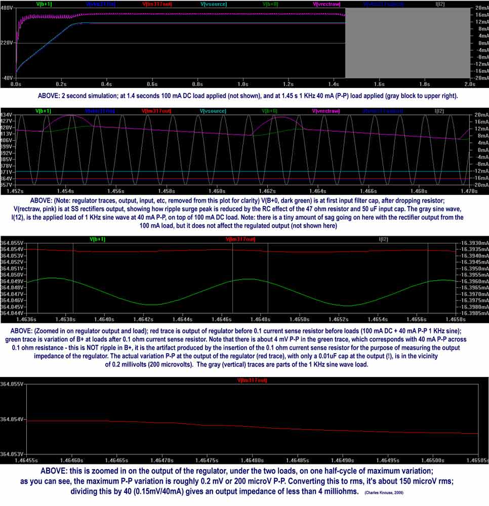

radianceaudio said:I got, for the Maida, about 20 milliohms. That was at 365 Vreg, 100 mA DC load, 20 mA sine load at 1 KHz.
As I remember, the Swenson measured out somewhere in the 100 milliohm range.
I think your wrong here - the Swenson reg gives 0.099ohm or lets round it up and say 0.1ohm i.e about 200 times better than the Maida!

Actually, the output impedance of the Maida, after my mods to it last night, is even lower. It calculates to about 4 milliohms, as opposed to the Swenson at 100 milliohms.
Having said that, I would of course add the caveats:
1. It's a simulation with LTspice; I think it's reasonably accurate, but the real-life application, which I'm working on now, will tell the tale.
2. The difference between 4 milliohms and 100 milliohms is inconsequential; either regulator should work fine, and the Swenson is easier to protect against short circuit. Personally, I would use a much heavier-current-capable mosfet for Q2, without a plastic case, and heat-sink it with a fan-cooled-heat-sink, but everyone has their personal preferences.😉
3. I haven't incorporated the short-circuit protection into the Maida yet, but working on it. My circuit, as it is now, will most assuredly blow up the lm317 in a dead short.😀
4. Both the Maida and the Swenson require some sort of soft start - tube rectifier with RC or CRC or RCRC, etc., or 20K resistor to the center-tap, shorted by a relay of mosfet after a delay. And, for tube amps, of course, both need a delayed B+1 if using SS rectifiers.
Note to Chrish: for a first amp, keep it simple, and don't kill yourself. I'd use Duncan, go CLC or LC depending on your transformer and desired B+1 (my own peculiar designation for the positive voltage applied to the output stage, after filtering...🙄 ), and go easy on the H; most designers, I think, when using a CLC or LC filter, prefer a touch of ripple to slowing down the music (musical transients, that is) too much. Other members here can better give you advice on how much ripple might be tolerable; a lot depends on whether your amp is Single Ended or Push-Pull; in Push-Pull, you can have a lot of ripple on B+1 and not hear it by balancing the ripple across both halves of each Push-Pull output pair, thus zeroing out the ripple. This is what they did in the old days; the old Heathkit AA-151 is a prime example - that amp in the original has the rectified output of the tube rectifier 5AR4 going directly to a 50uF capacitor AND directly to the center-tap of the output transformer; ripple is horrendous, but by using a balancing pot, most of it can be eliminated (not a good design, don't get me wrong, but just an example). If you want to add a Maida later, I'll be happy to dimension it for you, but it's not an easy build for a first amp.🙁 Having come very close to killing myself in the first year that I started messing about with tube amps again, uh...more than once, after a hiatus of forty years, it's so easy to make mistakes, lemme tell you.
