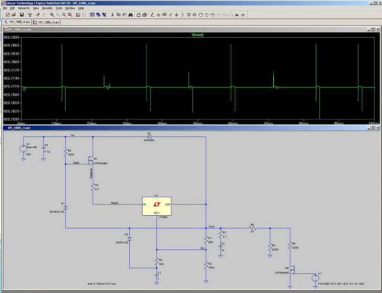

There is an error in the shcematic diagram in the "HEFFA" regulator pointed to in the previous post. The Gate and the Drain leads on the mosfet are reversed. The soft start feature in this design will guarantee that the LM317 will have a short unhappy life in an overload situation. The long time constant at the mosfets gate will cause a slow decay in the mosfets source voltage causing the LM317 to be subjected to more than its rated voltage. Yep I blew up a few.
I have been experimenting with a MegaMaida regulator. The simulations are very good, but it will still blow up if I put a screwdriver across the output while it is running. It will survive a short at turn on. The simulation below shows the output ripple while the load is switching between 100 mA and 200 mA at 420 volts. All of the components on the right of Vout are for simulation purposes and are not part of the regulator.
Looks great Tubelab! Are you going to design a PC board for it?. Also, what transformer (voltage/current rating) were you using during these simulations?
This simulation was done using a DC source of 500 volts with a DC resistance of 100 ohms. I ran several simulations at different voltages, currents, source impedances, and load conditions. I also tried several variations of the circuit. All were derived from the Maida design on National web site. This one shows a Linear Technology regulator chip because LT spice doesn't give you models for their competitors chips. The simulations are all buried deep inside my old computer. I just haven't had the time to copy all of it to the new one.
I built a breadboard version on perf board last year. I ran it with a monster Antek toroid that was something like 800 volts center tapped at 1/2 amp. I used a big IR fet (don't remember the #) and a NJR 317 type regulator because it comes in an insulated package. I connected the whole power supply up to a SimpleSE amp and it sounded nice. I didn't have much time for testing, but I did manage to blow the circuit up by shorting it out while it was running.
I had planned to do a PC board, but too many things have gone wrong this year. I did a test board that contained one of these power supplies, a universal PowerDrive circuit, and a few other experiments in December. It has been sitting on my workbench untouched since then. It will be at least 2 more weeks before I can get to work on any electronics. I must finish my taxes, my mom's taxes, the corporate taxes, and the corporate annual reports first.
tubelab.com said:I must finish my taxes, my mom's taxes, the corporate taxes, and the corporate annual reports first.
Well that should take all of 4 hours 🙂
If you have the bode-cad module for LTSpice consider inserting an a.c. source into the error circuit and calculate the impedance plot.
