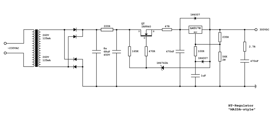

This is my HV power system£¬ It is long time good work¡£
Heat power use LT1084 .

Hi sjh327,
Nice neat layout.
My only concern are the capacitors so close to the heat sinks. How hot is the area where the capacitors are in after running for a couple hours?

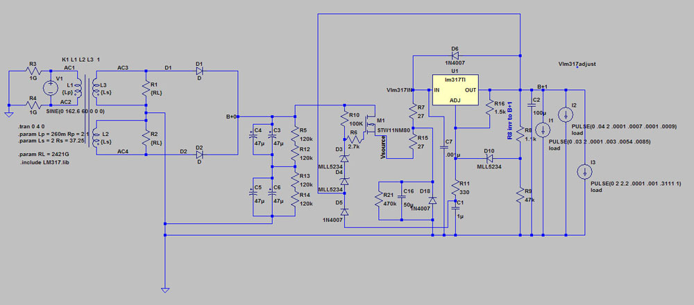

Tubelab, et al,
the circuit below, in LTspice, shows current through the lm317 limited to under 800 mA in a dead short, with the voltage across the lm317 very low.
This is just a sim, and I do plan to build it now and screwdriver the output and see wha' happens, but I thought I'd post it.
Yeah, I know, it has small current limit resistors and a whopping cap between the current limit resistors before the lm317 input, which is supposed to be a no-no, but with this I get no sag, and virtually no effect on the B+1 output even with pretty complex and heavy loading, easily twice the loading it will actually see in the amp I'm doing.
Nonetheless, at least according to LTspice, the lm317 doesn't blow. Reality may be different😀
I'll try to attach both the image and the zipped schematic file, if anyone wants to run it or play with it; I tried to put all the files needed inside it.
Best, Chas

I decided to find compare the Swenson output impedance as calculated by Gary Pimm with my latest version of the Maida.
I used his same method.
I got, for the Maida, about 20 milliohms. That was at 365 Vreg, 100 mA DC load, 20 mA sine load at 1 KHz.
As I remember, the Swenson measured out somewhere in the 100 milliohm range.
Of course, without a tube rectifier, with the Maida a 20K resistor does have to be inserted to give it soft start (shorted by a relay or mosfet at the end of the delay period) and a delay circuit added, and perhaps short protection...
But it certainly measures even better than the Swenson, using the same method. And that, by the way, was with only a .01uF output cap; normally I would use a 100uF cap on the output. And, for what it's worth, probably not very much here, it would be easy to make the Maida into a "variable sag" power supply for a guitar amp, which I plan on doing, just for the fun of it.
So, count me out for PCB's, I like tweaking this circuit better, and I greatly prefer circuits well in the public domain, avoids hassles.
But thanks for the info and link, it's always good to see other approaches.
Best, Charlie
