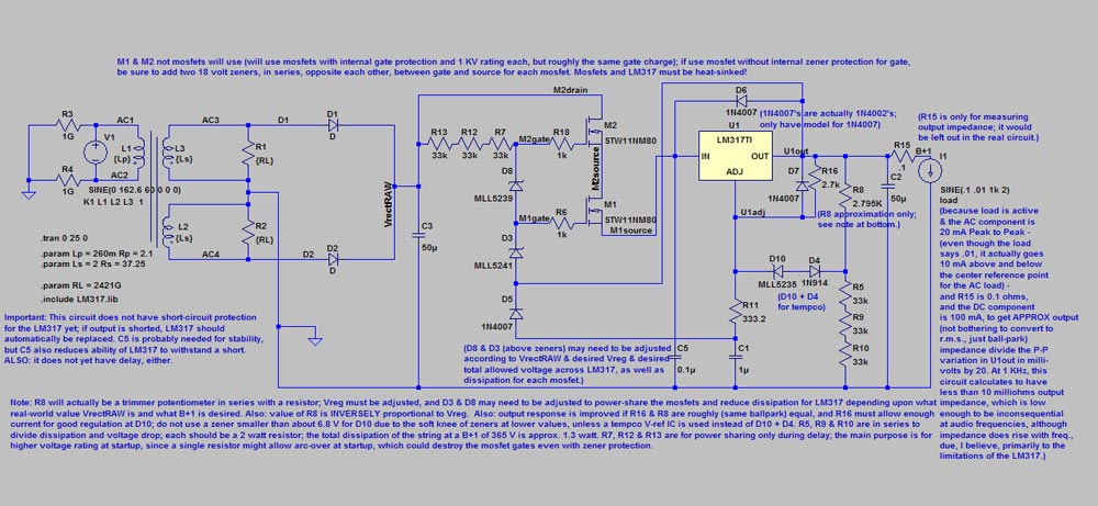

I just realized the main limitation of the Maida using an LM317...output impedance rises rather badly with increased frequency. Doh!! 🙄
So, while it does achieve less than 10 milliohms at 1 KHz, at 20 KHz the output impedance rises into the many hundreds of milliohms...not good.
I still like the basic topology of the Maida, however, it's just the LM317 portion needs to be replaced with the equivalent of a Jung super regulator...which I'm working on.

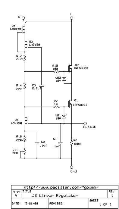

Here's the graph from gary's site for this regulator & his comments:
I think he has further improved the impedance curve to reduce the rise at LF - it is now flat from LF to 20KHz AFAIR
Edit: I meant to ask Disco if he got his LND150s & other mosfets yet & has he built the board up yet? Any results?
You can see that the output impedance (Z) of the circuit with current limit (red trace) (.142 ohms output Z) fits between the green trace where the 2 ohm resistor is shorted out (.099 ohms output Z) and the black trace where a .1 ohm resistor is added (~.2 ohms output Z).
Over all, this looks like a darn nice regulator. The output impedance is quite low without using large capacitors and the ripple rejection is suburb.

Well, that was interesting. Keep in mind this is just a simulation, and all I'm doing is reporting, not making any judgements.
I went ahead and modeled the Pimm/Swenson regulator in LTspice, but redimensioned it (only the bottom resistance) for 360 volts out.
I was very surprised that when I put the same load on it that I've been using with the Maida, the SIM results were considerably worse.
Much more ripple and much higher impedance, and at higher frequencies the impedance rose faster than the Maida.
Now, this is just simulation. But the blasted sim did cause me several days of grief, as I worked to lower the output impedance of the Maida at higher frequencies. But it's a lesson to go ahead and build once the fundamental issues are worked out - I don't think spice is for trying to get it to the nth degree - and then take real-world measurements. I suspect the results will be different - as the results for the Pimm/Swenson might well be very different from the sim, and considerably better than the sim predicts.
Anyway, I'm a little more hopeful now for the Maida; we'll see.

Thanks. Yeah, that was my point, I guess I wasn't clear enough.
My hope is that since the sim showed the Swenson doing so badly, erroneously since Gary P's real-world measurements were far better, the real-world performance of the tweaked Maida might be considerably better than what the sim showed. I hope. We'll see.
Or LTspice is just good for working out the fundamentals, but doesn't predict reality when you get down to trying to calculate milliohms of output impedance and high frequency noise rejection, etc. Seems I remember Bob Pease saying a few choice words on that subject....😎
I'm reluctant to give up the Maida topology, because it has some features I like, I think it can be made bullet-proof (but not with any sizable cap at the LM317 input!), I also think there's some decent possibilies for replacing the LM317 with a better reg or even a superior discrete circuit, and it's solidly public domain. Whether Gary P really has any intellectual property rights to the Pimm/Swenson, and whether I am obligated to pay him/them a royalty if I use it to upgrade an old amp for profit (well, not really - it's more like slave labor 🙄 ) I don't know, and it makes my head hurt to think about it.
Just to be clear about this, for anybody, I am not interested in a flame war over Gary P's intellectual property rights; I think he and Mr. Swenson are top-notch designers - real engineers, not an old hack like me - and I'm grateful that he's made his work available, and if I had disposable income I would happily buy any PCB's or kits he wished to sell. If I was rich, I'd send him a monthly royalty payment for no reason other than to encourage him to continue his superb work.
So, if I can make the Maida work decently, all to the better, just more meat for the stew.
Just for chuckles I attached the latest version of the Maida; it still doesn't have short-circuit protection, but I have found that there are numerous ways to take the mosfet gates to ground (or to other nodes later in the circuit) which protect the LM317 very quickly against both over-voltage and over-current in a short, so I'm optomistic.😀
Just, please, nobody dream up a protection circuit and then post it here with a copyright...that I WILL ignore.

Hi,jkeny said:I meant to ask Disco if he got his LND150s & other mosfets yet & has he built the board up yet? Any results?
Considering the purposes I use the regulator for, I descided to go back to the original design of J Swenson as posted on Audio Asylum. Re-reading Garys article I came to understand two parts were optimized: the resistor on top of Q5 and the value of the output cap. He also increased the value of the noise cancelling cap on the voltage reference. After that point the circuit was altered because of Garys need for a short circuit proof version and further optimizations were for that circuit only.
Yes, I've received the Mouser order faster than I believed possible 🙂 A first print was made but when I changed some resistors it showed the wires and pads of the PCB were too small and broke off. So I developed another, simpler version for the original SwensonReg exactly to fit the parts I had at hand and it works like a dream.
Right now I'm listening to a small (3W) tube amp which is powered by the new reg. The sonic impact on low frequencies is very good as bass notes sustain without sounding 'hollow' as I was used to. This hints on a very low impedance power supply. For voices and high frequencies I'm not impressed and I suspect the amp is suffering from oscillation. It might be caused by coupling because the PCB and the tube are mounted close together, or because of bad wire layout, or because of the sand I used in the recitication.
The input voltage is 350Vdc (0,3V ripple), current is 30mA, output voltage is 275V. There's no need for a heatsink on Q1, Q2 needs only a small one. Output voltage for this small load is rock steady and is maintained while Vin-Vout > 25 volt. Very good indeed!

Indeed, that's the circuit. I've raised the output voltage to 275V by increasing the resistance of the voltage reference (R10 and R11 in Garys drawing) to circa 800K and also my load differs from his situation.
Gary writes:
1) Increasing the output cap to 470nF took care of occasional instabilities.
2) Increasing C2 to 10uF increased ripple rejection at 120Hz down to 120dB.
3) Increasing R14 to 56K increases the load on Q5 for higher gain for error correction and it increases the voltage across Q1 improving its operating point.
As some parts I used in the amp were rather old I should give it some time to brake in. But high and mid are not as clean as with this tube regulator Nice bass and dynamics right now 🙂

I believe GP said that at least 50V drop is needed across the Vreg (100dB PSRR) but 100V is better (120DB PSRR)

Some of the indications that GP has said is that the reg works best with a voltage drop of about 100V (certainly >50V) due to the capacitance of the mosfets reducing at higher Vs.
Ah, that explains my results in the sim with a rather smaller voltage drop using the Pimm/Swenson. I suspected the capacitive transfer of the mosfets was the problem.
So, the Maida is actually the better choice, so far I believe, for situations where a much smaller voltage drop is needed, because the LM317 interposes between the capacitive transfer of the voltage-protecting mosfets and the output. The Pimm/Swenson regulator can undoubtedly be optimized for this purpose, I suppose, but I would rather optimize the Maida by replacing the LM317 with discrete components.
In any case, the Maida at 1 KHz now has neglible output impedance, and I'll find out if the rise in high frequency impedance as predicted by the sim makes a difference in real application.
For what it's worth, I did sim up several versions of the Jung super reg as the last stage in the Maida, and for my purposes, moderately high B+ and moderately high current demand, the super reg did not perform as well as the lowly LM317 as the output stage of the Maida; perhaps a super reg topology for the output with discrete components rather than an op amp might perform much better. Another option is a floating "capacitance multiplier" output, but all these options are a bit problematic at high voltage - at least for short circuit protection and possibly excessive voltage differentials during startup - unless they're wrapped into the same loop as the LM317 is.
