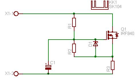

That schematic has the following values:
R1, R2 330kOhm
C1 4.7uF
D1 ZD15
R3 33Ohm
Q1 IRF840
The formula for calculating the inductance is:
Value in Henries is approximately R1 x R3 X C1
That is 330K x 33 x 4u7 = 50H
I say approximately because this assumes that the gain from gate to source is exactly = 1 and in practice it will be a bit less than 1
Link here: http://www.loetstelle.net/projekte/gyrator/gyrator.php

A note of caution:
I suggest caution in using a gyrator as the 1st element in a PSU filter. There is a substantial forward drop in the circuitry, as the power to operate the FET has to come from someplace. The comment about not being able to swing above the DC value may be relevant too. Remember, the 1st inductor in a choke I/P filtered PSU operates under rather severe AC conditions.
I think the best use of a gyrator is probably in a Π section filter. The value of the I/P cap can be kept relatively small, which reduces "hash" and power trafo heating.
Lacking the 840 I used an IRF820 instead. Boy, this thing resonates at startup. Radio reception in the next room was severely influenced 🙁 If you like another 'trick choke' see http://www.antiquewireless.org/otb/resto0504.htm but for me it's opposite to what a filter should do: removing HF noise and ripple.
