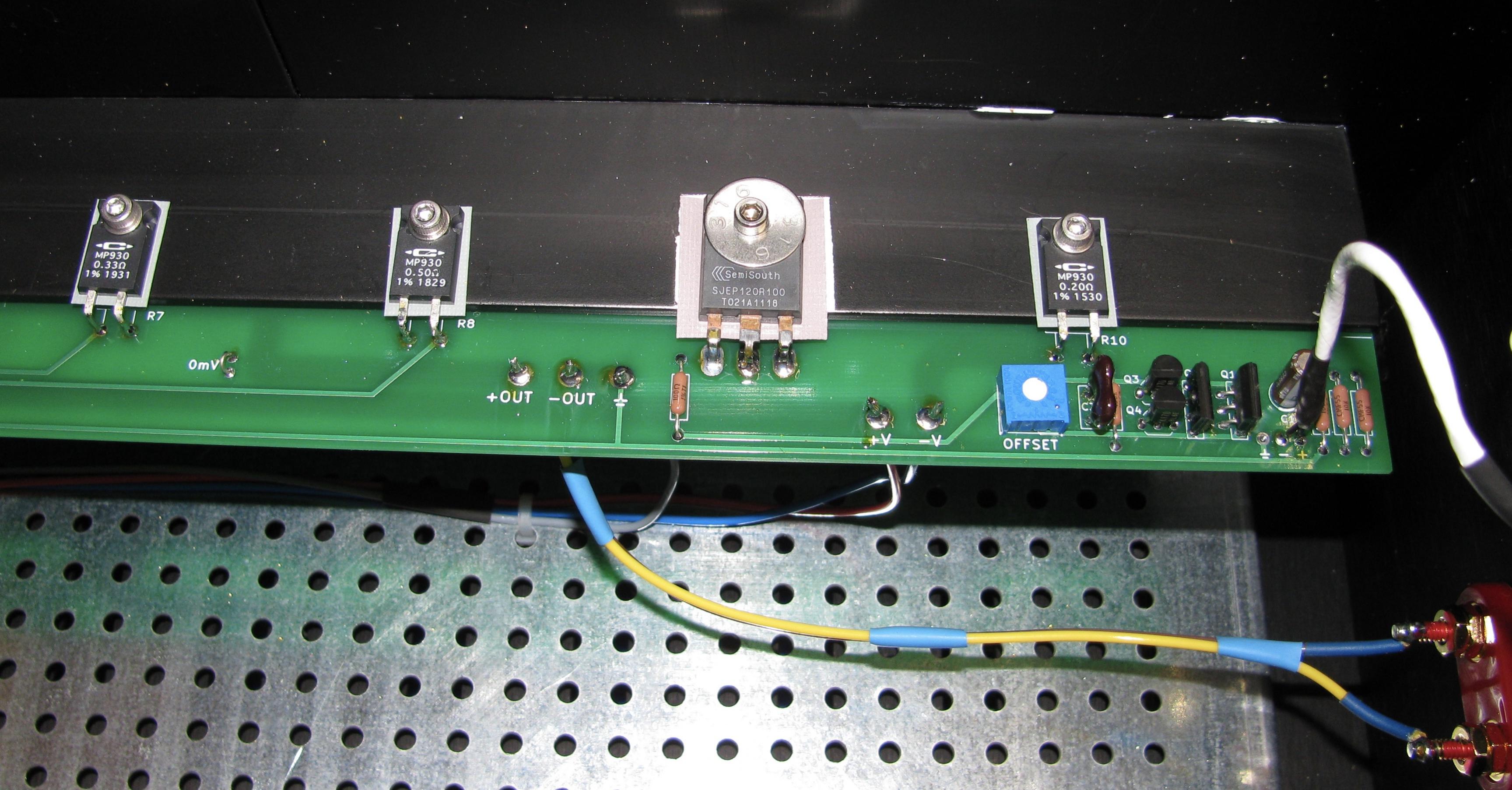

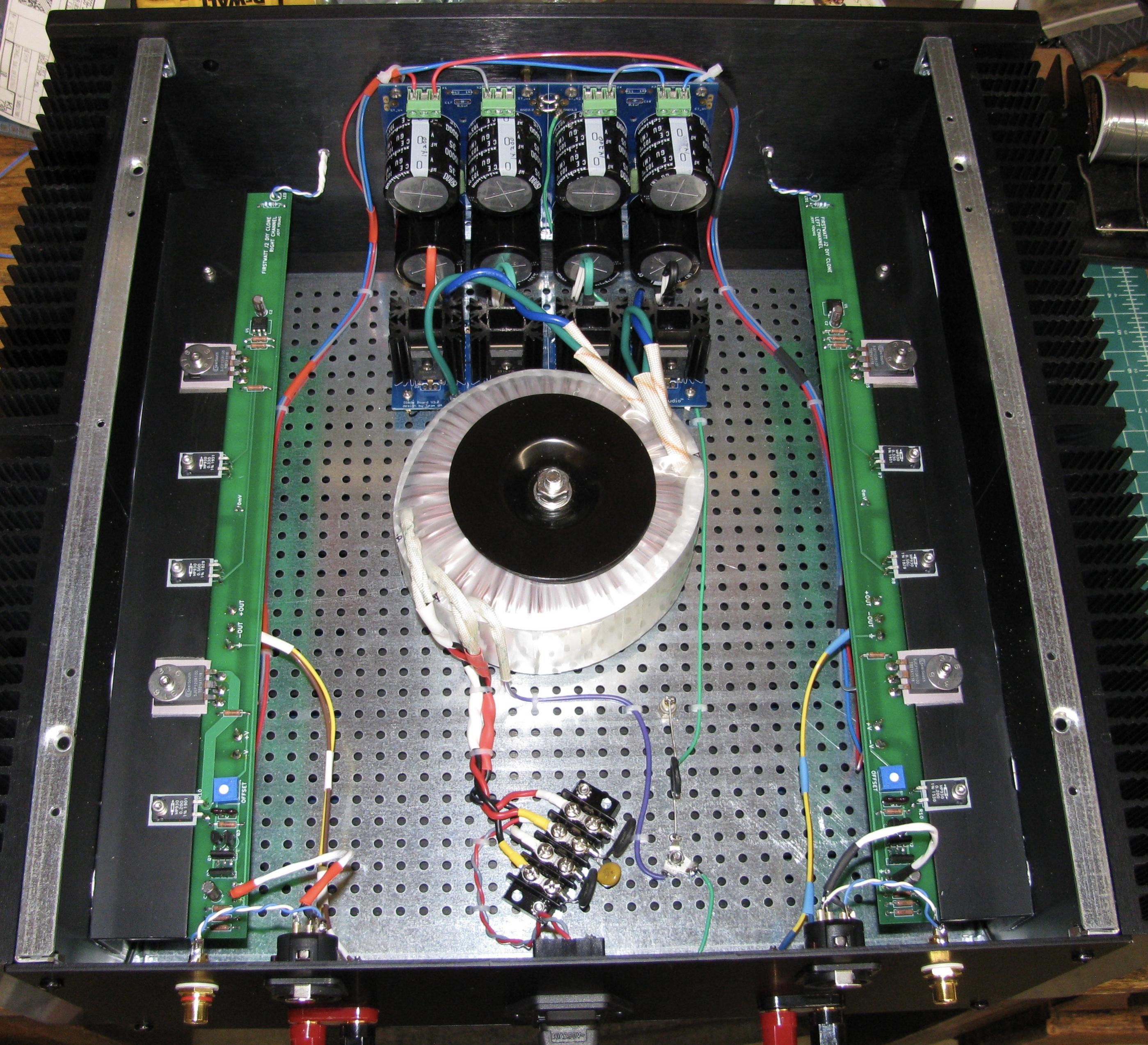

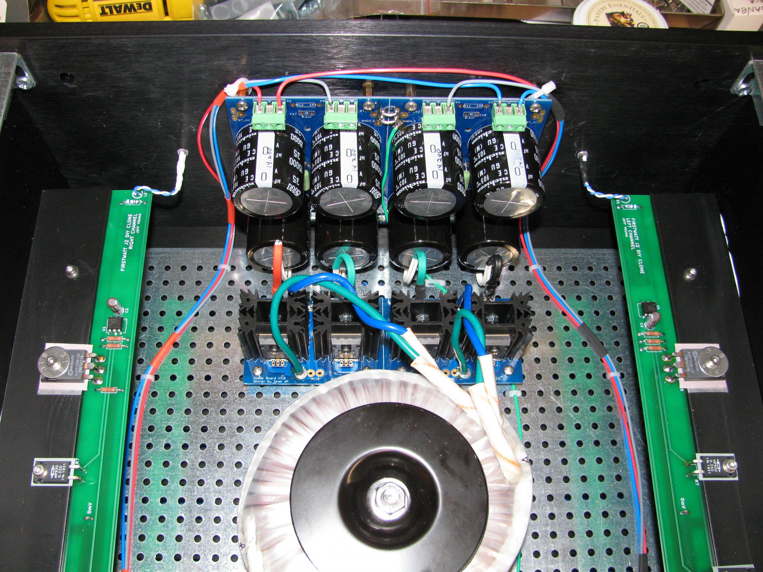

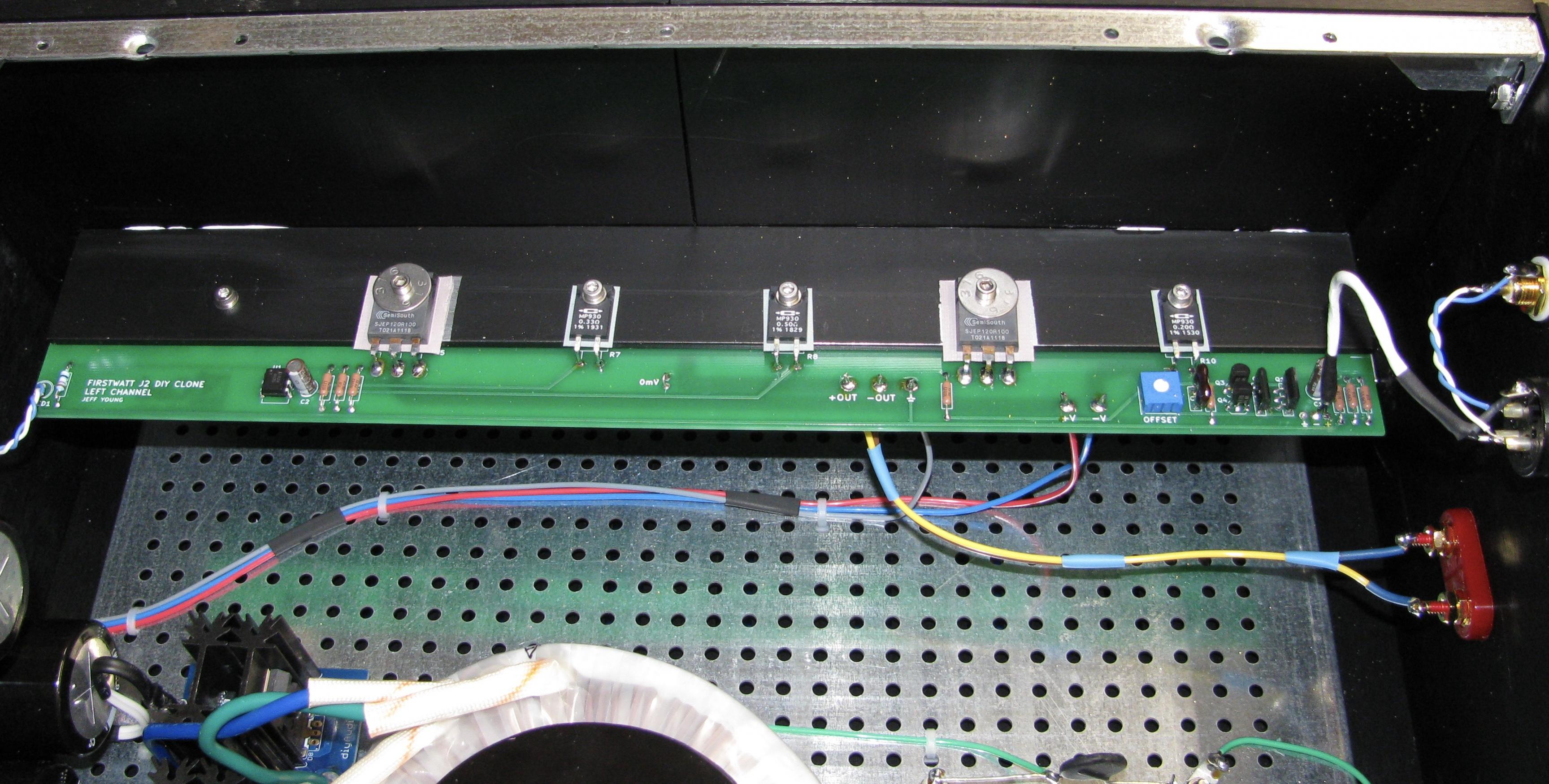

I got my Long and Skinny J2 Clone build working today. My boards are from the recent North America group buy.
I used the 400mm 4U Dissipante chassis and added a horizontal angle to each channel's heatsink.
With a 400VA Antek transformer it runs about 22.1 VDC rails.
Bias is settling in at about 1.425 Amps. Very easy to establish and hold offset at 0-1 mA.
I used 30 watt Caddock resistors as they can be secured with 3mm machine screws and have adequate lead length to mount as shown.
Using Keratherm pads for the Semisouth Jfets, in my shop with 19 degree Centigrade ambient temps, the Jfets are running about 53 degree C, nearby heatsink is 47 degrees and fins are at about 39 degrees.
So far, so good, I hope to get it into my system this weekend for some listening tests....
Thanks to all involved in getting these boards developed and available to us plebians.

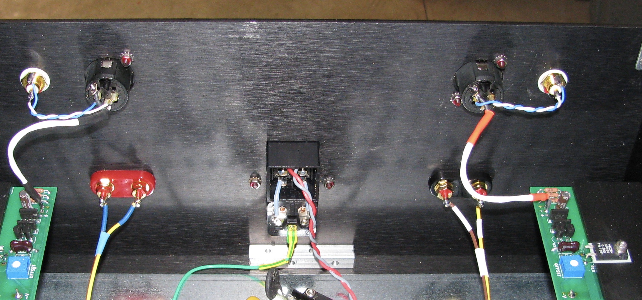

Great idea on the TO-220 Caddocks, Matt! (Much easier than fiddling around with the little brass bars like I did.)

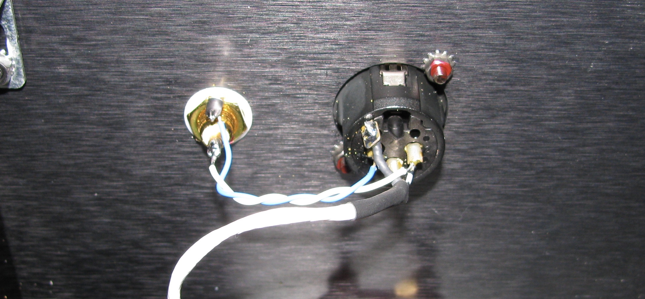

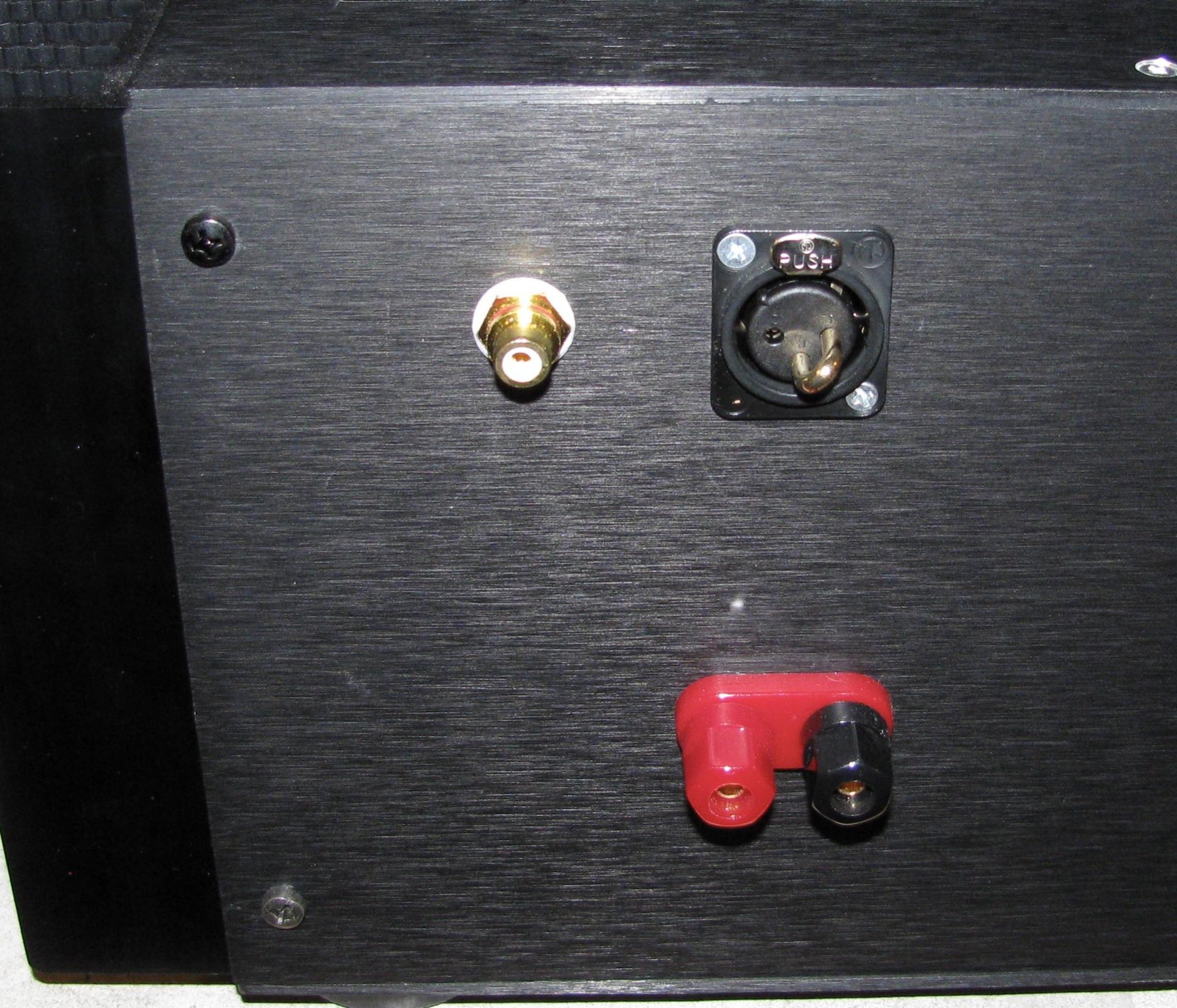

@Matt
Do me a favor and take a good shot of the RCA+XLR connections, I was thinking of going that route as well....
JT
JT
@JT
I just do standard wiring per Pass Labs / FirstWatt
RCA signal to pin 2 on xlr
RCA ground to pin 1 / chassis ground on xlr
When using the rca input, I use Cardas CGSP shorting plugs in the xlr from pin 3 (- negative input) to pin 1 (ground).
Matt

@JT
Matt
Thanks for the photos Matt. 🙂
