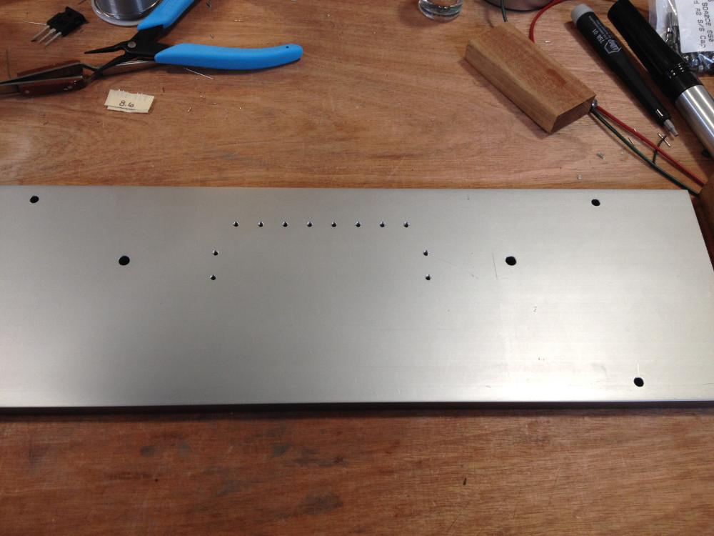

Front plate drilled and tapped for diodes:
787120d1570801516-skinny-builders-thread-progress-diode-bridge-tapping-jpg

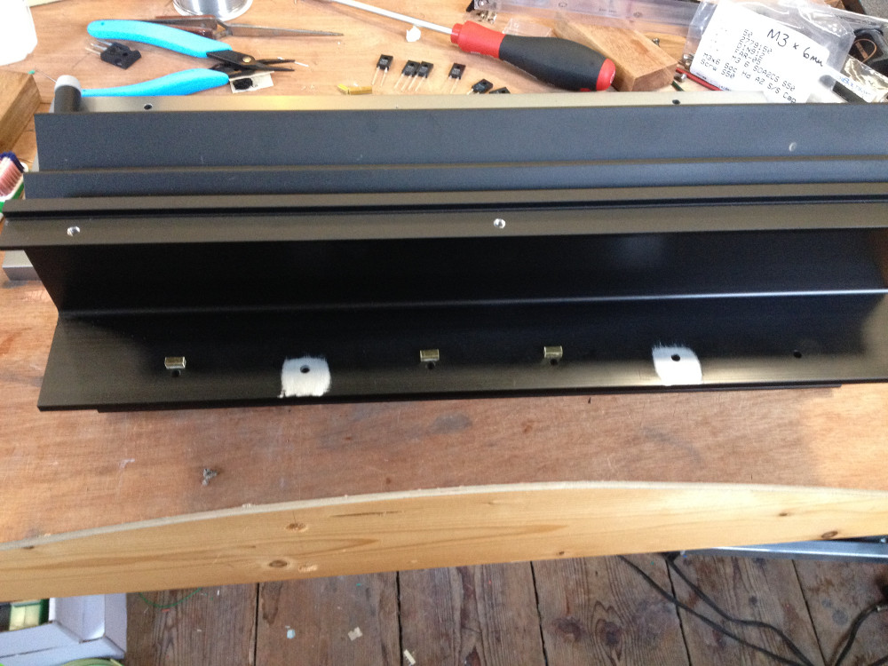

Heatsink prepped (FET footprints polished and brass fulcrums installed for the power resistors):
787121d1570801516-skinny-builders-thread-progress-heatsink-prep-jpg

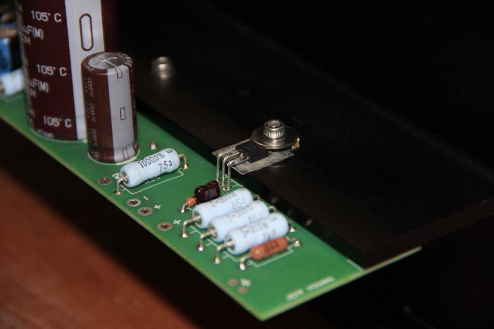

Note that it appears that the Ohmite leads are long enough to mount the resistors directly in the holes, but I used the fulcrum method on my F3 (the Lovoltechs don't have holes at all) so I'm sticking with it.
787122d1570801682-skinny-builders-thread-progress6-jpg

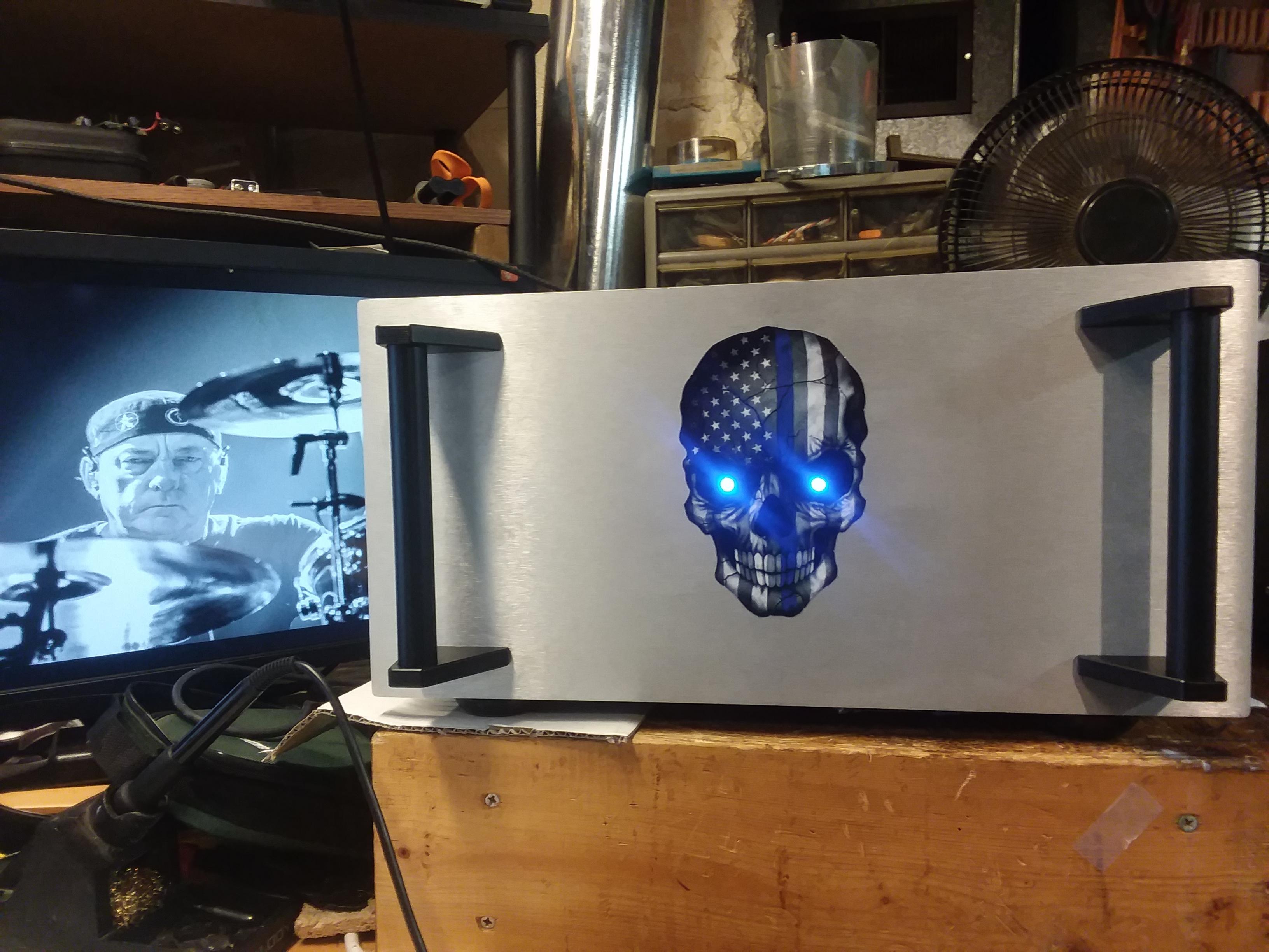

Just put the covers on and the finishing touches. I still have a couple things to do with the face, but I like it fine now too. :)
