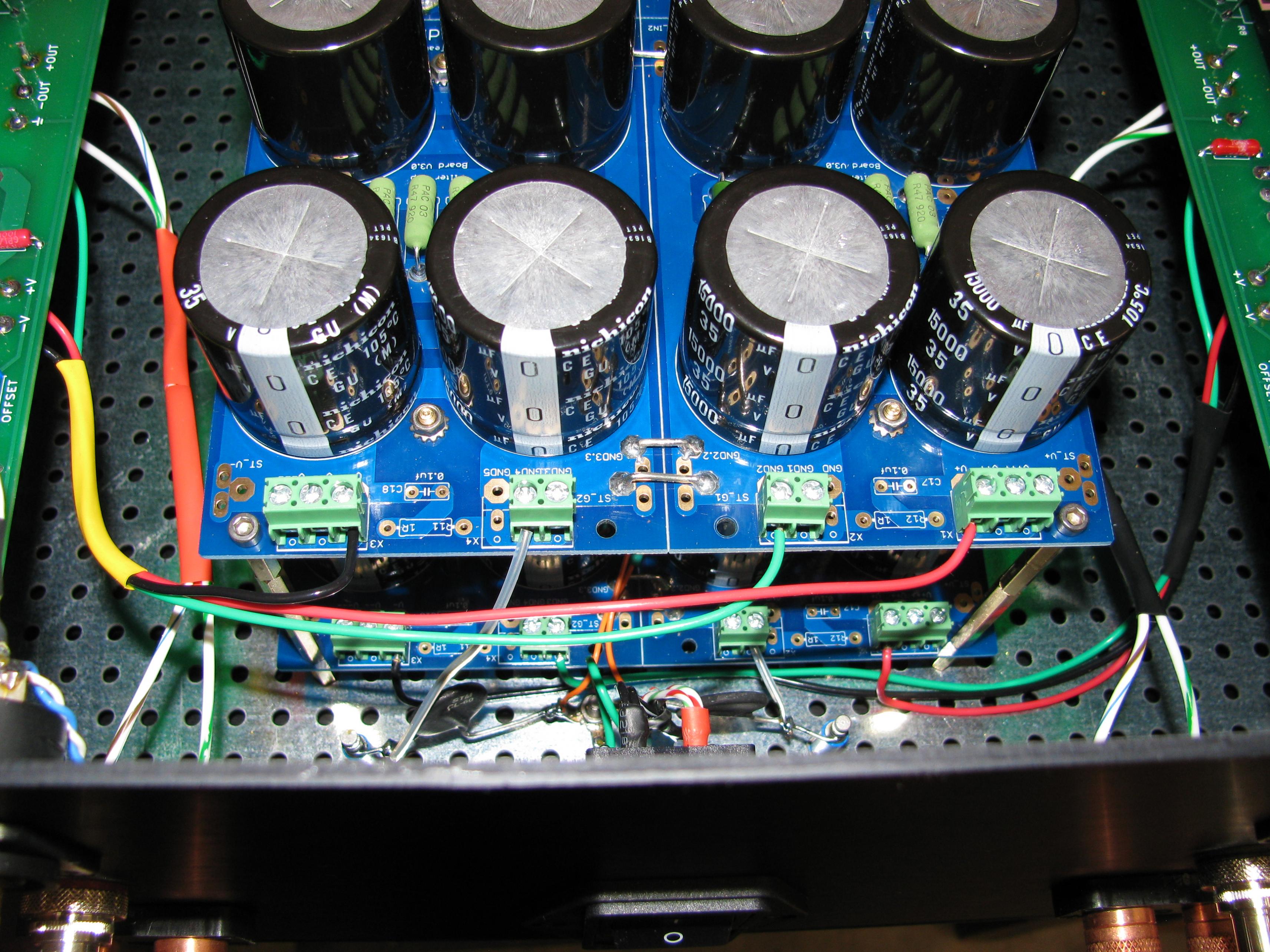

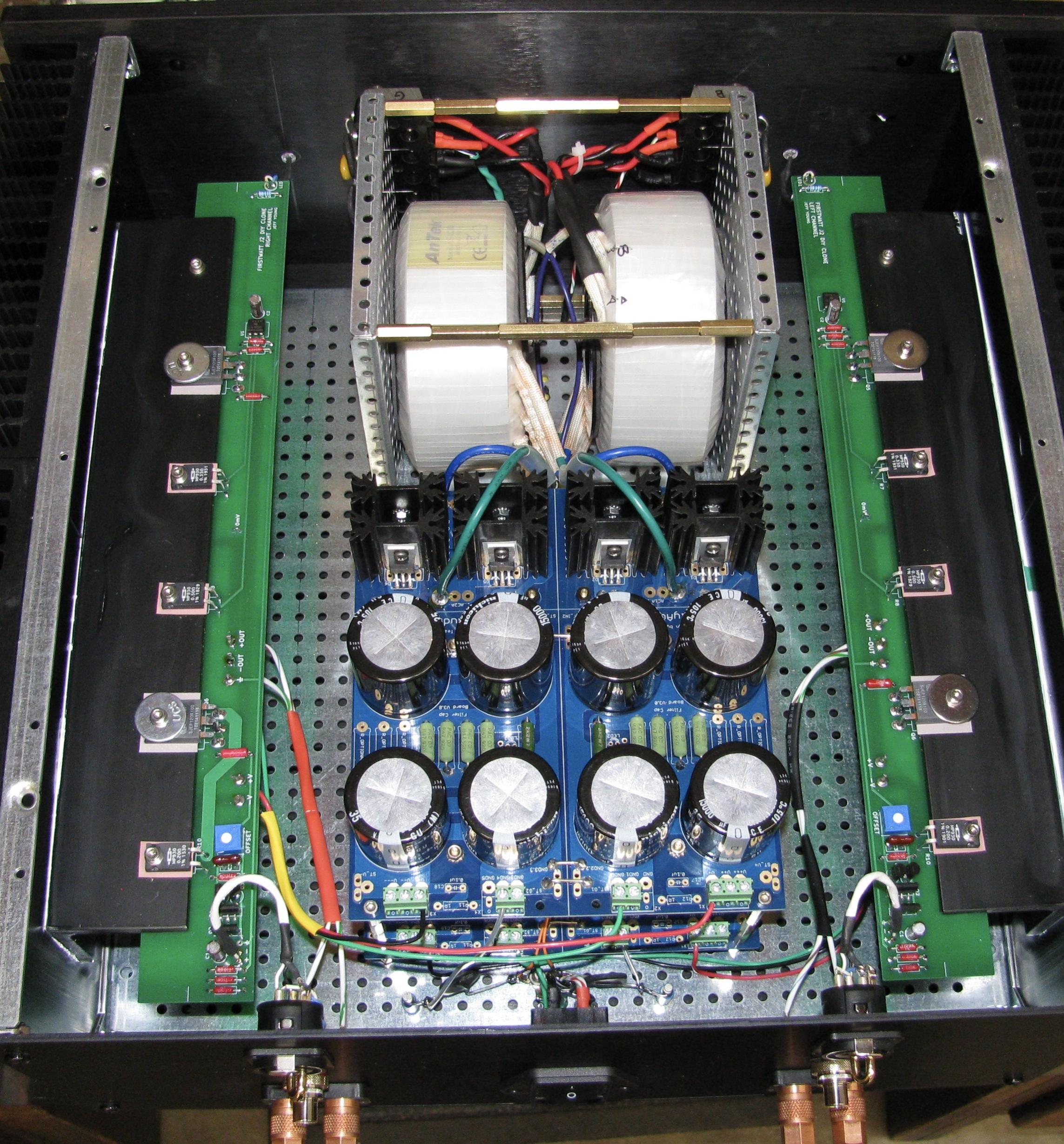

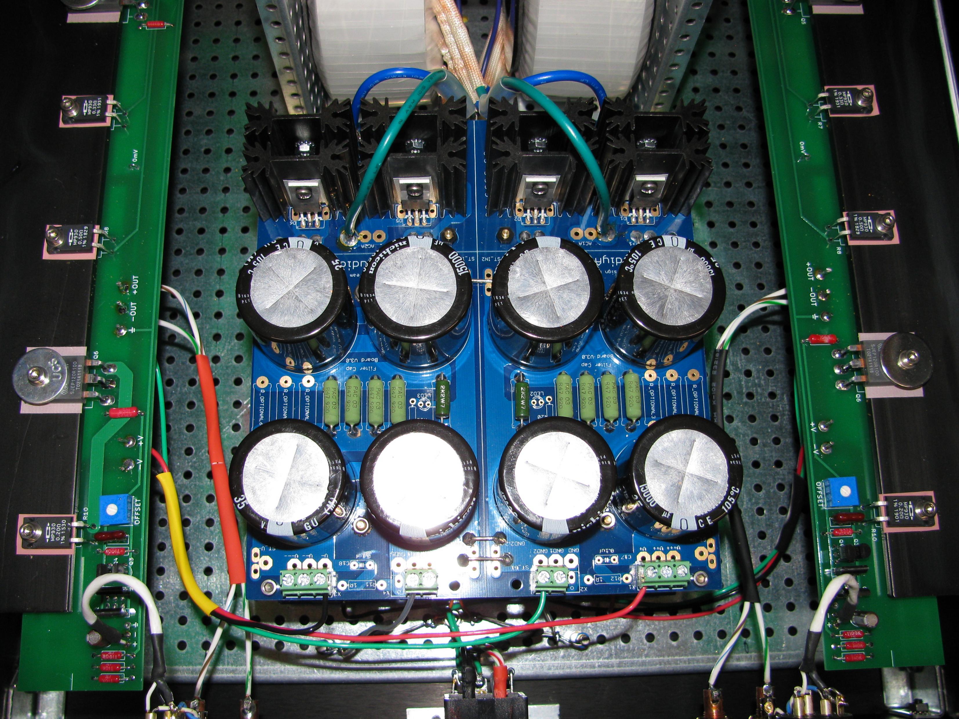

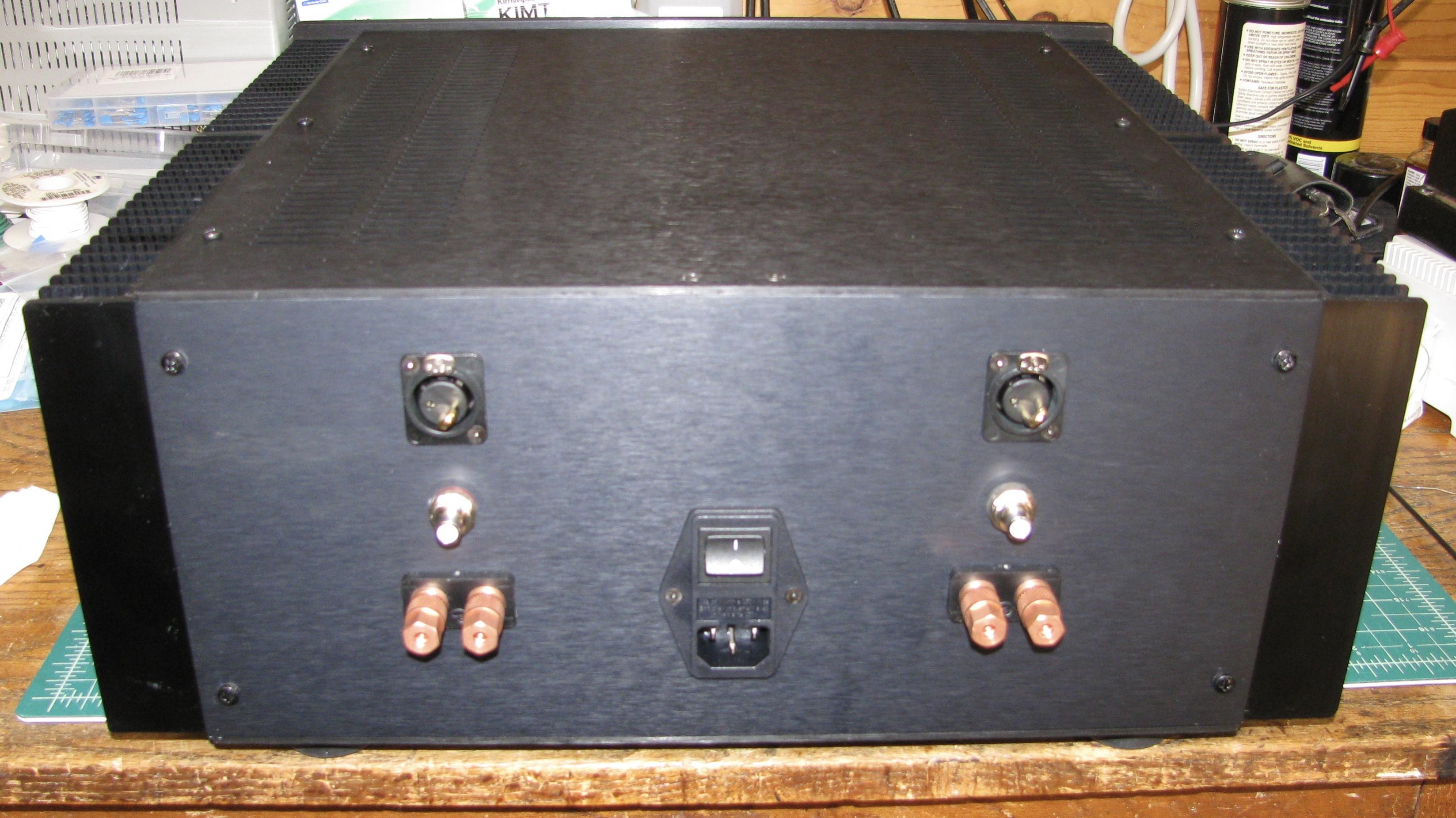

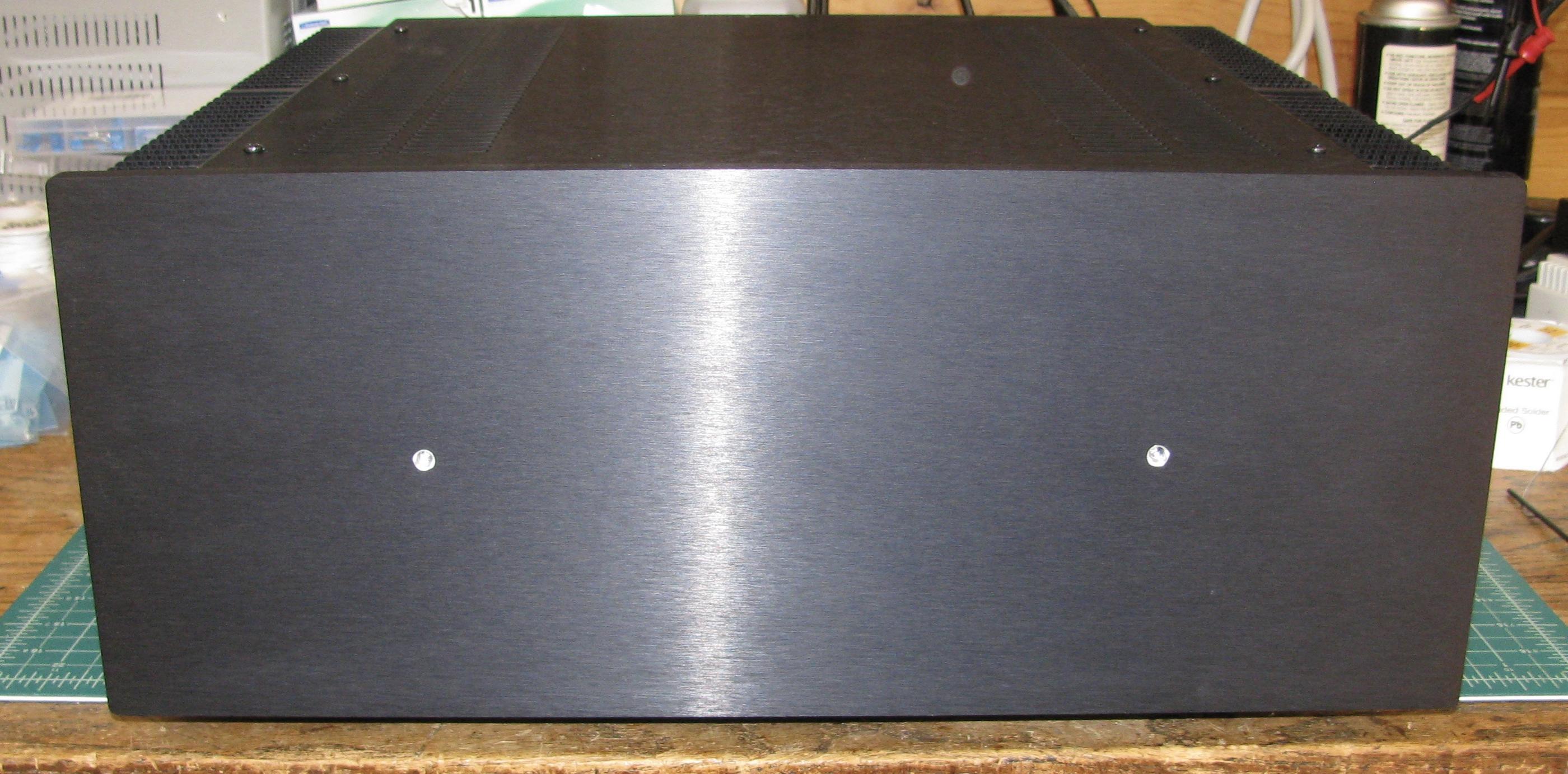

My Second J2 Clone build
This was buillt for a friend.
Not much different than my first build, except it does have dual mono power supplies.
4-400 chassis
1/4 inch (6mm) angle iron mounting plates for boards to heatsinks.
Schottky diodes
1% wirewound resistors in power supplies.
1% PRP and 30W power resistors.
Overall, similar sound to my last build, maybe just a slightly blacker background.

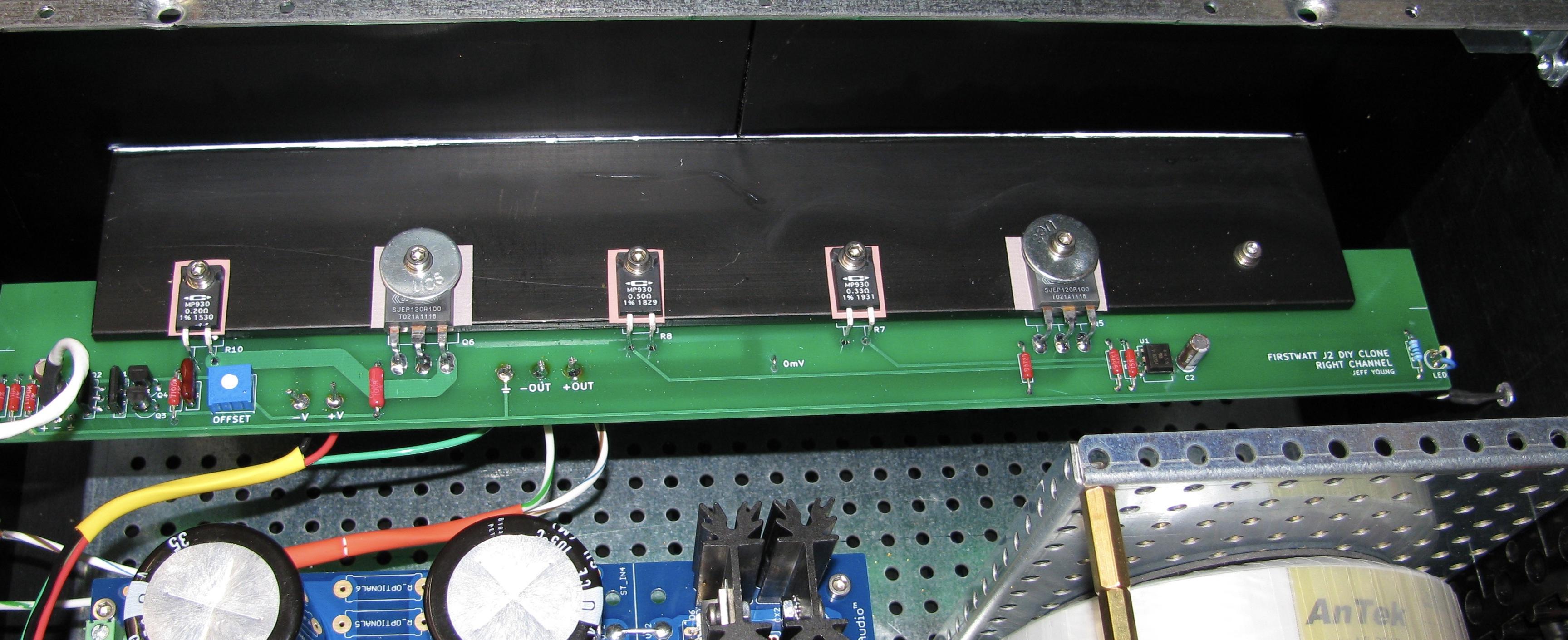

JT,
Temps were about 62 degrees on the power JFETs, 57 on the bracket near the components, and 51 degrees on the majority of the heatsink after equilibrium.
matt
matt

It depends on the resistors that you use. NP did not put his on the heatsink, to me it looks like he used 2 3 watters for each position. I will be using Caddock MP930s and will put them on the heatsink.Funny, just got back today to mine as well.
Do R7,8 and 10 need to be heat sinked?
I measured mine (which are on the heatsink) and they pretty much exactly track the heat-sink temp. Which means it's just as likely that the heatsink is warming them up a tad as cooling them off a tad.
So they don't need to be, but it won't hurt.
