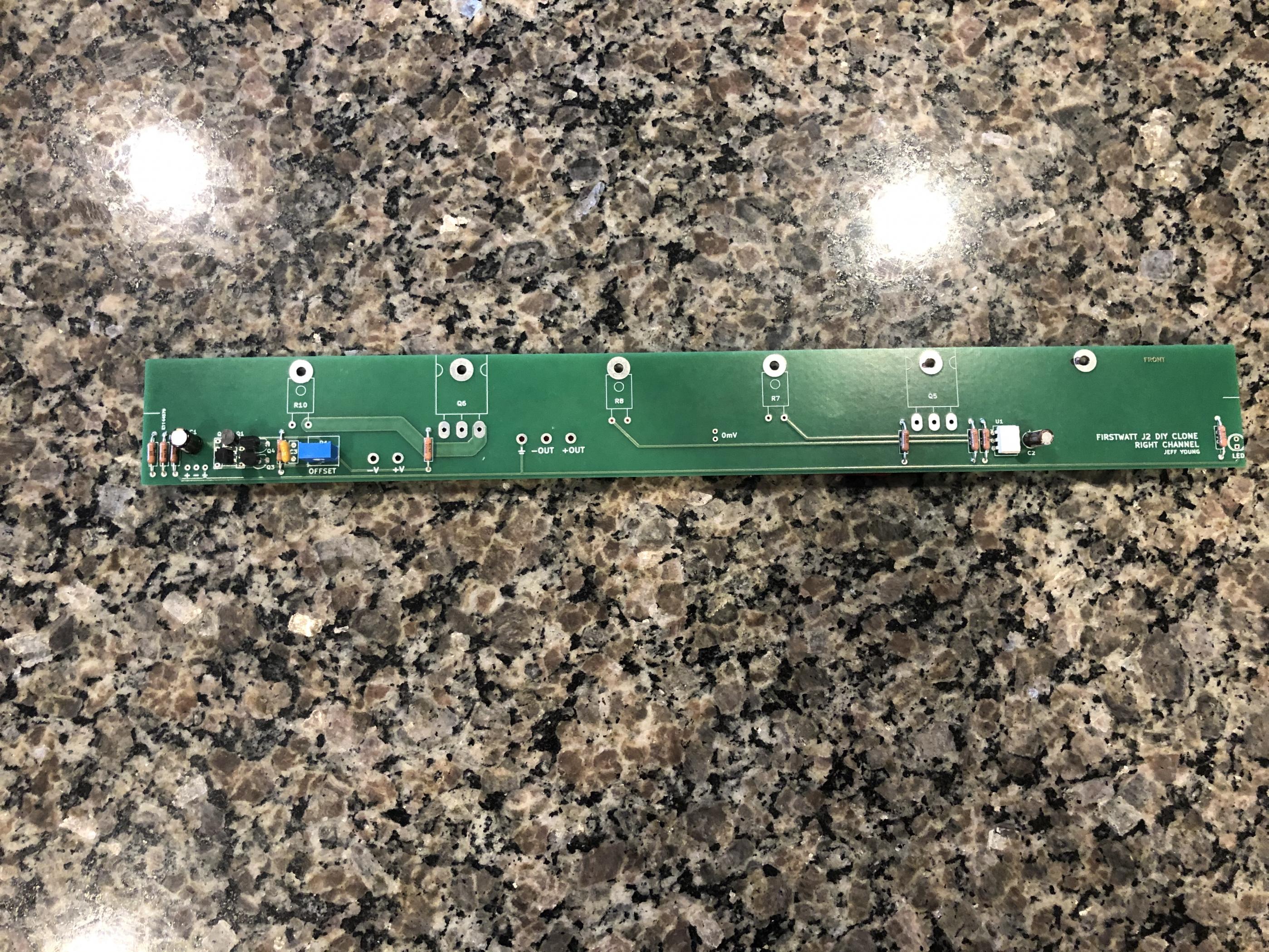

I have gotten as far as I can go before making two important decisions:
1) What to use for Q2?
2) What to use for Q5?
My options for Q2 are, use nothing, 2SJ109 V grade, 2 x 2SJ74 with IDSS in the 10mA range or purchase 2SJ74 with IDSS in the 7 to 8mA range.
My Options for Q5 are use a matched pair of Semisouth SJEP120R100 that I got from the EUVL group buy or unmatched SJEP120R100 that I got from another source.

I'd go with the 10mA 2SJ74s in Q2.
I don't think you gain anything from matching Q5, so might as well plunk down the unmatched ones.
Thanks Jeff.I'd go with the 10mA 2SJ74s in Q2.

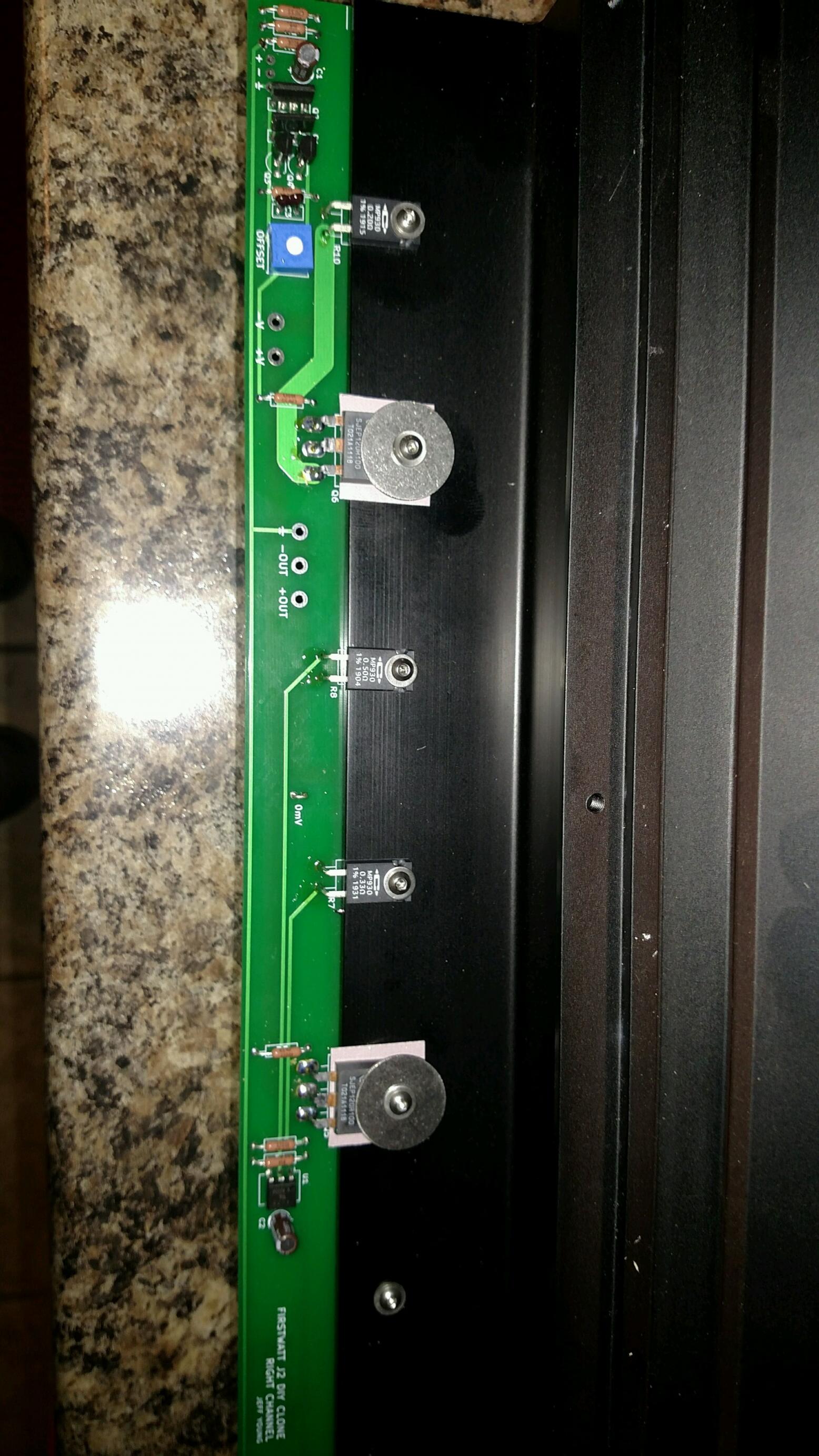

I am getting ready to solder the Semisouths and the resistors.
Just remembered I never did any adjustment to the pot.
Couldnt find any recommendations.
Kind of fearful of smoke from a prior experience
The 500R pot?
I haven't built this so I'm just guessing here. I would leave it at midpoint
(250R), which should give you a Vgs around 1.2V and less than 2A current.
Adjust the pot to null the dc offset.

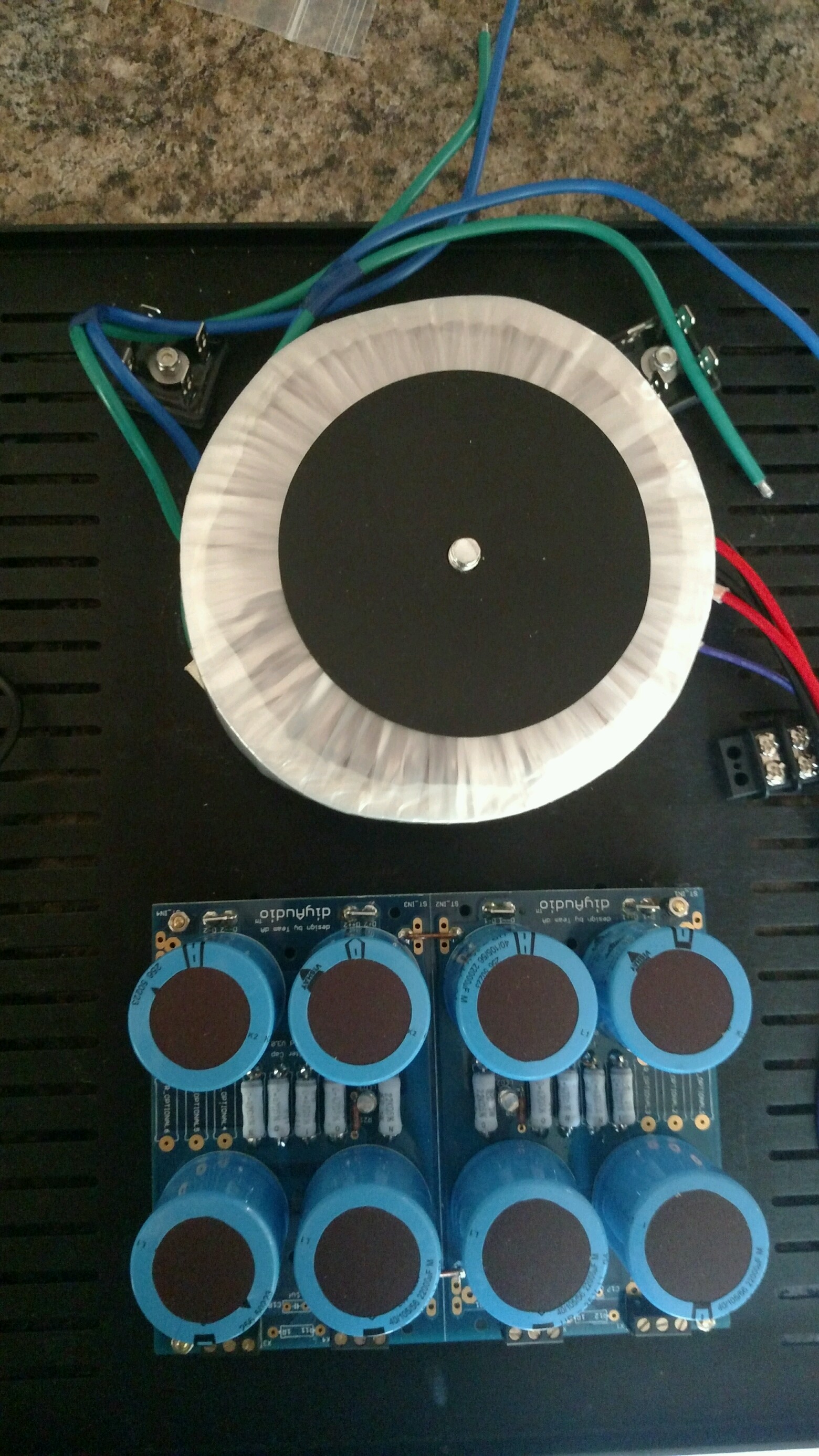

Any idea about the dimensions of the T aluminium plate bracket and also the exact transformer rating for the J2 amplifier?
Looking good, flamethrower!
Manniraj, the plate is 14" x at least 1"; holes are 1/2" back from front on 2" centres.
Manniraj, photos from an early 6moons review show a 300VA 2x18VAC Plitron transformer,
so that should serve as a guidance.

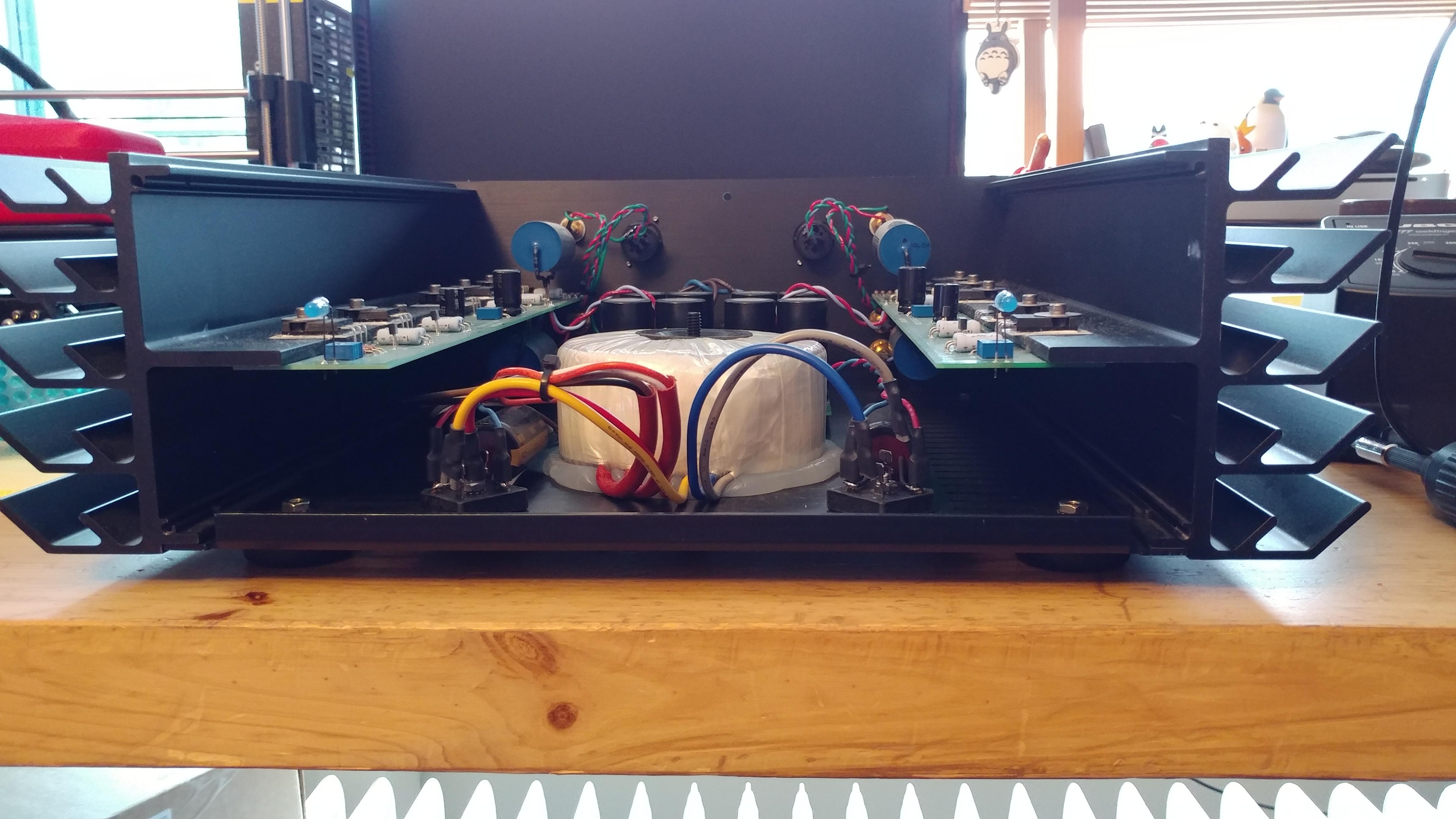

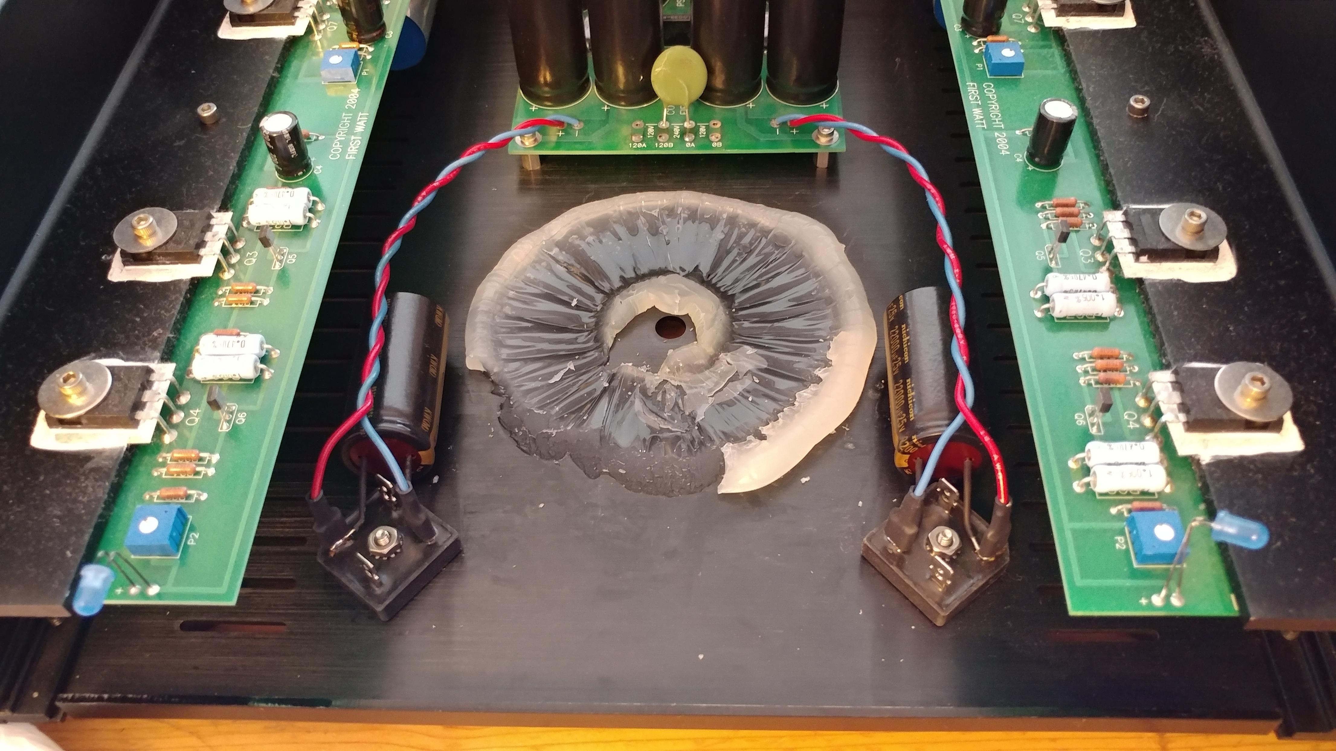

This placement looks fine to me. I might suggest, however, that using "hot glue" to affix something very heavy in a "hot chassis" might be somewhat problematic in practice...
Put a nut on top of that bolt and you'll be in good shape 😉
This how I plan on mounting my transformer.
Noticed some pics where it looks like they were either hot glued or siliconed to the chassis.
Anyway, one step at a time.
In the original FW they are indeed mounted with a layer of silicone. I recently replaced the transformer of my F1J with a bigger one, removing the old one was tricky.
If anyone's interested, more pics here: https://www.diyaudio.com/forums/pass-labs/169509-firstwatt-f1j-3.html#post6231631
I could see some nichicon 22000uf 25v electrolytic cap in series with the positive and negative terminals of bridge rectifiers. What is the purpose of this cap.

The F1J does not have a bipolar supply like many other FW amps, so each channel has its own secondary winding and its own bridge rectifier and filter caps. The caps across the rectifiers' outputs are additional smoothing caps. The idea is to have a cap as close to the rectifiers as possible.
