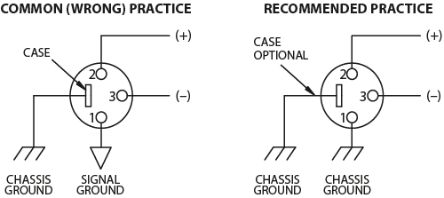

If you want to wire up the XLR input plug to provide a fully balanced signal to the board, then the pic provided will not help you because the ground on the PCB is not wired up.
Refer here (this is one of the sources of info that I used when wiring up my Aleph J):
XLR Wiring Standards, Diagram & Pin-out (3 Pin Audio & 5 Pin DMX)
and my mark-up attached. [Note: If I've made any errors. I'd appreciate the feedback.]
You should wire up your RCA's "cold" to Pin 3 and the "hot" to Pin 2. That way, it will line up with the original J2 plan where you'd insert a jumper pin into the XLR receptacle between Pin 1 and Pin 3 ... unless I'm mistaken.

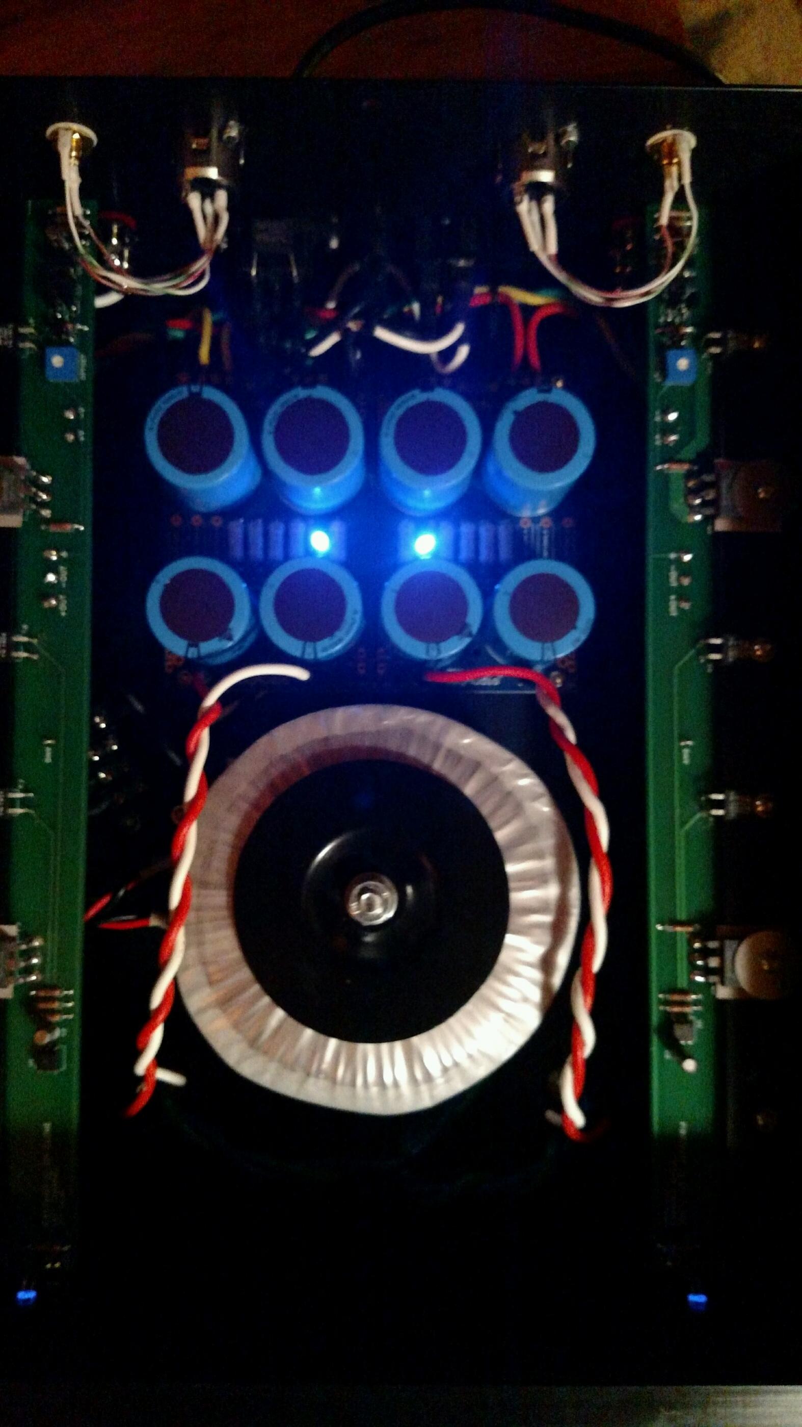

I don't think that fat white cable is co-ax. I think it's a home-made bundle with a sleeve and shrink-wrap at each end. I'll bet it has 3 wires in it....
Yes,, kind of what I was thinking as well, just was wondering why nothing was going to ground (although you can see solder in the ground point like it was desoldered).

...You should wire up your RCA's "cold" to Pin 3 and the "hot" to Pin 2. That way, it will line up with the original J2 plan where you'd insert a jumper pin into the XLR receptacle between Pin 1 and Pin 3 ... unless I'm mistaken.
I wire my RCA "cold" to Pin 1, but with the jumper in the XLR for singled-ended-mode it will amount to the same thing.
The thick white cable is aircraft grade teflon wrapped two conductor shielded cable.
Wired per recommendation of Rane and others for least noise.
I guess I lost my bet. 😉
If you wire it this way then you need to wire your RCA "cold" separately to GND on the board (and drop the use of a jumper in the XLR socket for RCA mode -- otherwise you'd be shorting your signal ground to chassis ground).
That is exactly what I could not get my head around.
Screw it, I am wiring mine the wrong way and lighting this thing up.

I finally got my amp to a point of applying power to it.
Kind of of a fingers crossed point of thing.
All good.
Against other peoples advice on firing up both boards at once, I decided to take a bungy jump.
Got to set the DC offset this weekend and am looking forward to listening this amp

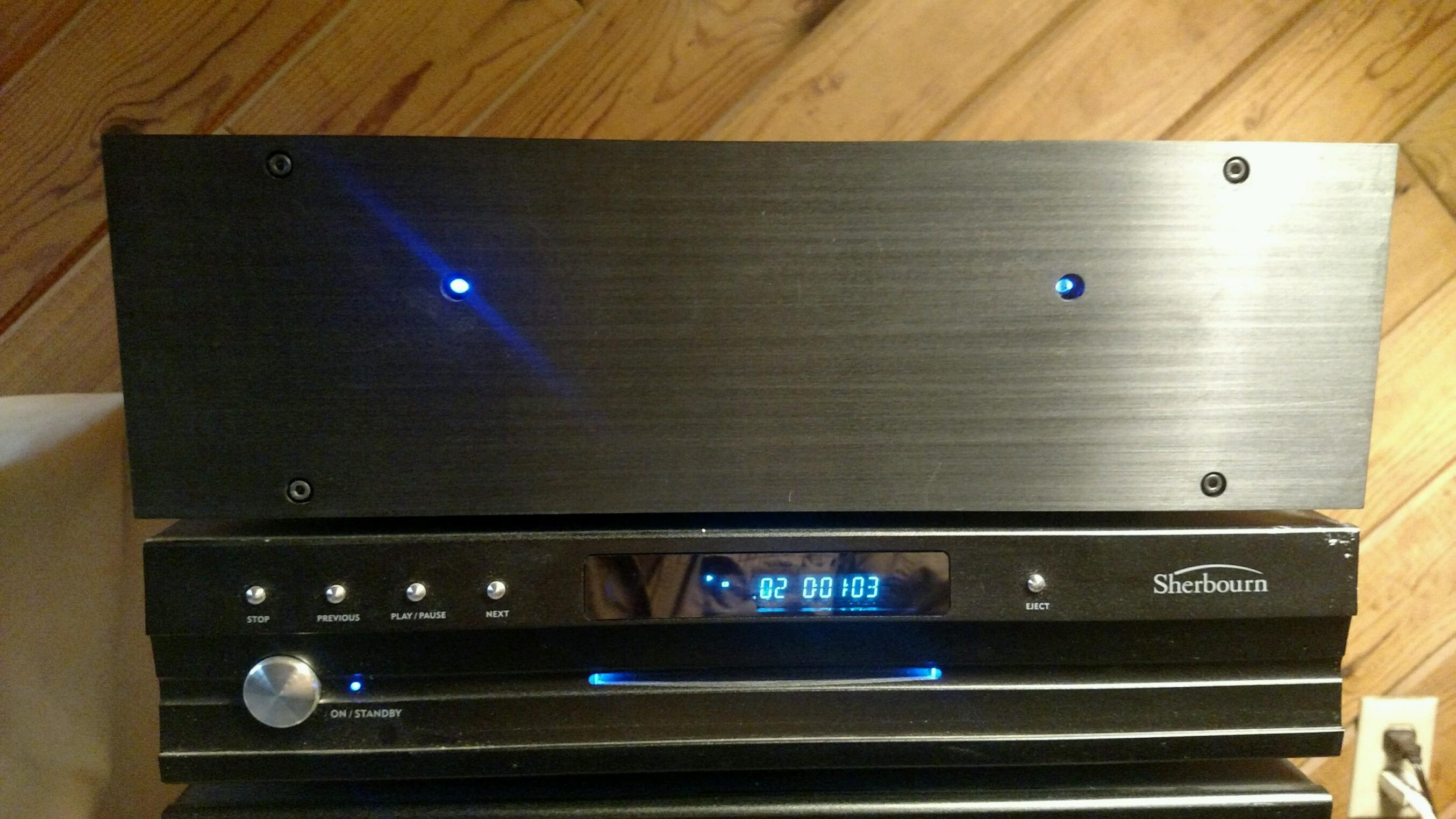

Finally got to setting the dc off set today.
Anyway, another one singing.
It is in my test system currently and sounds/ preforms good.
I can tell already it is a little more laid back than the F5.
Still articulate though.
Thanks Jeff for providing the info for doing this and all else who have helped me when I had a question.
