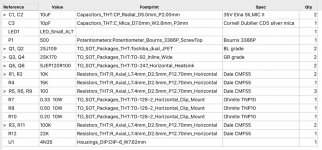

I wanted to look into this project to see if I want to do it. But I have no idea what the hell the BOM file is... I just get chinese characters?
In 2nd message there is a BOM zip file containing an Excel of J2 right channel with content like this:
Reference, Quantity, Value, Spec, Footprint C1 C2 ,2,"10uF","35V Elna SILMIC II","Capacitors_THT:CP_Radial_D5.0mm_P2.00mm" C3 ,1,"10pF","Cornell Dubilier CD5 silver mica","Capacitors_THT:C_Mica_D7.0mm_W2.8mm_P3mm" LED1 ,1,"LED_Small_ALT","","" P1 ,1,"500","Bourns 3386P","Potentiometers😛otentiometer_Bourns_3386P_ScrewTop" Q1 Q2 ,2,"2SJ109","BL grade","TO_SOT_Packages_THT:Toshiba_dual_JFET" Q3 Q4 ,2,"2SK170","GR grade","TO_SOT_Packages_THT:TO-92_Inline_Wide" Q5 Q6 ,2,"SJEP120R100","","TO_SOT_Packages_THT:TO-247_Horizontal_Heatsink" R1 R2 ,2,"10K","Dale CMF55","Resistors_THT:R_Axial_L7.4mm_D2.5mm_P12.70mm_Horizontal" R10 ,1,"0.20 10W","Ohmite TNP10","TO_SOT_Packages_THT:TO-126-2_Horizontal_Clip_Mount" R3 R11 ,2,"100K","Dale CMF55","Resistors_THT:R_Axial_L7.4mm_D2.5mm_P12.70mm_Horizontal" R12 ,1,"22K","Dale CMF55","Resistors_THT:R_Axial_L7.4mm_D2.5mm_P12.70mm_Horizontal" R4 ,1,"15K","Dale CMF55","Resistors_THT:R_Axial_L7.4mm_D2.5mm_P12.70mm_Horizontal" R5 R6 R9 ,3,"100","Dale CMF55","Resistors_THT:R_Axial_L7.4mm_D2.5mm_P12.70mm_Horizontal" R7 ,1,"0.33 10W","Ohmite TNP10","TO_SOT_Packages_THT:TO-126-2_Horizontal_Clip_Mount" R8 ,1,"0.50 10W","Ohmite TNP10","TO_SOT_Packages_THT:TO-126-2_Horizontal_Clip_Mount" U1 ,1,"4N35","","Housings_DIP😀IP-6_W7.62mm"

In case anyone else has trouble, here's a capture of the BOM from Kicad:
NB: this is for a single channel. Double the quantities for a stereo amplifier.
Note also that each 2SJ109 can be replaced with a pair of 2SJ74, and that one of the SemiSouth JFETs (Q5) can be replaced with a cheaper MOSFET (see the J2 thread).

I run Linux, which has Libre, that can read all the standard formats... I can't understand why you wouldn't make it a standard .xml that is backwards compatible to early versions of excel.
Let me show you.
... why you wouldn't make it a standard .xml...
Because the BOM was written by Kicad, not Excel.
In the Import dialog you show, is there an "ASCII" choice under Import / Character set? I imagine that would give you what you want, although I don't have Excel or Libre....
Change the "Character set": to- Unicode (UTF-8)
yo
That worked, thanks!
