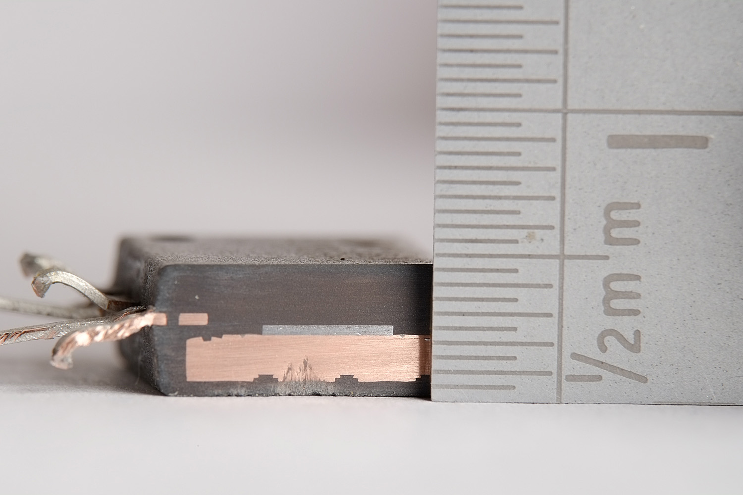

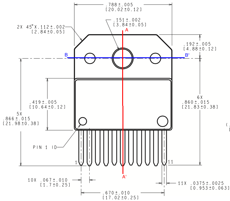

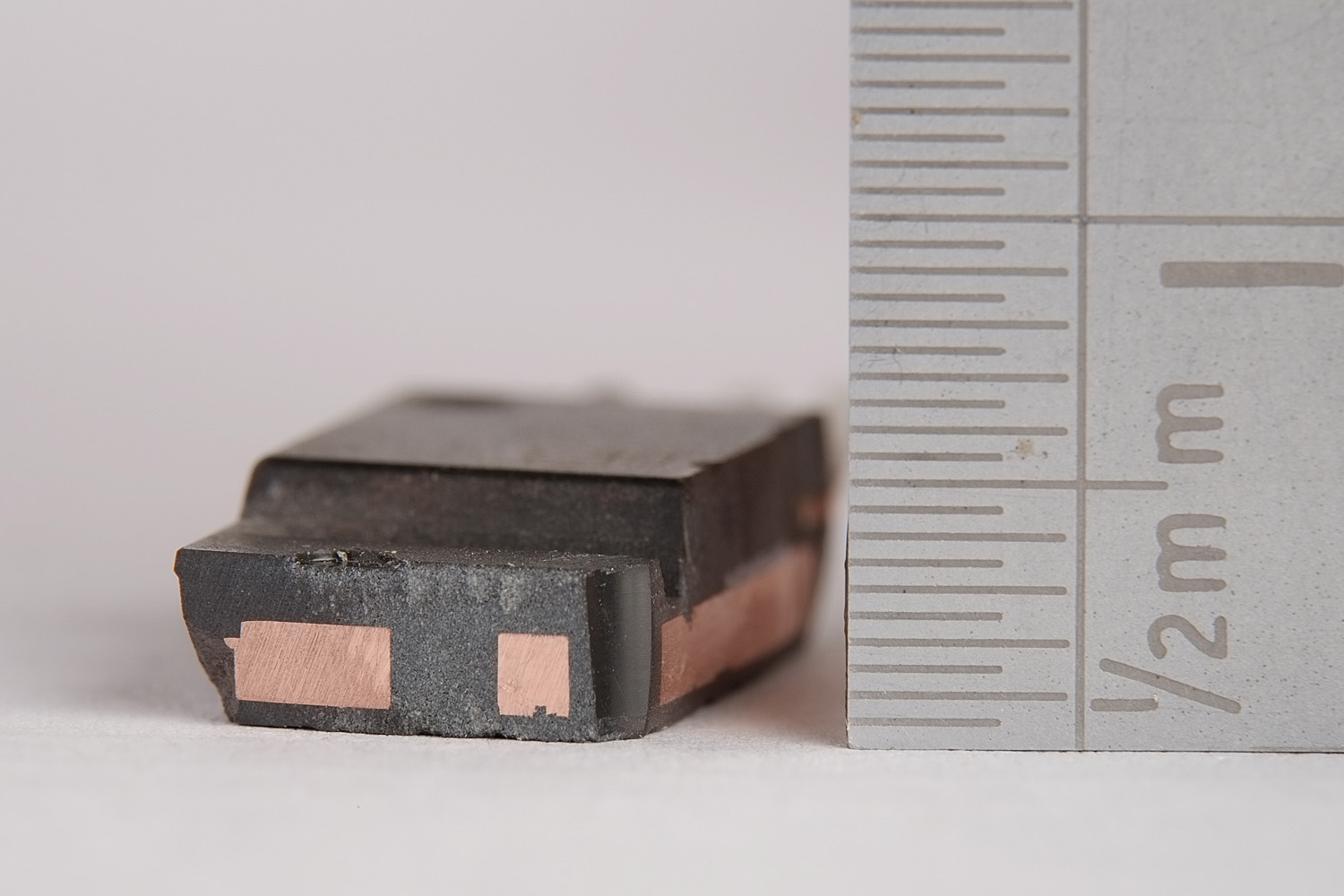

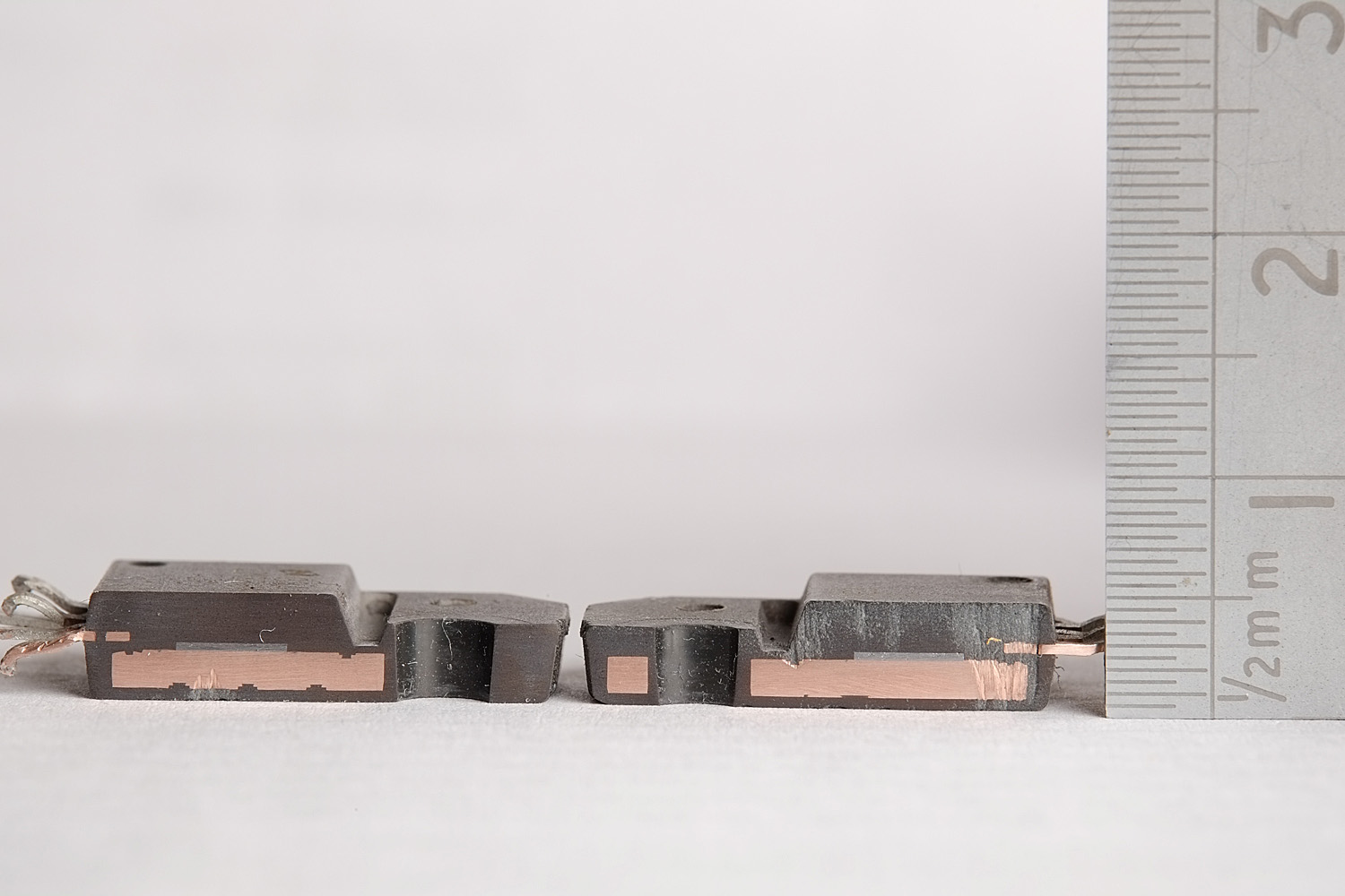

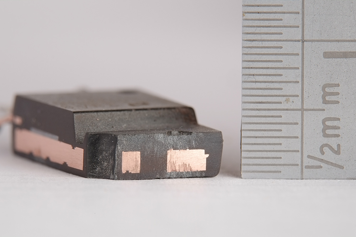

Perhaps it would be helpful to publish a photo of the tab portion of the TF package in addition to the fatter portion where the die is.
Good suggestion. It turns out the copper DAP is fragmented in the top part of the package.
The first image is the one I posted yesterday. I include it here for completeness. It shows the copper DAP (reddish metal), the IC die (light gray), and plastic mold compound (dark gray). This cut was done along the A-A' line shown in the diagram in the final image.
The second image shows the two halves of the package. Again the A-A' cut. It's pretty clear that the area around the mounting hole is missing some copper, at least in one of the halves.
The third image shows the cross-section of the package when cut along the B-B' line. This is "horizontally" through the tab. It's pretty clear that the copper DAP is in several pieces.
The fourth image shows the other half of the package when cut along the B-B' line.
It's pretty clear that the dominant heat flow will be from the die through the DAP to the back side of the package. In case a clamping bar is used, some heat will flow from the die to the clamping bar through the plastic. However, the thickness of the plastic from the top of the die to the top of the package is nearly four times greater than the thickness of the plastic from the DAP to the back of the package. I highly doubt the clamping bar will provide any meaningful reduction of the thermal resistance.
