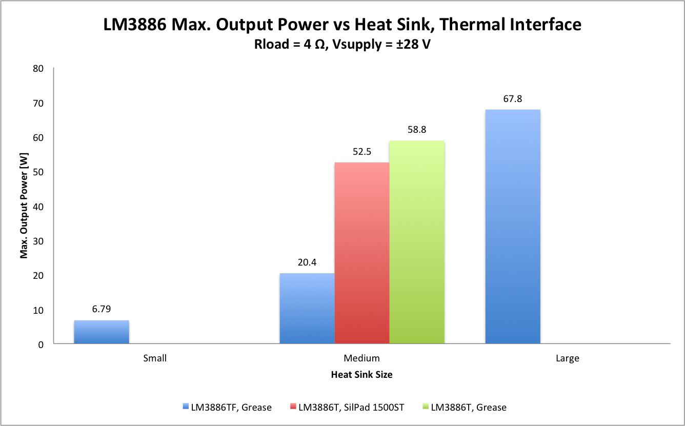

Judging by the range of recommended thermal solutions for the LM3886 on this forum, there appears to be quite a bit of confusion on exactly how much heat sinking the LM3886 requires. I have written extensively about this on my website, Taming the LM3886 - Thermal Design, and I encourage anyone interested in the math and engineering behind proper thermal design to read that.
That said, I still found myself curious about exactly how small of a heat sink one can get away with. I also wanted to characterize the difference in thermal performance between the LM3886T (non-isolated) and the isolated LM3886TF. So I conducted an experiment...
Three heat sinks:
Two types of LM3886:
Two thermal interfaces:
Supply voltage: ±28 V
Load impedance: 4 Ω
Now, I did not test all combinations of these as some combinations didn't make sense. For example, the LM3886TF can deliver the full rated 68 W when mounted on a 0.4 ºK/W heat sink, hence, the LM3886T will be able to as well. Similarly, the small sheet aluminum didn't provide much of a heat sink.
A 4 Ω load was used as this results in the highest amount of dissipated power in the LM3886.
Thermal limit: The LM3886 contains two circuits that protect the IC against failure at high temperature. The thermal protection circuit mutes the output once the die temperature reaches 165 ºC. The circuit un-mutes the IC once it has cooled to 155 ºC. In addition, the SPiKe protection circuit ensures that the output devices are operated within their safe area of operation (SOA), which includes temperature.
Test methodology: The LM3886 was attached to the heat sink and operated at the peak power dissipation (happens at 40.5 W output power into 4 Ω for an LM3886 operating at ±28 V) with a 1 kHz sine wave, continuously, until the heat sink temperature had stabilized. The output power was then adjusted until neither the SPiKe circuit nor the thermal protection circuit engaged (verified by watching the output voltage and distortion over time). The output power was noted as the maximum output power (see chart below) and the heat sink temperature was measured with an IR thermometer. Note that the IC operates at a die temperature just shy of 165 ºC under these conditions. Also note that the heat sink temperature reached 104 ºC before the thermal protection circuit kicked in.
Observations: I was surprised by the amount of power I could get out of the LM3886 when mounted on the Pentium Pro heat sink. It's a pretty small heat sink. A quick calculation puts its thermal resistance around 2.5 ºK/W. That is actually enough to allow the LM3886 to survive at peak power dissipation, though, as soon as the furnace in my house kicked on and raised the temperature of the room slightly, the thermal limiter tripped. Also, the SPiKe protection kicks in once the output power approaches 50-60 W. The heat sink temperature reaches 104 ºC, so this is definitely not a safe arrangement for an external heat sink. However, a CPU heat sink with a fan (and fan controller to keep it quiet when there's light thermal load) seems like a pretty viable solution.
The large, 0.4 ºK/W heat sink reached 43 ºC when operated at the peak power dissipation. The ambient temperature was 20 ºC.
For an external heat sink, where a maximum temperature of 60 ºC should be enforced, a 0.8 ºK/W rated heat sink is needed for sine wave operation. This was estimated from the temperature rise of the 0.4 ºK/W heat sink and is in line with the math on my website.

The labeling should reflect what you are testing.
I see you are testing for continuous maximum power until some "trigger" point limits the continuous maximum power being measured.
Continuous has been omitted from the Thread title and from the diagrams. This is misleading.

The TF does not like continuous duty.
That's not true. The LM3886 doesn't mind continuous duty at all. It just needs a larger heat sink than the LM3886T to support the power.
Note that the LM3886TF was actually able to deliver the full 38 W into 8 ohm on the "small" heat sink (13x13 cm, 1.6 mm thick aluminum sheet). I forget what the heat sink temperature ended up at. I can look that up when I get home.
I knew it was poor, but the National data never gave me the clue it was that bad.......................
Have I mis-read the data.That's not true. The LM3886 doesn't mind continuous duty at all. It just needs a larger heat sink than the LM3886T to support the power...........LM3886TF was actually able to deliver the full 38 W into 8 ohm..........
You show 20.4W for the TF vs 52.5W & 58.8W for the T version using your test set up and continuous duty.
Are you saying something else?
I did not see 38W for the TF anywhere.
On the Pentium Pro heat sink ("medium"), the TF provides 20.4 W RMS continuously into 4 Ω. This means it'll survive use for music reproduction, assuming a crest factor of >6 dB. Of course, the heat sink will get screaming hot, but the IC will survive. Just a few posts ago, you argued that a 20 dB crest factor should be used. The TF will barely break a sweat under those conditions if fitted to the Pentium Pro heat sink.
The TF version provides the full 68 W on the "large" 0.4 ºK/W heat sink. That's in line with National/TI's specs. I don't see how this renders the chip useless or somehow inferior to the T version as you mentioned earlier.
I did not present any 8 Ω data as it wasn't very exciting. The TF version will provide the full specified 38 W into 8 Ω when fitted to the "small" heat sink (130x130x1.6 mm aluminum sheet). When operated at the peak power dissipation, continuously with a sine wave signal, 8 Ω load, ±28 V supply, the "small" heat sink reaches 91 ºC. Just before clipping (Pout = 38 W), the heat sink reaches 82 ºC.
