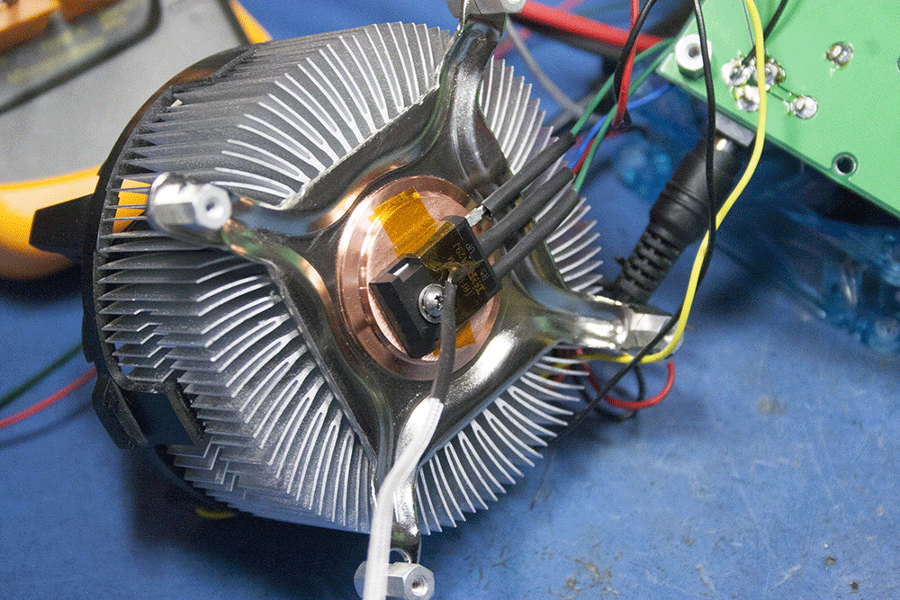

I had a look around at interesting options for heatsinking that could allow for novel packaging. I gave up because my fabrication skills would never allow them to be realised. I have always been a fan of heatpipes for getting heat away even if they have other issues and the drive for fanless PCs for home theatre means there are some interesting and affordable options out there IF you can arrange things around it.
One example is the nofan range :: NOFAN Corporation :: Noiseless Computer, Noiseless Cooler, Noiseless Computer Case, Noiseless Power Supply, and other various noiseless computer components. Specialized Noiseless Computer hardware manufacturer. . Specs are hard to come by, but IIRO .75C/W and designed for 80W CPUs. But the heasink is orthogonal to what we need so you would need an intermediate block or some fancy mounting of the pcbs. But at least to my warped aesthete it could look quite nice. If only I could fabricate a nice chimney in chrome around it.
The other shame is that 3M don't make TC-2810 available in small quantities that don't need a £70 mixing gun to dispense.
Tom has shown that there are some really interesting options for this. Everyone has a stash of PC heasinks somewhere or some dead graphics cards...

Another idea for heatsinking... measured only +4*C rise for every 10Watts of power dissipated.
Forced air is amazing for removing heat. The fans do tend to be a bit noisy.

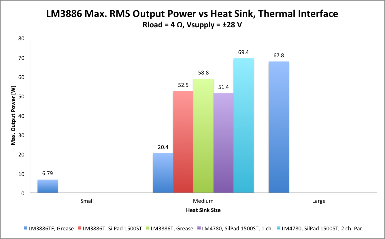

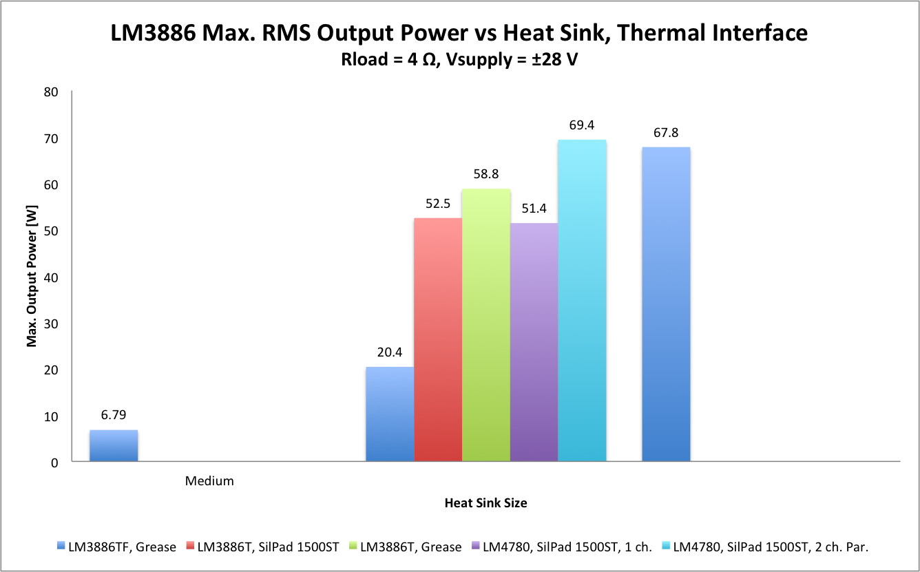

I decided to add another couple of data points: LM4780 (one channel driven, one channel idle); LM4780 (two channels in parallel). See attached graph.
The thermal resistance from the junction to the package is specified to be 1.0 ºK/W for the LM3886 and 0.8 ºK/W for the LM4780. I wanted to see if the lower thermal resistance of the LM4780 would make any difference or if it would get outweighed by the quiescent power of the un-driven channel. There is no way to turn the unused channel completely off. Even if the channel is muted, it still draws the full quiescent current.
The single LM4780 channel delivers slightly lower power than the single LM3886 when mounted on the "medium" (Pentium Pro) heat sink. The LM4780 starts tripping the SPiKe protection around 51-52 W.
When the two channels of the LM4780 are connected in parallel (using 0.1 Ω ballasting resistors on the outputs), good things happen. Now the output devices in the respective channels only deliver half the output current, hence, remain within their safe areas of operation. With the two channels in parallel, the IC can deliver the full 68-69 W.
The heat sink temperature is slightly higher than with the LM3886. No surprises there. The LM4780 does burn an additional 3 W in quiescent power. At the peak dissipated power, the heat sink reaches 106 ºC (yikes!). It turns out that's hot enough to melt the plastic zip-lock bags that Mouser uses for their parts...
I also decided to address the "what about music?" question. After all, these amplifiers are mostly used for music reproduction. To avoid the discussion about which recordings of which artists constitutes "music", I used a multi-tone signal developed by Audio Precision. This signal consists of 32 tones, equal in amplitude, logarithmically spaced in frequency from 14 Hz to 20 kHz. AP uses this signal for some of their more advanced testing. This test signal has a crest factor (ratio between peak and RMS power) of 13 dB. A comprehensive analysis of 4500 music tracks by Sound-on-Sound Magazine found an average crest factor of 14 dB for their music collection. Hence, I argue that while the 32-tone signal isn't music per se, it does have the same characteristics as music when it comes to the peak vs RMS power, hence, can serve as a test signal representing average music.
When delivering the 32-tone test signal at the maximum amplitude possible without clipping, the "medium" Pentium Pro heat sink reaches 90 ºC.
I stand by my recommendation that if you you're going to skimp on the heat sink size on your chip amp, please add a thermal switch so the amp turns off before somebody gets burn blisters from touching it.

More good information.I decided to add another couple of data points: ........................
