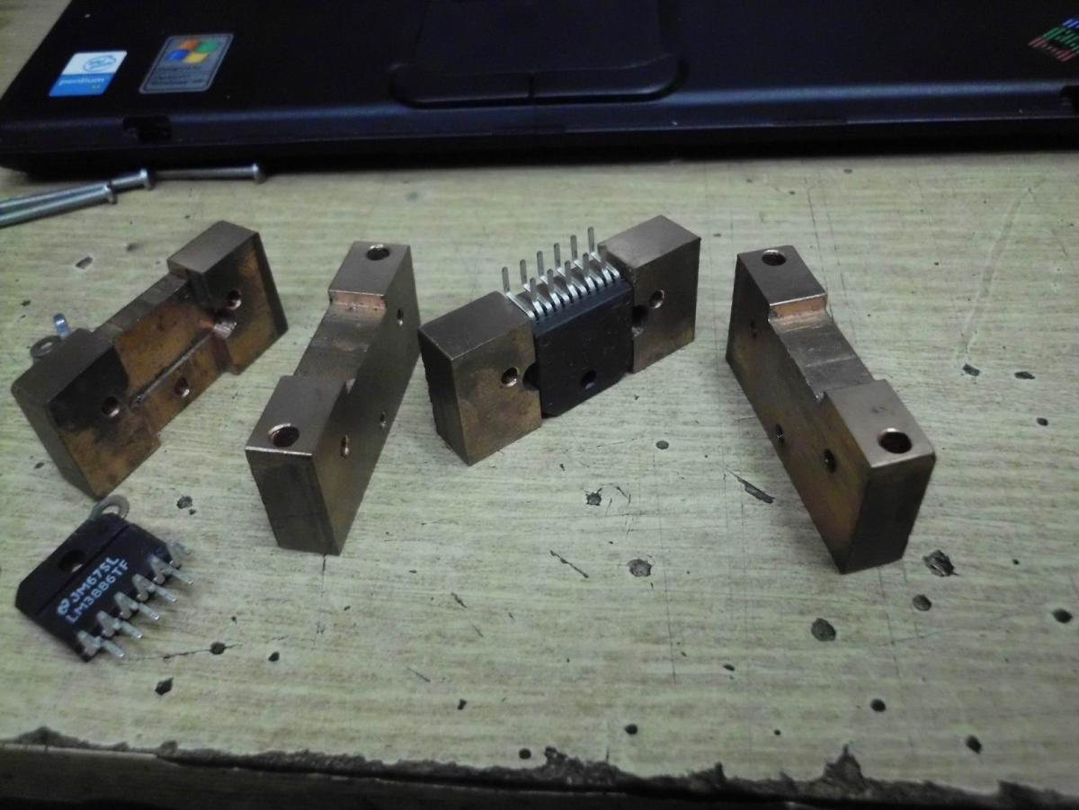

Those metal parts are used in one very unique Macola's High-End AMP design build with 4 x bridged/parallel LM3886 per channel (or 6x, I forget, was long time ago) … There is no schematic for that AMP currently …

That appears to be copper, or a copper alloy. Anyone knows that copper is second to none when it comes to absorbing heat. The second advantage you have there is mass. That sink can absorb a lot of heat in a short period of time.
However, you then need to move the heat out of the block. The best conductor of heat is aluminum, but the trick is to have as much surface area as possible; fins.
The ideal situation would be a fairly thick layer of copper, bonded to a thinner layer of aluminum with lots and lots of fins to increase surface area.
Browse photos of CPU heat sinks and you will see this repeated in many styles. This is because it works.

copper bolted onto the non-tab side wont do much.
True, it won't do much, but it'll conduct heat better than air - especially if thermal compound is used conservatively.
Still, you are quite right that all of that is certainly unnecessary if the tab side has a well designed and implemented sink.

Removing the plastic facing of the TF package and directly attaching the exposed tab to the heatsink will probably do far more, than enclosing the device inside a block of metal.
In which case you might as well buy the non-isolated LM3886T version.
Using some sort of clamping bar across the LM3886 package can assist in the distribution of the clamping pressure, which may lower the thermal resistance between the device and the heat sink ever so slightly. In the case of the clamping blocks shown a few posts back, one has to be careful to get the clearances right. Too much slop in the clamping block results in a worse thermal interface. Too little, and you risk cracking the IC package during mounting.

You know, some of those fat metal blocks have holes (larger than for mounting screws) in them, and I wonder if ...As show on picture …

i dont understand one thing ,if you dont want v- on heatsink what else you can do ?buy 3886t and put fat mica insulator and two layers of heat paste? is that realy better than tf version with little bit of paste?
in datasheet says
so isnt that the real limit of chip? junction to case resistance?...It is also known that typically the thermal resistance, θJC (junction to case), of the LM3886 is 1°C/W and that
using Thermalloy Thermacote thermal compound provides a thermal resistance, θCS (case to heat sink), of about
0.2°C/W as explained in Heat Sinking...
yu3ma solution puts less case to heat sink resistance but does it lessen junction to case resistance , i hope that with your expert maths you actualy can calculate this things in more than 2 dimensions of chips back.
