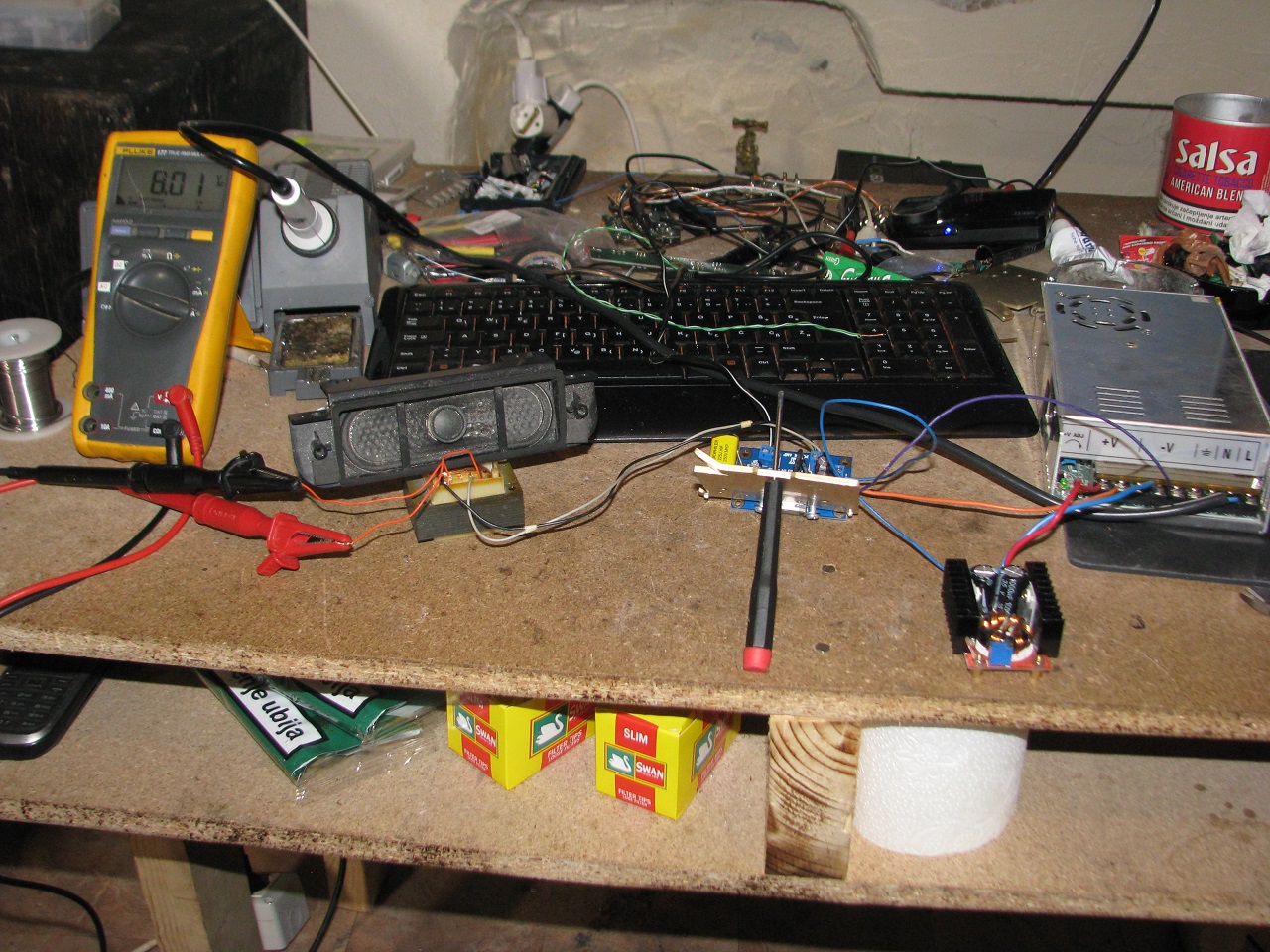

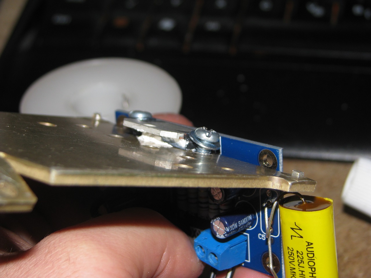

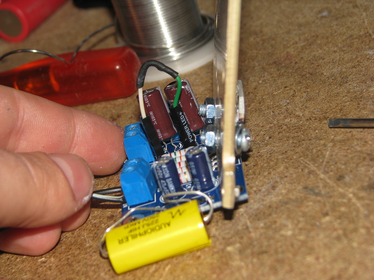

well i dont know maths well but this worked over 20 minutes and didnt seem to get more hot ,at least to my measurments by hand , while chips back side was hotter then aluminium piece , aluminium part actualy got pretty warm,almost hot.
powered by +-12v from mean well supply and buck boost converter for dual rail. it was outputing 8v AC into 2.1 ohms trafo secondary and on trafo primary was speaker. 50 hz sine generated by audacity...
you know maths i hope you can pull some valid data out of this but i think front chip side actualy does transfer heat well! better than expected!

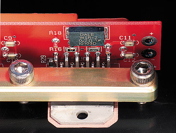

Distributing the clamping pressure evenly across the IC is a good idea. All you need for that is a bar across the IC package that you clamp to the heat sink. You don't have to use fancy materials or fancy shaped clamps for this.

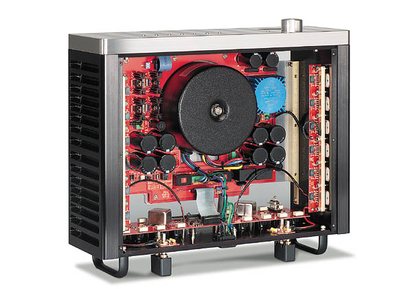

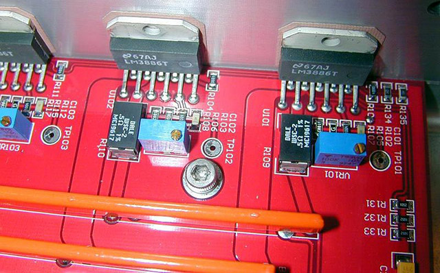

From the o r i g i n a l "multi3886" amp: 😉
and
Rowland +3 parallel and -3 parallel (+/- 3 para/bridge)
[if i recall, they're inverted and the pot is to adjust the -in 'res' to gnd (on the neginput, to balance the + and - input impedance on the 3886; to get min out offset or min input dist. ... )
...errr, and fancy transformer inputs ... ]
from
Jeff Rowland LM3886 Amplifiers
you don't even wanna know the date ...
... this is ol' schooool!

Without knowing the output current you can't say much about your test.
Try connecting a resistor to the output.
if transformer conected on output resistance is 2.1 ohms and across that 2.1 ohms i have 8v AC at 50hz .
isnt that 30w output of lm?
and isnt that 3.5 amps?
NO.
How did you measure the resistance? With a DMM at DC?
Now you are testing with 50Hz with a speaker connected to the secondary.
i connected 8ohms speaker on primary, secondary to lm outputNO.
trafo is 230v primary > 24v secondary ac , 25VA at 50hz rated, it started smelling bad after 10 minutes of this torture, so i assumed that it had more than 25 w at output of lm3886 but assumptions are always bad so i would like to test this your way but i am not sure how exactly.
primary dc resistance is 200 ohms secondary 2ohms ,wire thickness is primary: 0,5mm , secondary i cant measure . thats all i have
