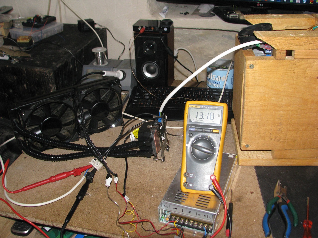

I would suggest that a 1Vac continuous sinewave test signal @ ~50Hz into 4r0 dummy load would turn on the thermal limiting quite quickly, maybe within 1minute, or 10minutes, or 60minutes.@tomchr
if lm3886 can output 6,7v at 50hz continous sine(not that averaged thing of yours), to speaker of 4 ohms ,without turning on spike and running at that output for full hour from +-12v psu, could you calculate how much heat is being transfered from chip to heatsink of dimensions 94mm *72mm *3mm , that same heatsink being mounted on front side of lm , and somehow prove to me and everyone else that it is worthless as you say it is.
as i am feeling good today i would like to propose a test,if you would like i will mount lm facing front to some huge heatsink i have available(better say water cooling with 240mm radiator) and connect it on better power supply to try to pull more power out of front side of chip than your comercial design can pull out of back of lm (but not "with vanishingly low THD and phenomenal sound quality" just as far as it goes without spike.).but that will i do only if you would be nice and actualy try this you call "new" mounting method for yourself and maybe measure whatever you measure to feel fine.
You won't need 6.7Vac to prove that fixing the device back to front does not work !
Do you suggest to test with resistor is better than with speaker,will try that latter no matter what results are ,i just hope to see first hand what wil happen .

A resistor as a dummy load is easy for others to replicate your work and get the same results, if you have done it correctly.
The second advantage to using a resistor as a dummy load, is that the "stress" on the components is much less than when using reactive loads.
You are less likely to "blow up" your precious prototype using a resistor load, than when using a speaker load.
Thirdly, a speaker is a very variable load, is the version one of your KEF xxxb the same as your neighbours version 17 of the same speaker.
This applies all the way across every manufacturer's range of speakers. They change the specifications. A speaker that sells for ten years may well go through five generations of changes. If it was of Japanese origin it may well go through those 5generations in little over a year and then they give it a completely new model name to try and sell to all the gullible buyers who have version 3.26

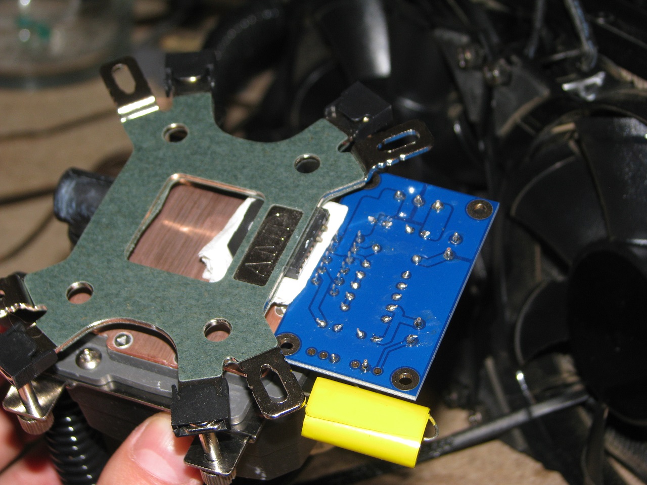

In this case, the top side is metal (not resin as LM3886), and the bottom is connected to thermal vias and perhaps a heat sink on the other side of the pcb (or just the ground plane)...
when you do know physics like everyone seems to know on this forum , could you please make it clear to me how could i calculate how much dissipation there realy is from front side of chip ,could i use some ntc thermistors for temp measurments and how to translate resistance change to degrees change. and how to get some actualy real measurments out of that all. i dont care if in end it equals to 1w dissipation out of front side but i want to test it .
You'd have to measure the difference in heat flux through the top and bottom paths. That is very difficult to do accurately, as the instrumentation is generally beyond the DIY'er.
In the previous test technique (by yu3ma) of using ice water and partial immersion, I do not see how that can provide accurate results. The water is being heated by a constant power source, and does not care what the temperature of the chip is. Within the first 5 or 10 seconds of using that method, it will become impossible to discern the actual heat transfer coefficient.

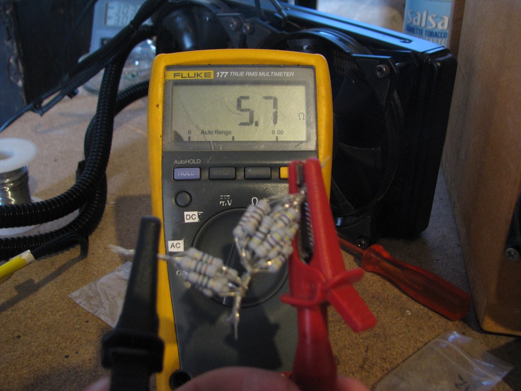

If you are able to output 6,7V RMS to a 4 ohm resistive load (not a speaker) that equals 11W of output power. There is no data on power dissipation in the datasheet for +-12V, but we can do an approximation from figure 35. (Attached). I am guessing that with 10W output power that the dissipated power is in the 5W to 10W range.
If the LM3886 can dissipate 7,5W power through the plastic to a heat sinc without hitting shutdown or activate spike protection we can calculate the thermal resistance assuming heat sink temperature is stable @ 45 degrees celcius.
Shutdown occurs at 155 degrees.
That is 110 degrees with a dissipated power of 7,5W. Thermal resistance is then 110/7,5= 15C/W.
Compared to the 1C/W through the "normal" way that is considerable worse and will add little to the total thermal performance.
Assuming no loss from the top-side clamp to the heat sink the total thermal resistance will be: 1/(1/1)+(1/15)) = 0,94C/W.
So in theory there *is* a little gain, but in my calculations there is a lot of "if's" and assumptions, so some real data would have been nice.
Anything in the range of 0,94 to 0,99 could be true.

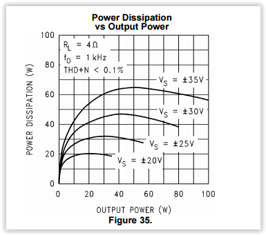

You can find the math in the data sheet or in a textbook such as Sedra/Smith, "Microelectronic Circuits". I've also included it on my website: Taming the LM3886 - Thermal Design. You'll probably also find the Excel worksheet at the bottom of the Taming the LM3886 - Power Supply Design page useful, as it does the math for you... 🙂
At ±12 V, 8 Ω load, the LM3886 will dissipate 4.8 W worst case (sine wave, Pout = Pout_max/2).
At ±12 V, 4 Ω load, the LM3886 will dissipate 8.4 W worst case (sine wave, Pout = Pout_max/2).
Above assumes an output drop-out voltage, Vod = 2.5 V, which is probably a bit pessimistic under these conditions.

3) It is a very bad idea to force so large dissipation on LM3886 for numerous reasons.
Depends on what you consider "large dissipation". I would reword your statement as: It's a very bad idea to operate the IC beyond the absolute maximum junction temperature specified in the data sheet.
With sufficient heat sinking, I have no problem at all dissipating over 40 W in an LM3886 regardless of package. At ±28 V rails, 4 Ω*load, the LM3886 dissipates 42.5 W under worst case conditions (sine wave, output power = half the maximum output power).
Recall, the dissipated power is mostly Dissipated = (Vsupply - Vout) * Iout. With sine wave excitation, it's relatively straight forward to calculate the maximum dissipated power. It does require you to take the derivative of a sine wave, so some fancy arithmetic is required. You can find the full derivation in Sedra/Smith and the end result on my website. The end result is in the LM3886 data sheet, though I seem to recall there being a typo in the equation. The dissipation graphs in the data sheet are correct, the equation is not.
~Tom
