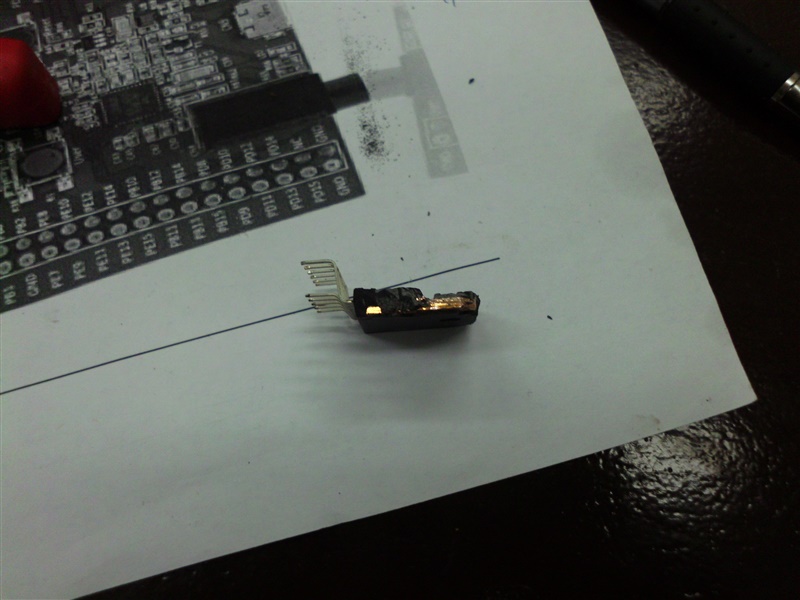

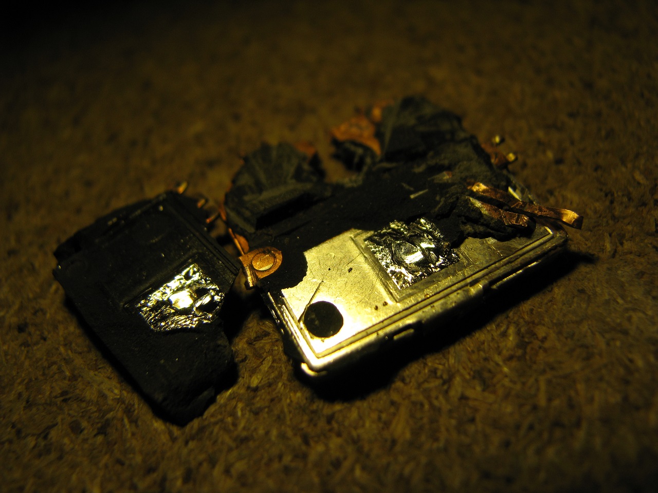

LM3886 Thermal Experiment (with data)
Just ruined one LM3886TF for you guys … Think a bit about your claims …
Thickness of epoxy from back side is about 0.5mm and from front side about 1mm …
I'm sorry Tom …
The final stage of our proof will be controlled experiment … Just be patient …
I'm sorry Tom …
I don't see the 1mm from the front side, only 1mm on the tab, which is not the die. So nothing credible. Plenty incredible. I await your results but not holding your breath.
I agree. If the thickness on the back is 0.5 mm, the thickness between the die and the top of the package (where it connects with the clamping gizmo) looks to be at least 3 mm.
It does look like someone's cherry picking their data to match their preconceived option.
~Tom

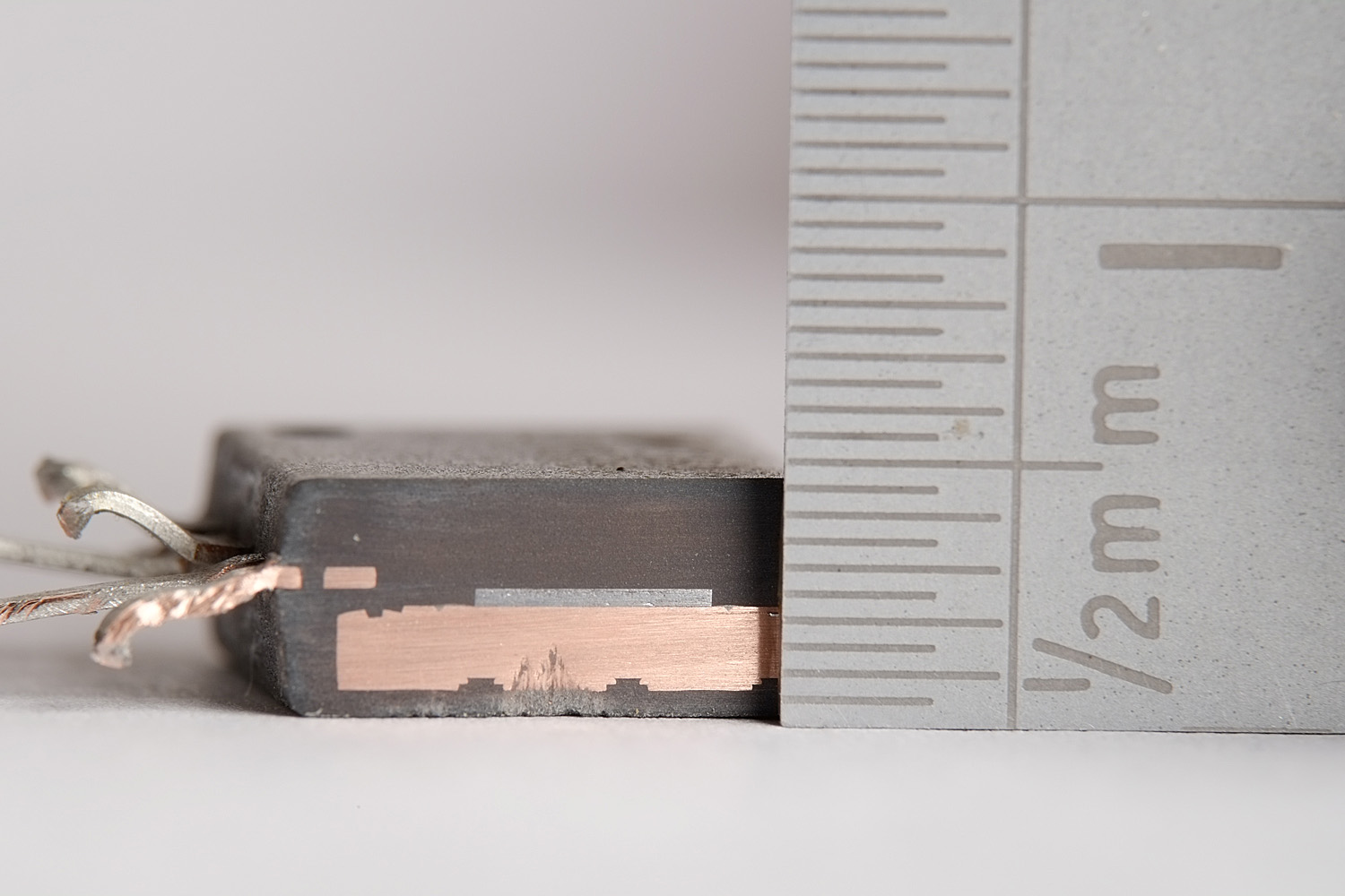

Warning: Science content!
Attached is an image of the cross-section of an LM3886. I took the LM3886TF and cut it in half with a hacksaw. I then polished it up with 400 grit sandpaper. The LM3886 was cut from a PCB, which led to the shortened leads.
The copper DAP is clearly visible (reddish metal). The light gray rectangle is the IC die. The dark gray is the plastic mold compound of the IC package. Copper dust from the sanding process has smeared across the plastic mold compound. The plastic does not have copper in it.
The thickness of the mold compound measures about 0.6 mm from the DAP to the back side of the package. From the top of the die to the top of the package, the mold compound thickness is 2.2 mm. Both measured using an electronic slide caliper.
The machinist ruler included in the picture as a scale indicator has gradations every 0.5 mm. The long line on the ruler near the top of the image, with the "1" next to it, marks 1 cm.
~Tom

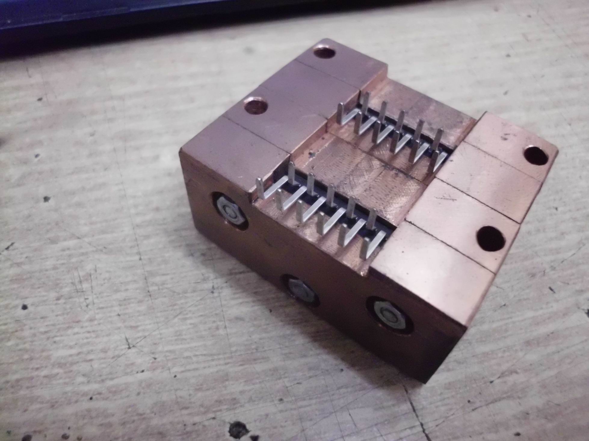

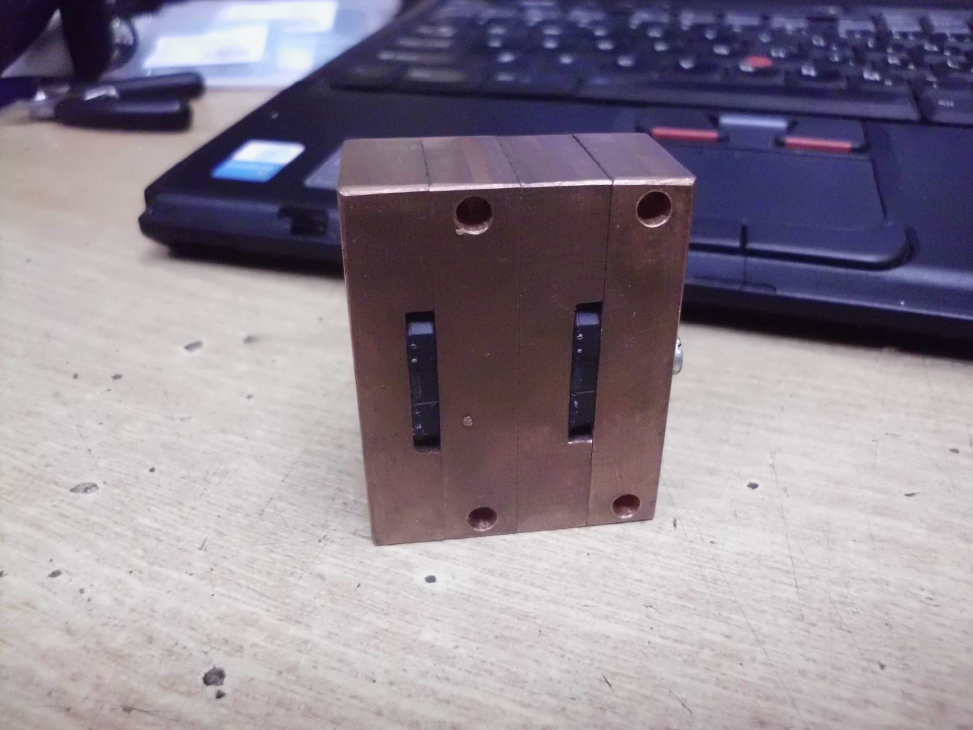

No problem.
Will see does this parts and whole implementation have 2K/W, that is only important question here. Will not talk about price or practical realization, it is out of this scope.
Macola call this parts "transient heat sink" and it is made from "electro-technical copper", material used usually for making electrodes for Electrical Discharge Machining - EDM, means very high purity in a range of 99.9% or more.
How do you plan to measure the difference between the "conventional" Rth j-s to compare to your special case of Rth j-s||Rth j-front-s?
Your original test was for the clamp sink to only contact the front face, leaving air as the cooling medium for the metal back plate. You could add 4.5mm of thermal insulation to the back plate and hope that the error this introduces leaves you with a result you can interpret as Rth j-front-s
No no, you probably get me wrong. That is really impossible to work.
This parts MUST be mounted on additional heat sink.
PS: I'm sorry for no so good written english language. You need to understand that english language is not my native language as yours.
