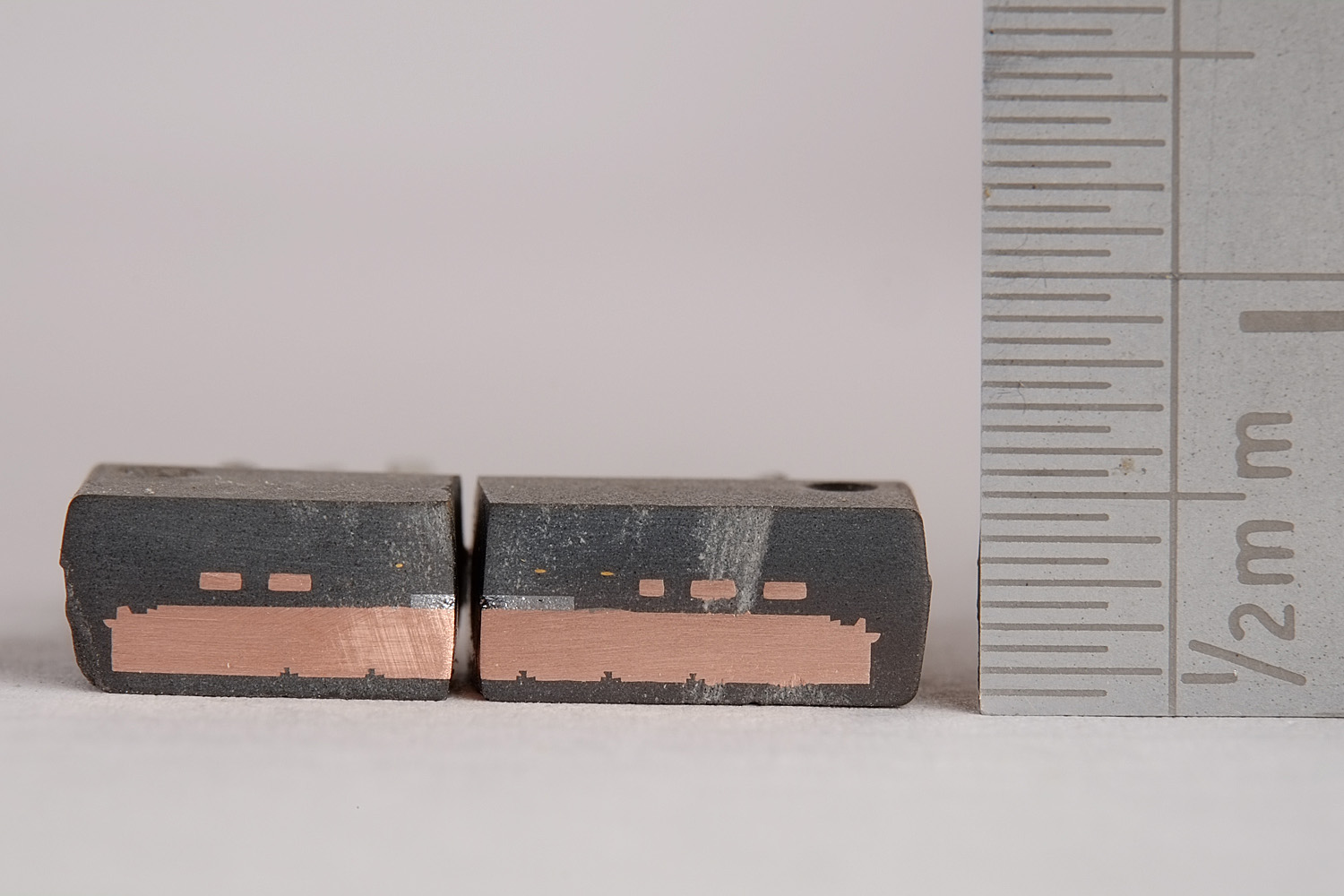

As promised the cross-section through the die, horizontally. That's the line C-C' in the diagram.
I had expected the copper DAP to be fragmented along this dimension, just as it is in the tab of the package. That wasn't the case, however. The copper goes all the way across the package. It ends about 1 mm from the edge of the package.
It's interesting to see how the leads are brought in, suspended above the DAP. It also looks like I just managed to nick a bond wire. Fun stuff...
It's too bad April 1st just went by. It would be fun to glue all the pieces together with super glue and start a "do you think my LM3886 is fake" thread... 🙂 :devilr:
~Tom

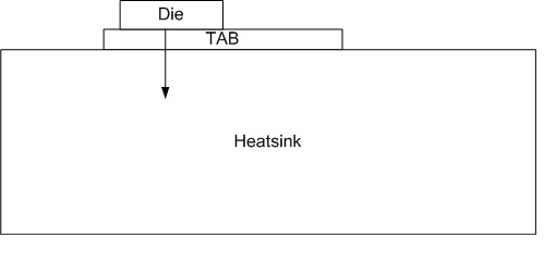

It's been a while since I did thermo analysis so happy to be wrong, but inspection suggests heat will want to flow from back of die out to heatsink by shortest path and not go sideways unless that is a preferential thermal path, in which case you have other problems.

I think you have missed what I was saying. Rapid sketch attached. Arrow shows direction I would expect max thermal gradient and therefore heat flow. To get out the top you effectively have 2 90 degree turns to make. If I had time I could test this by clamping a 3886 across the expoxy and cutting the tab off.
I could be wrong and happy for that to be the case here and it may be the 1D model works and you can assume equal heat flow from all metal surfaces (I use the T package)

Bill, in your drawing there is a vital part missing. The 0.5mm epoxy between the tab and the heatsink (For the TF). Since the copper transfer heat 800 times better than epoxy it will have the same temperature along the whole structure.

But you must have some kind of electrical insulation between the LM3886 and the heat sink? And certainly that insulation will have far more thermal resistance than copper. So again I suspect that DNi's point is true.
It is another thing if the LM3886T's tab is directly connected to the heat sink. Even soldered as suggested here earlier.. How is your connected?

We agree so far. Also as you pointed out, the copper will be isothermic (all the copper will be at the same temperature) as the thermal conductivity of the copper is much higher than that of the resin.
What is missing from your explanation above is how you calculate the thermal resistance from the copper DAP to the heat sink. If the LM3886 was sandwiched between two heat sinks, the thermal resistance to the back heat sink would be much lower than that to the front heat sink. No? Wouldn't this mean that the temperature gradient from the copper to the front of the package would be much greater?
~Tom
Thank you for your comments, Tom.
Your reasoning as to the LM3886 sandwiched between two heatsinks is correct. Since I need several lines of formulae and calculations to demonstrate my work, and the forum is text-based, I'll write a short note and post it as PDF document. So please bear with me until tomorrow.
