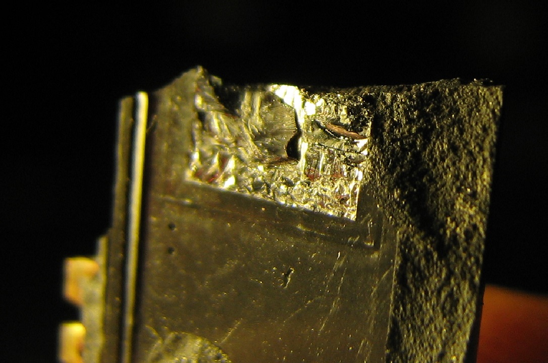

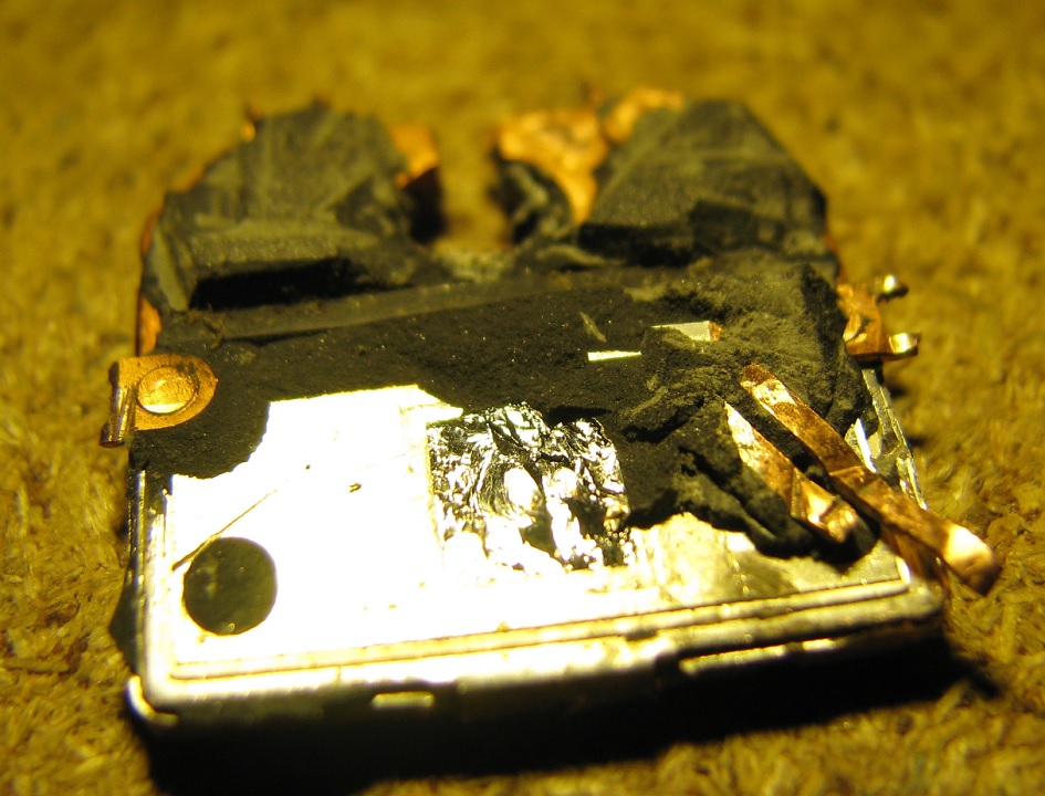

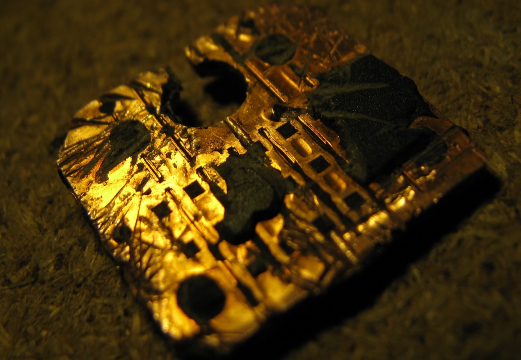

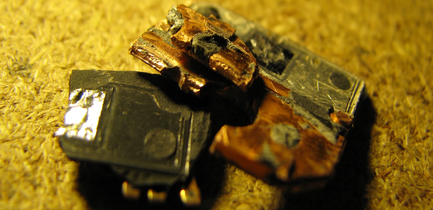

You are making the assumption that the tab is filled with solid copper. This is not the case, as I clearly shown in my cross-sections. You can have an LM3886TF X-rayed if you want to make sure, but I would not count on any meaningful thermal conduction through the tab.
~Tom
2,2mm holes on tab , same on bottom . tab is filled with solid cooper - two holes like on bottom, and there is some holes beneth die which are filled with this black thing you call epoxy. and wires that go to die are 1.5mm far from front of package
edit: second picture , is that die insulator or die itself?
Thank you for the photos tonitonitoni. I missed your post while I was writing.
Braca
Plus the hole and slot in the middle of the tab, right. The hole looks to be about 5 mm in diameter.
It looks like some sort of coating, but it's really tough to tell from the picture. It looks shiny, unlike the rest of the mold compound.

Gents, some notes on the package features.
The epoxy (thermoset) to metal interface bond strength is not a good one. Copper has a TCE (thermal coefficient of expansion) of 16.6 ppm per degree C. Below the glass transition temperature, plastics range from 90 ppm/C for unfilled varieties down to about 35 ppm/C. As a result, there will be large shear stresses between metals and epoxies, especially if the differential TCE is large. For pretty much all epoxies and thermosets, if one goes over the glass transition temperature, there will be a secondary TCE, this time much larger. Also, above the glass transition temp, the plastic becomes soft and loses much of it's lower temperature strength. I use this fact with superconducting magnets by selecting a hardener which provides a glass transition temp in the 45 C range. Rework becomes very easy for the techs as the temp required to soften the epoxy is not too hot to the touch, allowing the use of bare hands where delicate insulations are involved.
The copper leadframe for the parts being examined have a few features which are there to bolster the package integrity. Through holes are there to allow the plastic access to both sides so that the plastic is not relying on it's adhesion to the copper. On the edges, there will sometimes be an angular profile so that the plastic locks into the tab... For large assemblies, we would typically undercut the aluminum case so that the epoxy cannot slip out. At times, we also thread screws into the baseplate for the epoxy to wrap around, again preventing slip.
Cutting the package through on lines sometimes goes through one or more of these features, so without the overall leadframe geometry known, can lead to incorrect conclusions.
Historically, such undercuts were also used to help reduce flux intrusion, but I cannot state if this is currently done.
