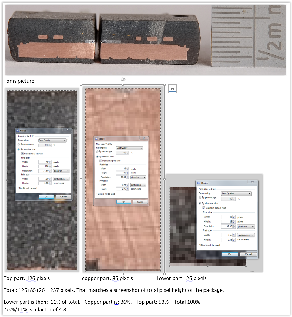

I am only looking at the cross section tom provided, with the ruler next to it.

I can clearly see that the copper is a lot thinner than the front covering of packaging plastic.
I would guess at thicknesses that add up to Dni's 3.35mm measurement as 1.86mm for the front plastic, 1.12mm for the copper and 0.37mm for the back plastic.
That gives copper to back as ~3:1 and front to back as ~5:1.
Looking at the cross-sections, that just about tallies with what I can see.
How Dni, could come up with measuring 3.35mm overall thickness and equate to 1.5mm:0.5mm for the plastic thicknesses, I can't fathom. It like using ears as measuring instruments.The epoxy thickness below the copper plate is 0.5 mm (hopefully no objections to that).
Your 5:1 ratio gives 2.5 mm for epoxy thickness above the 1.5 mm thick copper plate.
Summing the above three thicknesses gives overall tab thickness of 4.5 mm.
My 3:1 ratio gives overall tab thickness of 3.5 mm
Tab thickness measured with a digital slide caliper is 3.35 mm.

I broke down the picture to pieces in paint and counted pixels. According to that method I got a factor of 4.8 to 1.
You analyzed the wrong picture. We've been discussing the mounting tab structure, not the part where the die is situated.
My numbers for the part of the package you analyzed are 1:5.
EDIT: Skipping the percent calculations and using exact pixel numbers the factor is in fact 4.85:1. (126/237) / (26/237).

That was great, thanks for doing that, much appreciated.

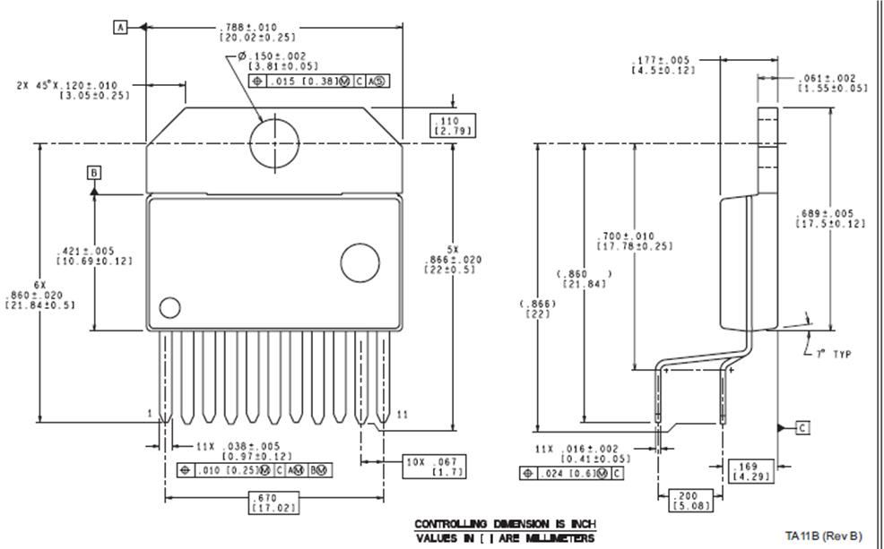

OK, I'm enclosing a sketch with the heat transfer areas defined in the text.
Tab is for me the surface with the red border. And A1+A2 is the heat transfer area at the back of the package, i.e. the contact area at the heat sink.
The lateral surface (blue-bordered) is marked by A3/2 to signify that there are two such surafces at the package.

Yes, it is a sketch based on the T package (didn't find a TF drawing), but it is only there for information about my partitionig of the heat transfer surfaces. My areas were calculated on the basis of dimensions measured on an isolated LM3886 sample I have.
