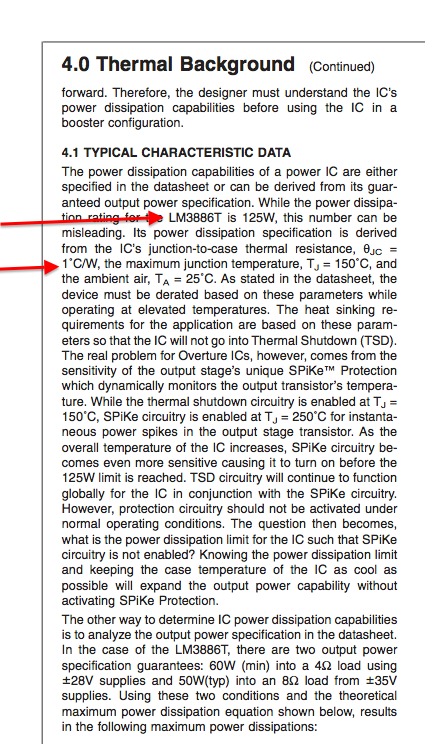

You are right, physics and math don't lie, BUT just one small piece of information here is missing or unknown to you, and that is "thermal resistance" with this cooling method
That doesn't matter. If the thermal R from die to heatsink is 2K/W and it dissipates 100W, the temp diff between die and heatsink is 200 degrees.
If the max die temp is 165 C for the protection to kick in, the heatsink temp MUST be not higher than -35 C. Whatever the thermal R of the heatsink is.
Jan
Gee... That sounds familiar: Post #222.
~Tom
