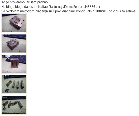

Just got some "cool" info from author (Macola) of those "controversial" metal parts for additional cooling of LM3886.
Take an look on picture …
attachment.php
It was checked because I have tried.
I would not be me if I did not examine what most can do a couple of LM3886🙂
With this method of cooling the chips dissipate continuous 100W !!! per chip for hours!
You can believe in that or not, it is up to you. I believe them EVERY single words they say or write on our forum.
More readings on this link (Serbian language, try with Google translate):
Bato MM-Amp (LM-most by macolakg)
