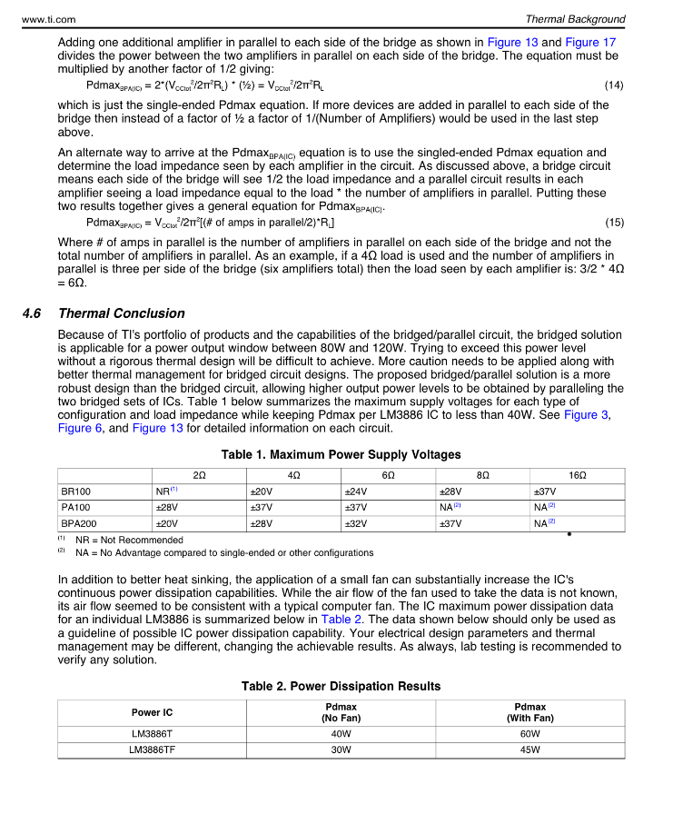

Hi Guys,
is it possible to bridge - mono with 2 or more more super gainclone for subwoofer amp preparation. if possible give me information.

All the information you need to answer that question is here: LM3886 Output Power
Tom
Parallel
When two amplifiers are connected in parallel they share the load current. Another way to put this is that each amp half “sees” twice the load impedance. This means two LM3886es in parallel driving a 4 Ω load follows the “8 Ω math” above. Hence, two LM3886es in parallel can drive a 4 Ω load when operated on a ±35 V power supply. In this configuration, the total output power is 100 W (4 Ω) and 60 W (8 Ω). Up to 40 W is dissipated in each LM3886 in this configuration and they must be properly heat sunk to be able to deliver the full output power.
Do note that when connecting two LM3886es in parallel, ballast resistors must be used to ensure that the two LM3886es share the load current evenly. Also note that the input voltage offset difference between the two LM3886es causes a standing current to flow through the ballast resistors. This standing current must be minimized to avoid excessive THD even at moderate output power levels. To accomplish this, the input offset of each LM3886 must be minimized, preferably using a DC servo thereby increasing the complexity of the circuit considerably.

you could bridge lm3886 in pairs. For 4ohms loads you should have less than + -20v DC.
