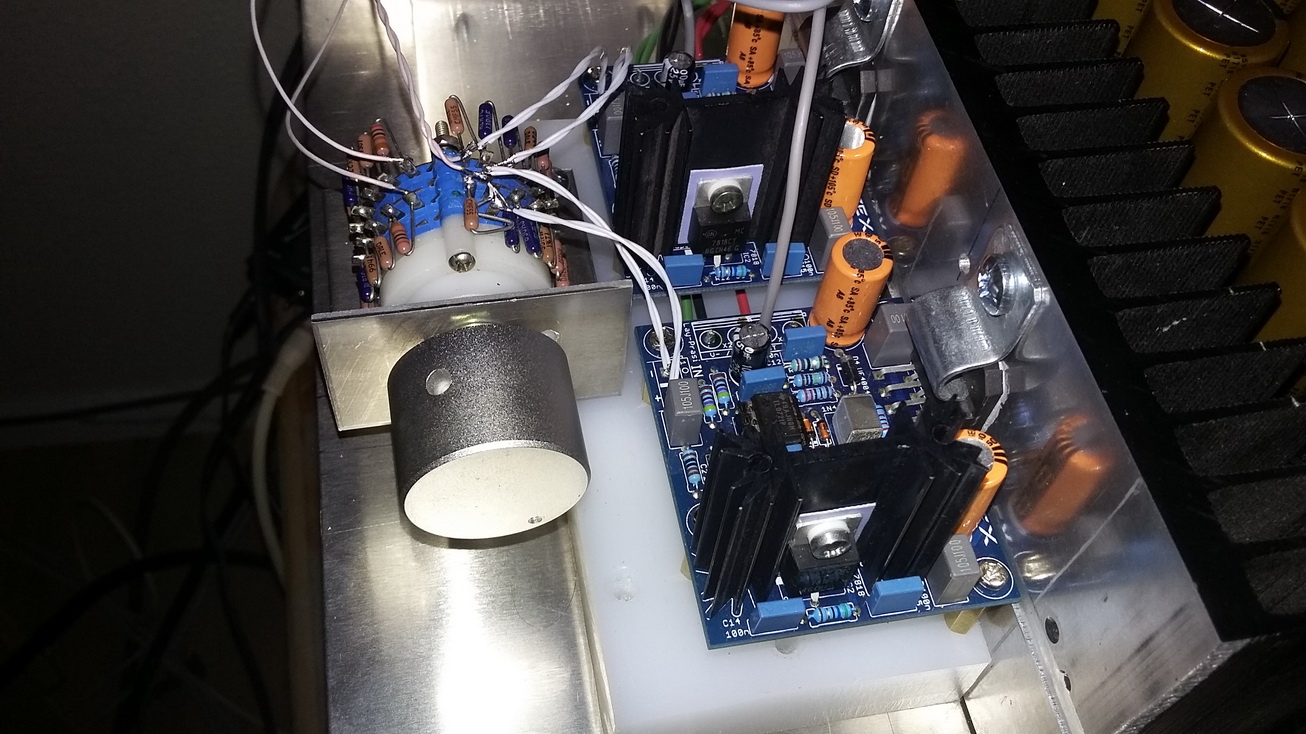

Up and running. So far works good. Fired right up first try with no issues. Here are some pics!

assembled 1 channel to see how it sounds. powered up fine without glitches first time.
Sounds very good on test speakers, used a opa2134.
here are the pics. Thanks Mr. Mile for the circuit. Am I the first one to test this particular ckt?
I might put this one in my boom box that currently uses a dayton DTA-2 class T amp.
regards
Prasi

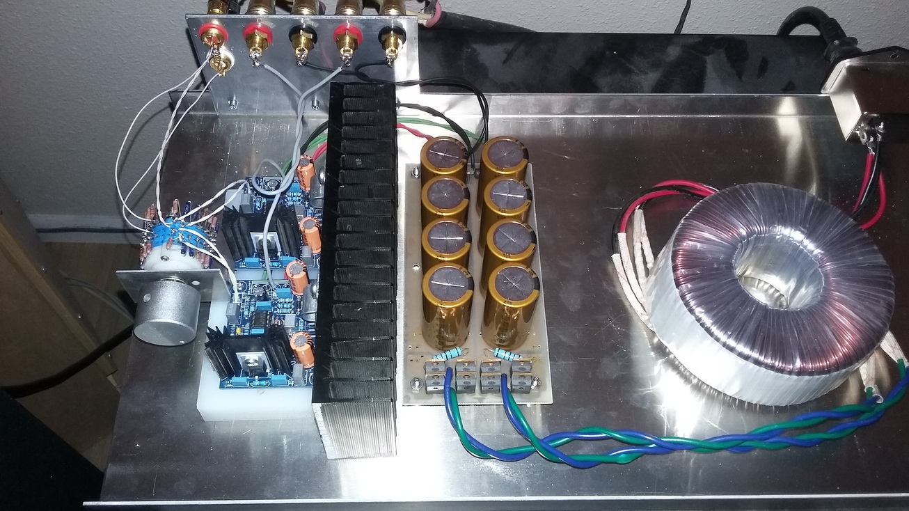

PSU
Hi Bender460,
can you post the PSU image and design.
Thanks,
Nandhakumar
Getting going on a APEX Super Gainclone. Purchased some boards and parts from prasi a while back. He put together a great kit for me. Really really good. Thank you prasi.
Second pic is of the power supply that will be next to put together. Hopefully in the next couple weeks I'll post pics of a finished amp.
