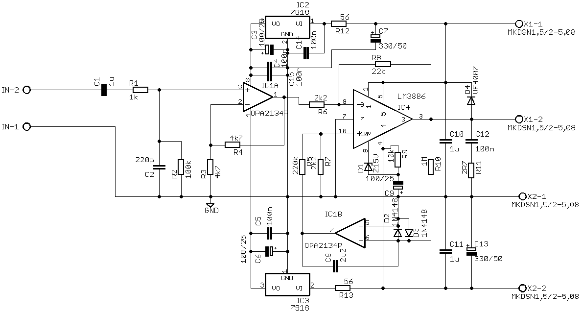

Rgulated PSU can be use for 28V but zener diode 20V must be replaced with 5,6V zener.
Have u tried original apex gainclone ver.1?+/-28V for 4 ohm and you can go upto +/-35V for 8ohm.

I want to use 25-0-25 CT trafo.
Need any changes? Plz reply. Regards.

I have seen a lot of designs of LM3886/3875 but there are two opinions - one claims that these "Chipamps" are "rugged" and safe to use without speaker DC protection circuit. Mr. Mile loves rugged designs and always (99%) uses DC protection in his designs, but in this design I do not see it. Why?
Other claims that it should be used without compromises.
What is Your opinion/experience?
It's very unique i think. Without output inductor!Apex ver 1.0 is very nice, so is apex super gain clone.

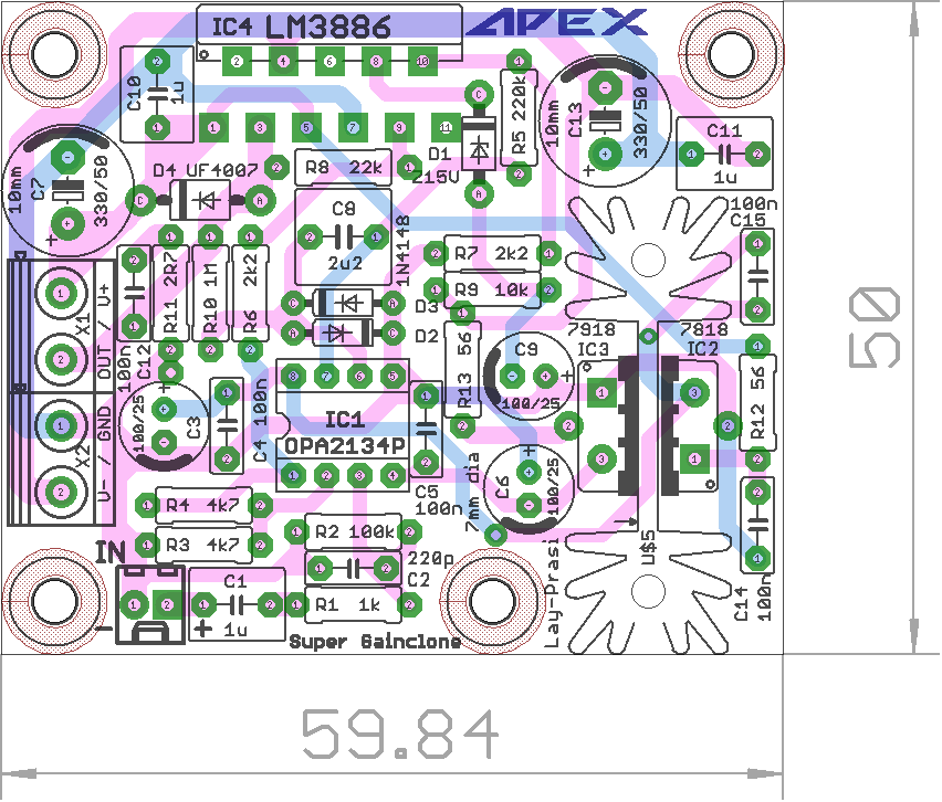

Here are the schematic, stuffing guide, pdf's and gerbers for anyone willing to try🙂.

Hi Prasi, for the final PCB that you tested, would you mind sharing the gerbers and stuffing guide/schematic? Thank you for considering.Finally PCB's came.
sure , here they are.
All the best for your build.
I also have a single sided version(untested), if you are interested, posted previously.

schematic as built.

I'm interested in the single side SGC (untested ) layout if you still have. I'm trying to get a Cordell amp up. I've also posted a possible design asking for advice, it includes the Klever Klipper!

The single sided SGC is posted in post # 245 LM3886 Schematics + PCB
I have posted both gerbers and pdfs. I dont have the boards myself.
You could etch them yourself with pdfs or simply order the boards from pcbway.
