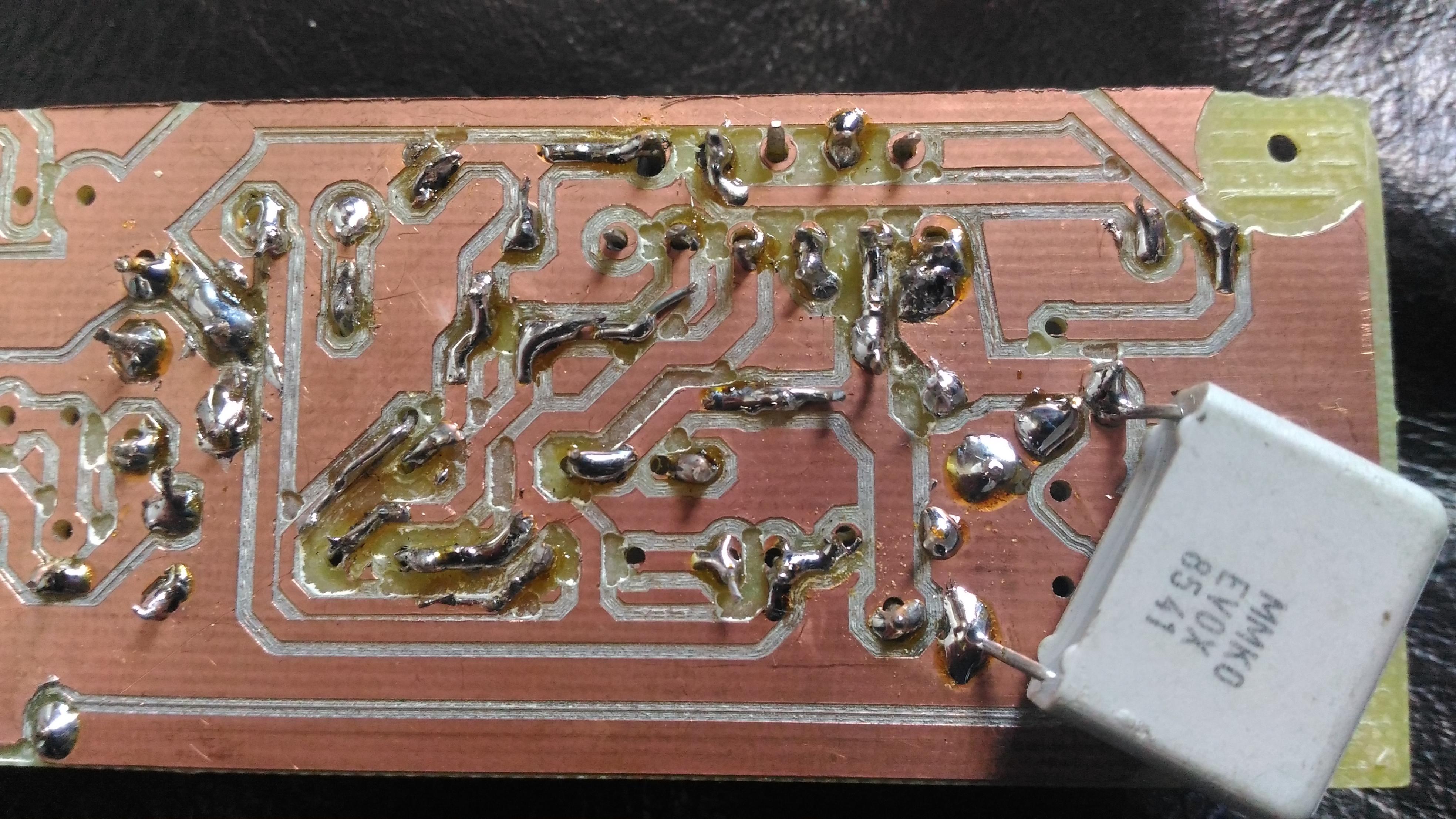

I have build one of the stereo boards with the addition of a ground plane, from the gerbers posted in this thread but the chip oscillates badly with load or no load. Ground plane is on the bottom, it was double sided board so top does not connec to anything.

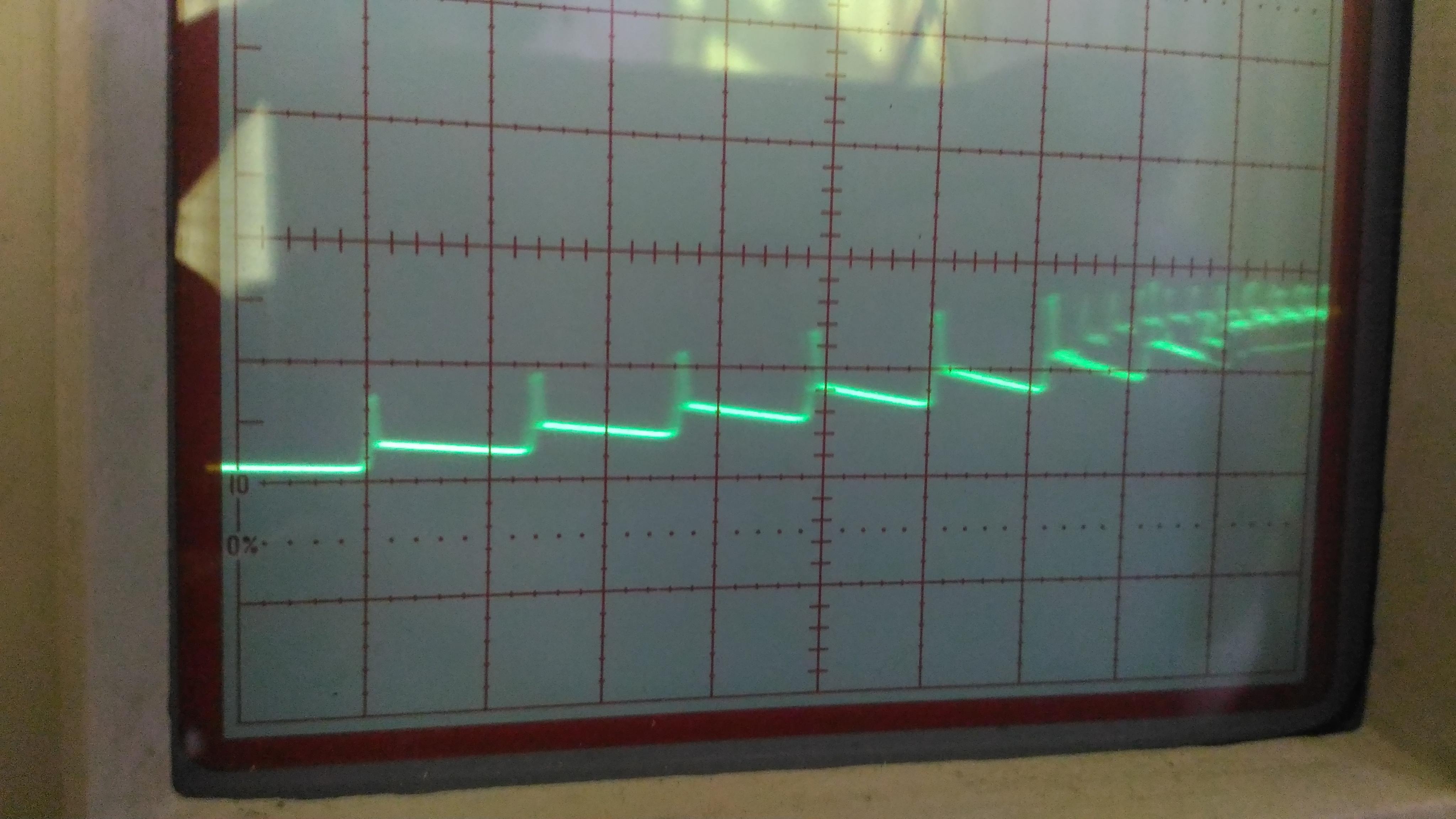

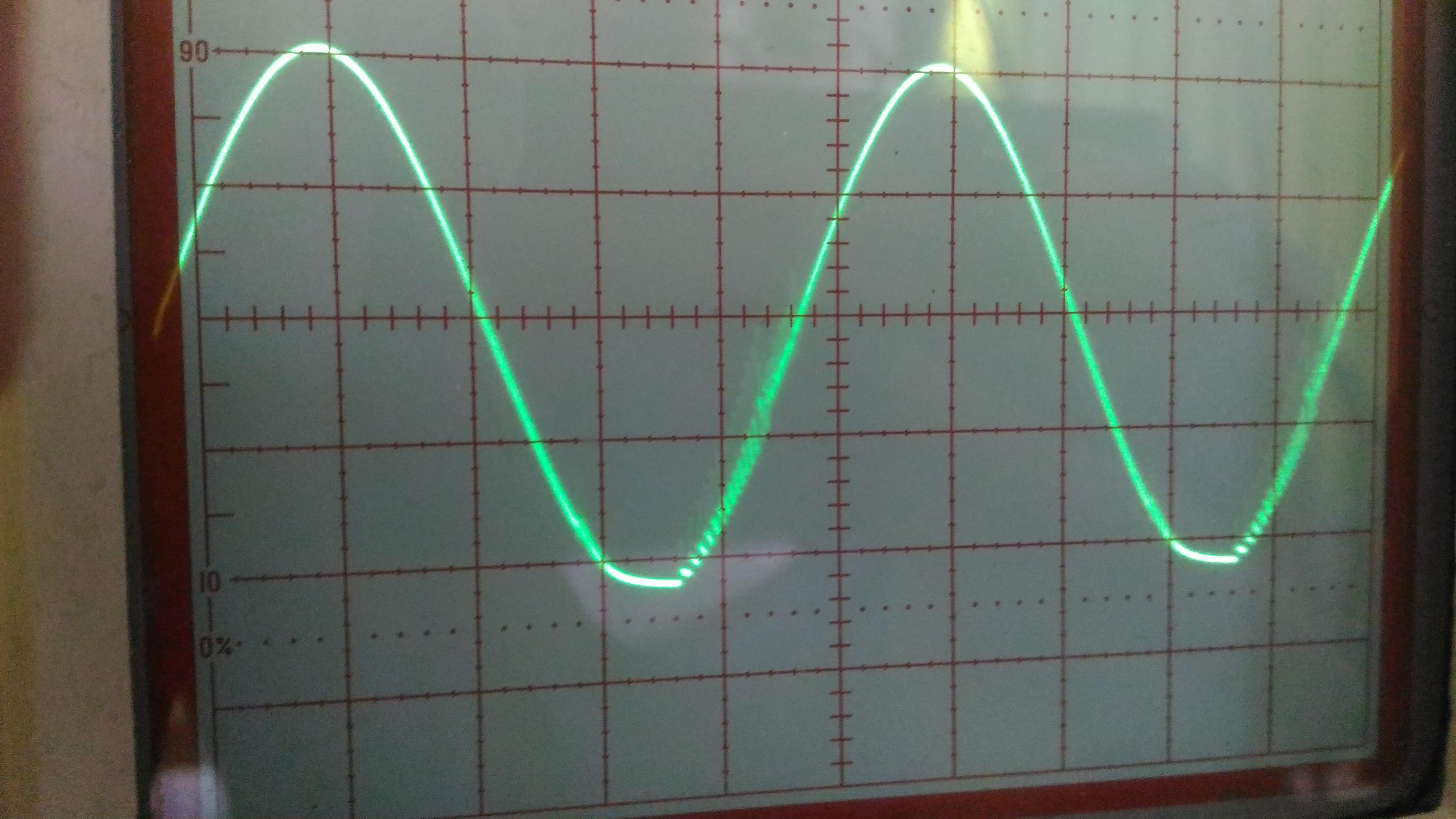

See attached for 1KHz input signal and associated oscillation. Used parts I had lying around, all values are correct but some of the footprints didn't match, the Zener is 15V. Can anyone please help?

Have you fitted the MF and HF supply rail decoupling?
Have you fitted the Output Zobel Network?

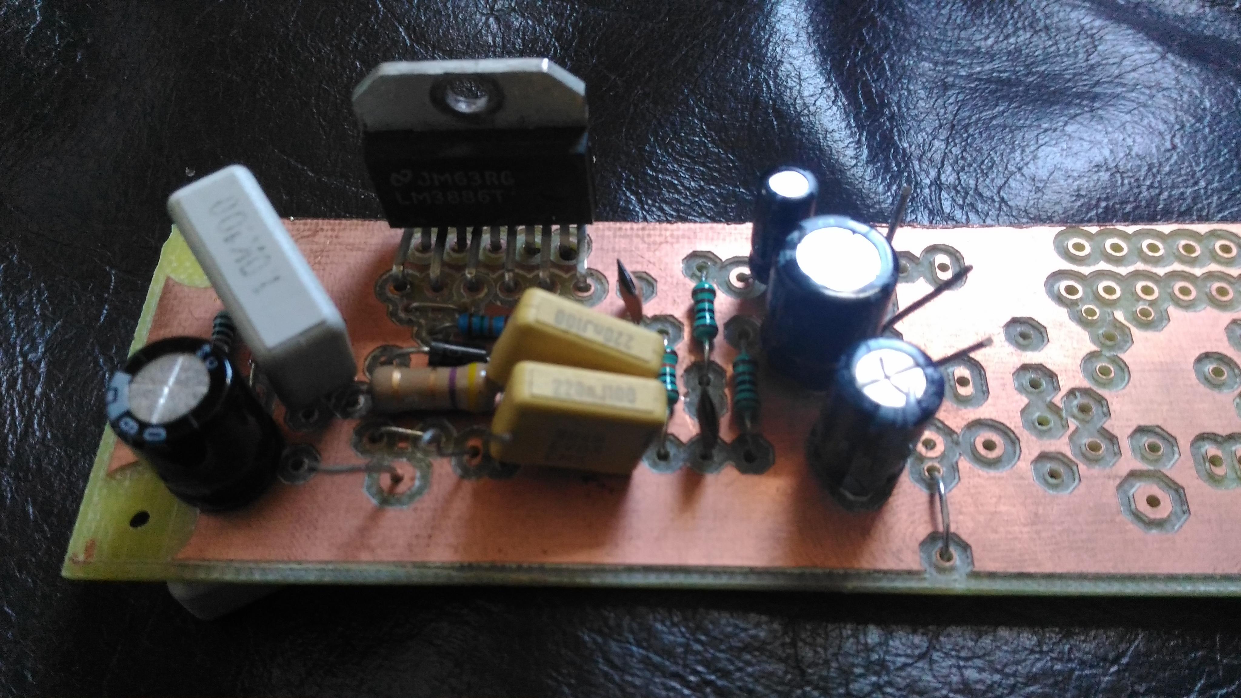

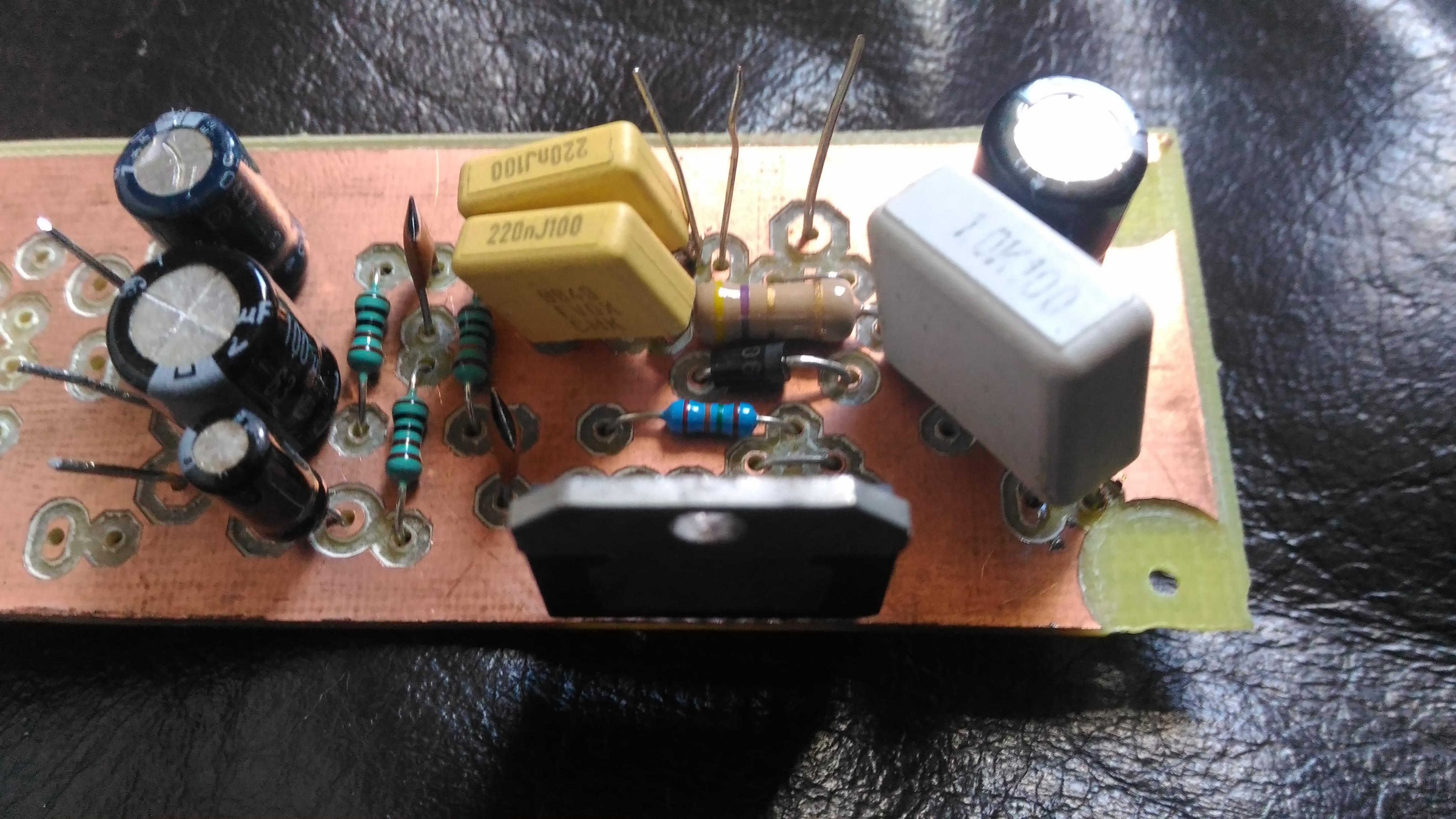

I have built one channel exactly as it is on APEX's schematic, I am testing it from a regulated DC bench supply. The 4r7 and 220n zobel is on the board.
parasitic capacitances ?Prasi it is the same board you build based on the PCB by Bimo, but I added a GND plane.

I honestly don't think it would be the ground plane, especially since in this case all it really did was to thicken out the 0V track to the outer edge of the board where all the 0V connections lay. It didn't really add any extra copper near to other connections as the board density was already quite high. Basically the majority of the PCB didn't actually change at all.
Anyone have any ideas what it could be? Possible fake IC's? I *think* these were from Farnell though. Have tried a different bench PSU too and same effect. If nothing surfaces in a few days I'll try scrubbing some copper islands off with a dremel but I'm not hopeful.

the jumper near ic pins is precariously close to 'spk out'.
also check if both 1uf caps are connected to ground.

The "ground plane", is it connected to 0V and used as a ground plane or is it just a copper layer not connected to anything?

The ground plane is just a polygon fill of space around the board on the bottom connected to 0V. I forgot to remove islands though so there are a few bits of floating copper which you can see the in the photos.

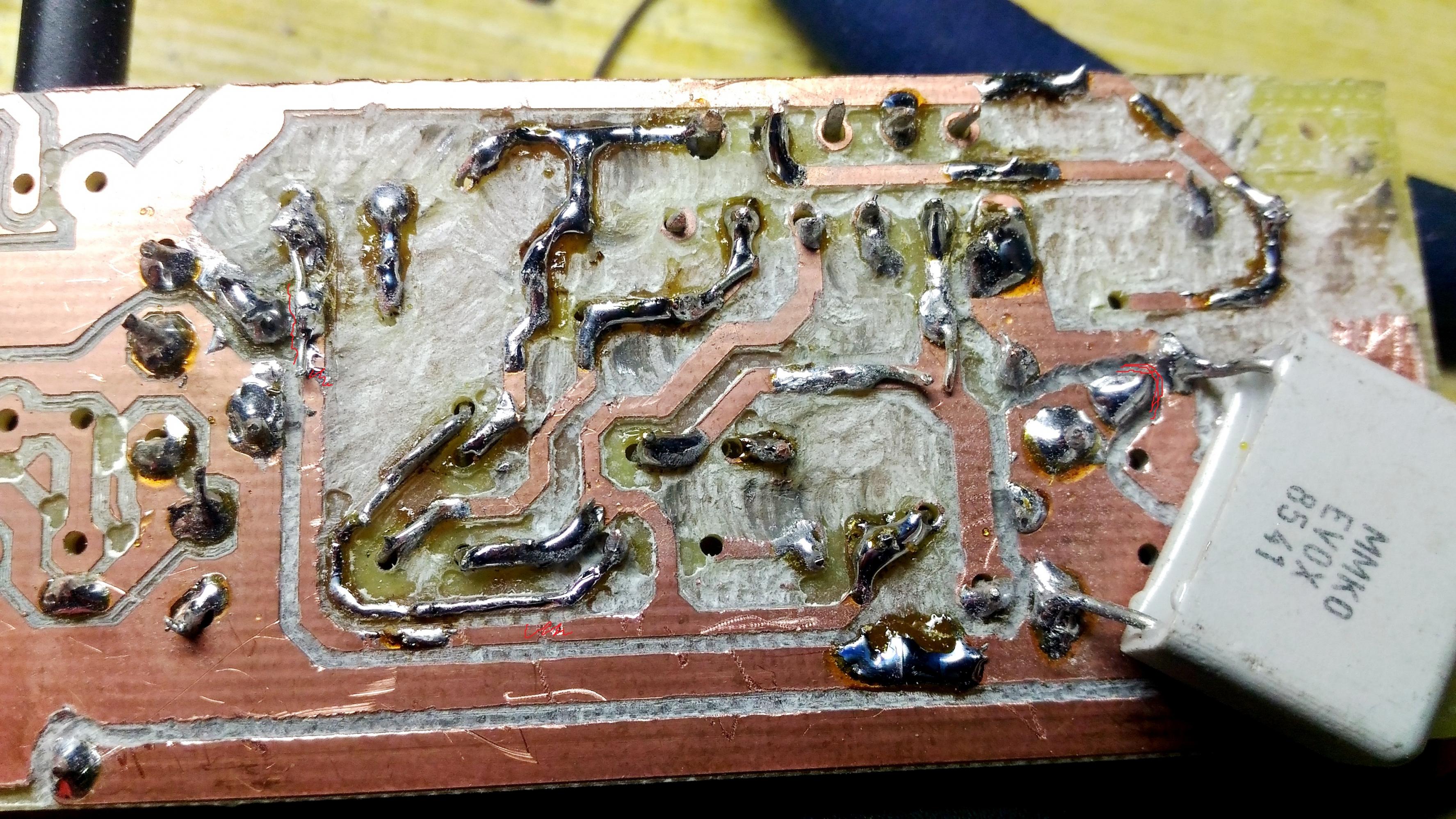

Hi all,
Have finally got round to taking a dremel to the board and taking off the copper islands. Some parts got caught a bit but none were severed so went over them with solder. I've checked there is no connection between the top remaining copper and any component connections.
I have put some red squiggles over suspect parts that are actually okay which I've checked.
The amp STILL oscillates just the same with no load!! 😡 😡
Any suggestions before I try another chip?
It's nothing wrong with the chip. I think you have problems with the grounding and the power supply decoupling. Do you have 35 um copper on the pcb?
