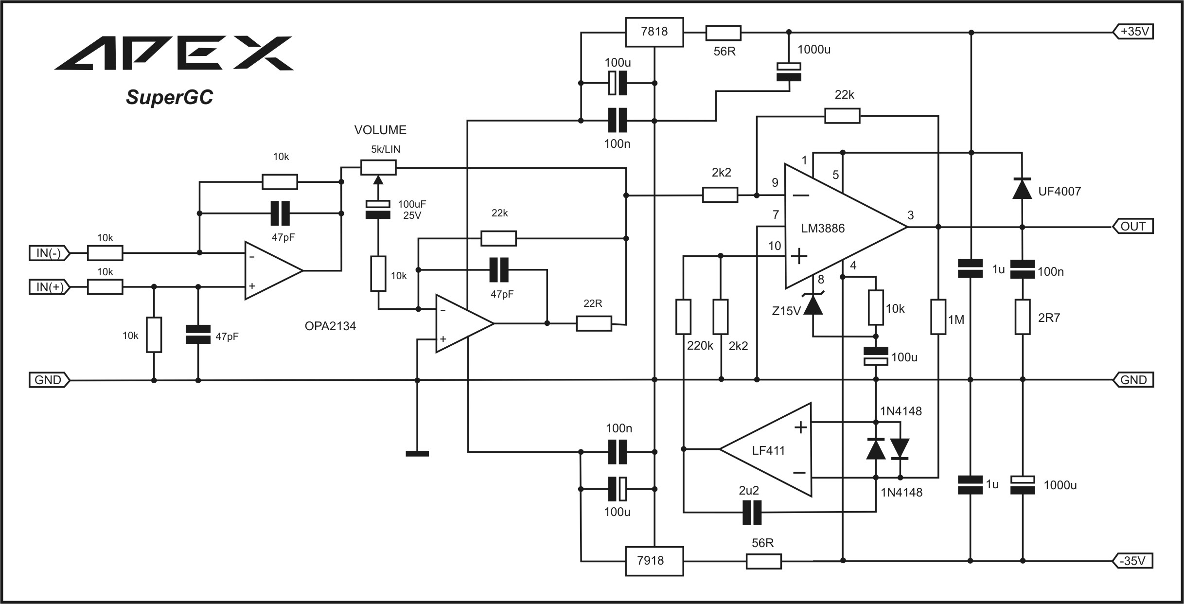

Apex Super Gain Clone (in stereo)😀
Mr. Mile, any comment?

APEX SuperGC with balanced input and active volume control.
That's actually not balanced.

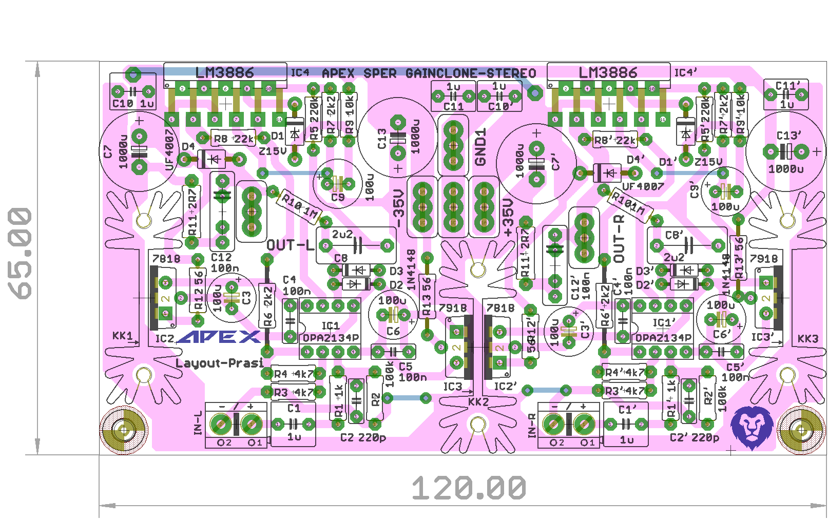

Nice, you don't need separate +/-15V regulators.

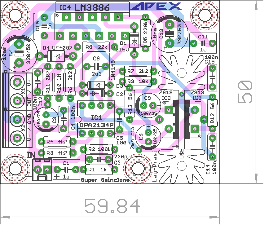

If anyone wants a quick try with pcbway for 5usd for 10 PCB with 12usd shipping, here is the 2 sided PCB for apex super gain clone. 50mm x 60mm.
Rail caps are 10mm dia and other 100uf electrolytics are 7mm dia. All film/ceramic caps have 5.08mm pitch.

PCB's ordered🙂. I want to try out of just out sheer nostalgia, because I had begun my amp DIYA journey through APEX LM3886.
If anyone wants to book PCB, contact me through PM. I will have total 10 available, 8 can be spared. Pl note it will be shipped as soon as received and not after testing. After all its DIYA, so better to have fun while it lasts!😀.

All 8 PCB's interest booked by people (in less than 1.5 hours!). D@mn, I could have ordered some extras if i had known before , but hats off to Mr. Mile for a design thats so much appreciated, that people would like to try even untested.
Mr. Mile, dont know how you are able to produce these designs !!

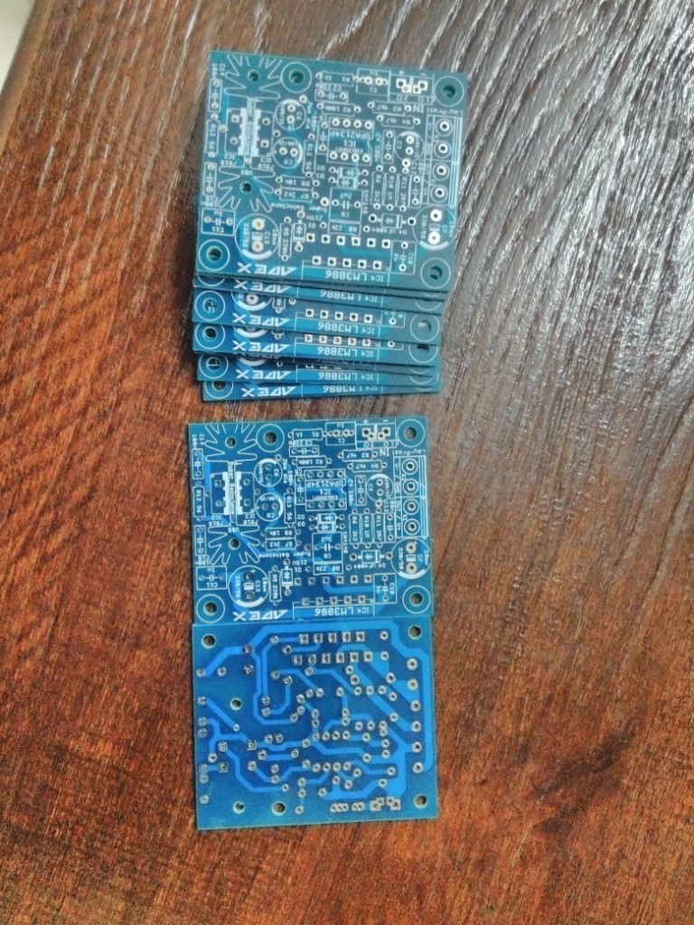

Finally PCB's came.
i have components procured too, from a local store here. i plan to use TL072 instead of OPA2134 as they are not available here.
ready to ship out, those who have booked, pl pm me with name, country, paypal, shipping address, postal code.
