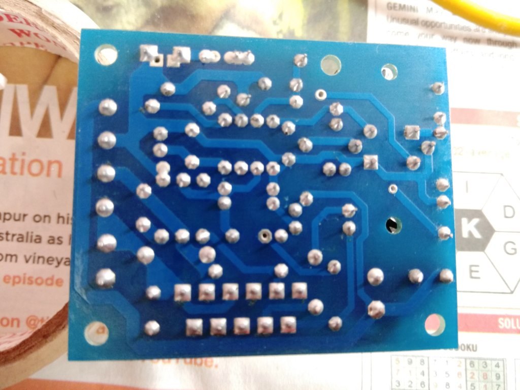

If anyone wants a quick try with pcbway for 5usd for 10 PCB with 12usd shipping, here is the 2 sided PCB for apex super gain clone. 50mm x 60mm.
Rail caps are 10mm dia and other 100uf electrolytics are 7mm dia. All film/ceramic caps have 5.08mm pitch.

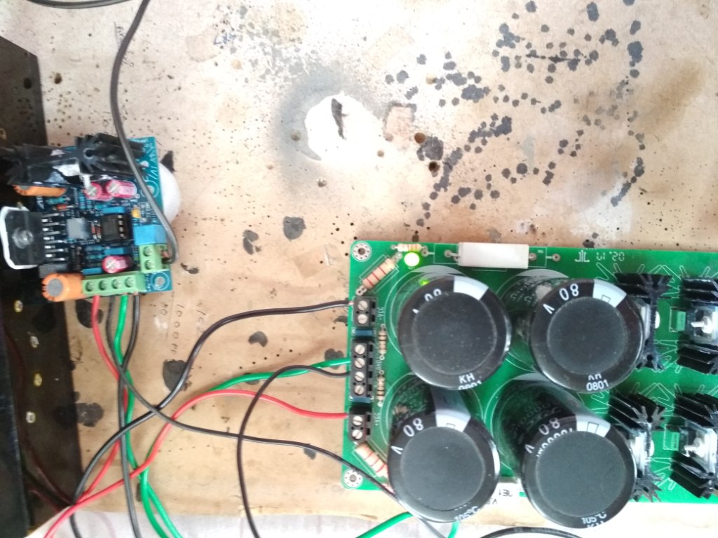

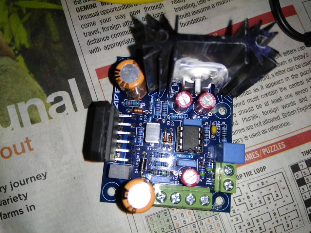

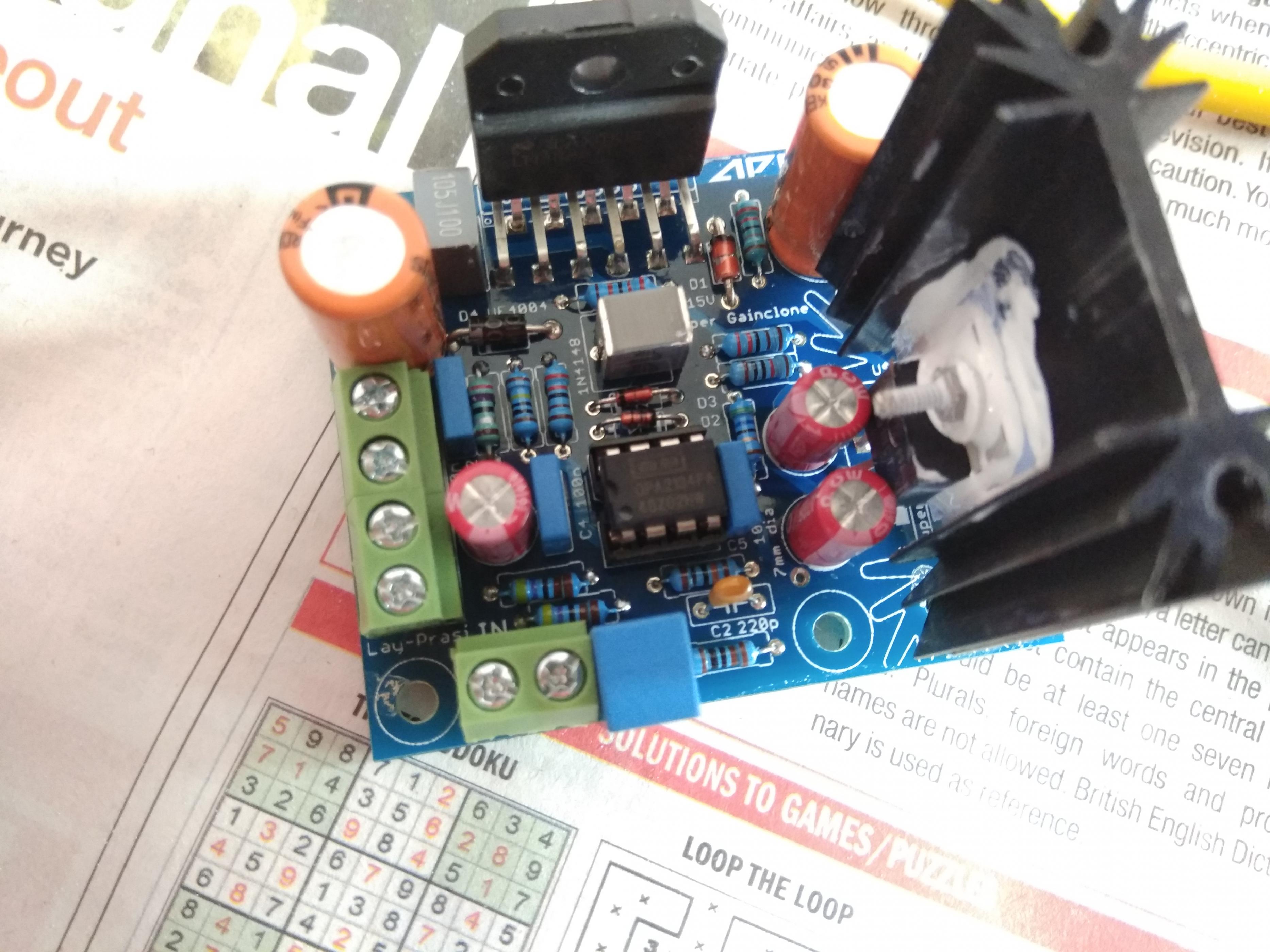

assembled 1 channel to see how it sounds. powered up fine without glitches first time.
Sounds very good on test speakers, used a opa2134.
here are the pics. Thanks Mr. Mile for the circuit. Am I the first one to test this particular ckt?
I might put this one in my boom box that currently uses a dayton DTA-2 class T amp.
regards
Prasi

Dear Mr. Mile (and other members),
I have seen a lot of designs of LM3886/3875 but there are two opinions - one claims that these "Chipamps" are "rugged" and safe to use without speaker DC protection circuit. Mr. Mile loves rugged designs and always (99%) uses DC protection in his designs, but in this design I do not see it. Why?
Other claims that it should be used without compromises.
What is Your opinion/experience?
Boucherot resistor of apex gainclone 1.0
Boucherot resistor 4R7 1watt or 10R 0.5watt?
What should i use? I am newbie....so please explain in detail friends.
One more question....
how much supply voltage & current will be good for 8ohm & 4ohm load?
Regards.
if the stage ever tries to output a high proportion of high frequencies, then the Output Zobel passes much of this and the Zobel resistor gets hot.
If you test using 10kHz (or higher) squarewave you will probably burn out a 1W Zobel resistor whenever you turn up the signal level.
For testing purposes you need at least 3W and preferably >=5W

The parts list and pcb top(apex gainclone 1.0)
has two different value resistor.
Parts list--4R7 1watt
Pcb top--10R 0.5watt.
