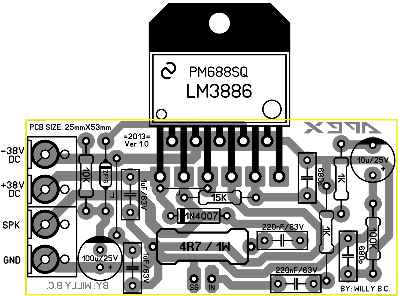

Oh... Thanks Mr. Apex for the quick reply. One more question, with reference to post no. 1 of this thread, Can PSU circuit (4700uF caps and rectifier) be integrated on the same PCB as that of LM3886? I would also like to integrate the sub crossover given in you mic, line, eq " thread make it as a sub plate amplifier, will it work? are there any foreseeable design issues? I will make a pcb in eagle and post it for everyone's' approval.

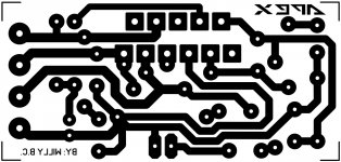

See my PCB for the power supply

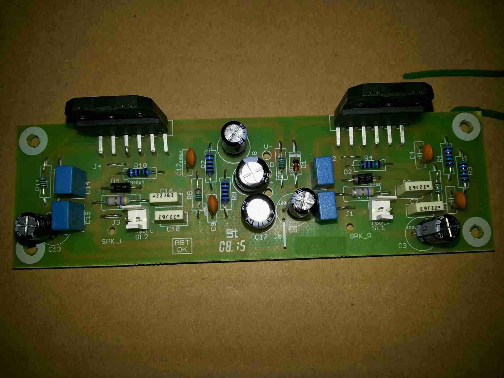

Hi Bimo and others,

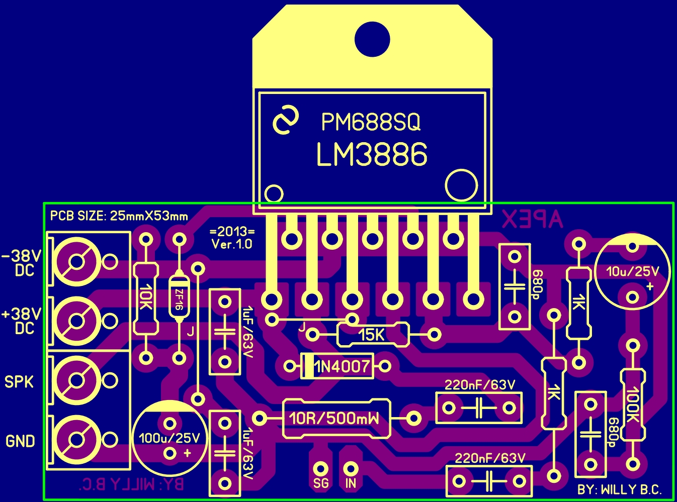

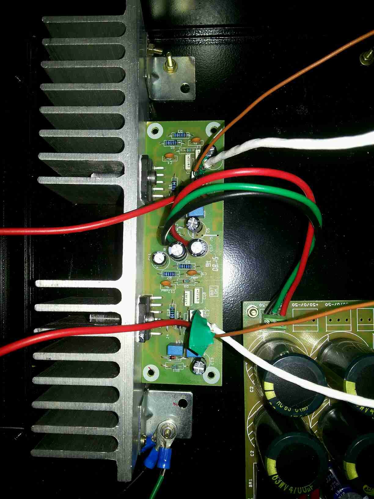

I built apex gainclone amp based on the pcb created by bimo (post 231) . when i connected the input, the sound is very distorted on both speakers. when I connect a wire from signal ground to main chassis ground, the sound is nice but coming from only one speaker. I tried a lot of things, but result is same. can anyone help me identify the problem?

if theres no sound coming from 1 channel,check all your connections and caps placement especially for the electrolytics,diodes and traces,also check if your lm3886 ic is not yet busted.
Hello drahcir,
Thanks for the reply. I have checked all connections and cap placements they are as per the PCB. diodes are also as per layout. I know that the signal ground and power ground already connected on the PCB through a trace. The funny thing is, when I do not connect an additional ground wire from signal ground to main chassis ground, the sound comes from both speakers, but is very distorted. Does this mean that the both IC's are functional. However, when I connect an additional wire from signal in ground to main chassis ground, the sound improves but comes from only one speaker.

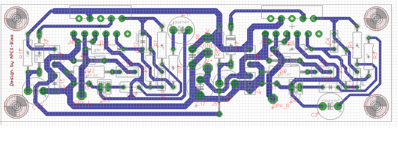

The IC's are from TI samples. coud there be a grounding issue? I am attaching here with the layout of the PCB created by Bimo (post # 231).

can you also post the psu board?sorry im using my mobile to read but how does the board you're using uses 2 speaker return(-)? or only 1 for both channel?
Hi drahcir,

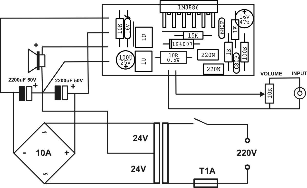

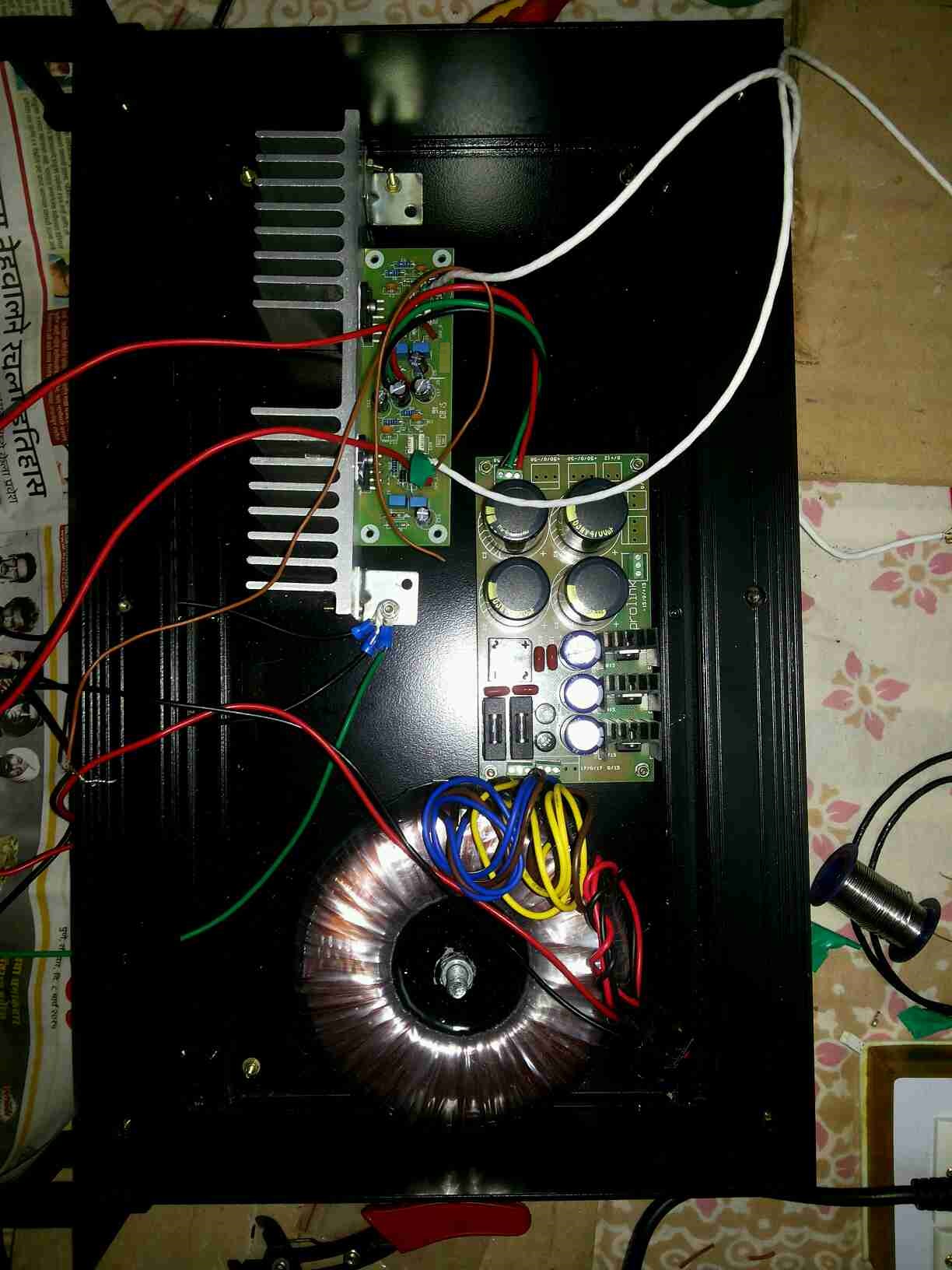

Speaker SPK_L and SPK R are the speaker positive. Speaker return wires from both channel go to the main star ground on chassis. Here is the set up.
1. Transformer : 300 VA with single 24-024 out put
2. PSU : 10 amp bridge rectifier with 4x 4700 caps
3. stereo AMP as above in post # 437.
right now I am not using any tone control. signal i/p is directly connected to the amplifier PCB at SL1 and SL2.
The PSU is commercial and hence do not have its lay out file.
The wiring scheme is as follows.
1. Power comes in through an IEC 3 pin inlet.
2 . Both Line and neutral are connected to a switch but AC line goes through a fuse .
3. Transformer is connected at the switch outlet.
4. transformer out put 24-0-24 is connected to the PSU
5. 32-0-32 from the PSU is connected to the amplifier PCB at V+ , GND and V-.
6. SPK_L and SPK_R is connected to right and left speaker positive.
7. Signal in and signal gound is connected to the amp PCB at SL1 and SL2 (see post# 437).
8. speaker returns from both channels (back wire) is coonected to the chassis ground (star)
9. A wire from chassis ground is connected to the earth pin of the power inlet.
where I am making a mistake ? or what could be isssues with grounding?

Hi All,
Problem solved.
It was a mistake from my side. I had not connected the J5 (jumper) on the PCB. It is such a foolish mistake and is obvious in my own post #433 (center image). There was no V+ supply on left channel because of this.
After connecting the J5 and improving the grounding scheme, The amp is churning out amazing sound with no pop at start-up and without any distortion.
Improved grounding scheme is as follows.
1. A cable from chassis ground point (star) goes to earth pin and this connection is permanent.
2. speaker returns and amp ground wire go to the PSU ground
3. A wire from PSU ground goes to the star ground
does anyone have any comments on the above grounding scheme? is it safe?
it seems to be working fine with no hum. the amp is very quiet when the source is connected but without any music being played.
Also I measured the DC offset (voltage between speaker positive and chassis star ground) when speakers are connected without any music being played. It is around 10mV and 11mV on left and right channels.
