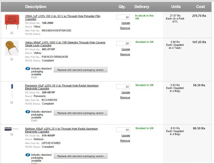

Hi all,
I am planning to build an amp with Apexaudio circuit and I am about to order the caps and resistors. Since I am a beginner, could someone tell me if the parts (as given in the attached images) are of adequate/correct specs? I dont really understand the different types of caps , hence need some help in choosing the correct components.

The Y5R is probably wrong.
What is it for?
The 25V 100uF may be OK.
What voltages does it operate at?

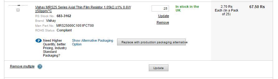

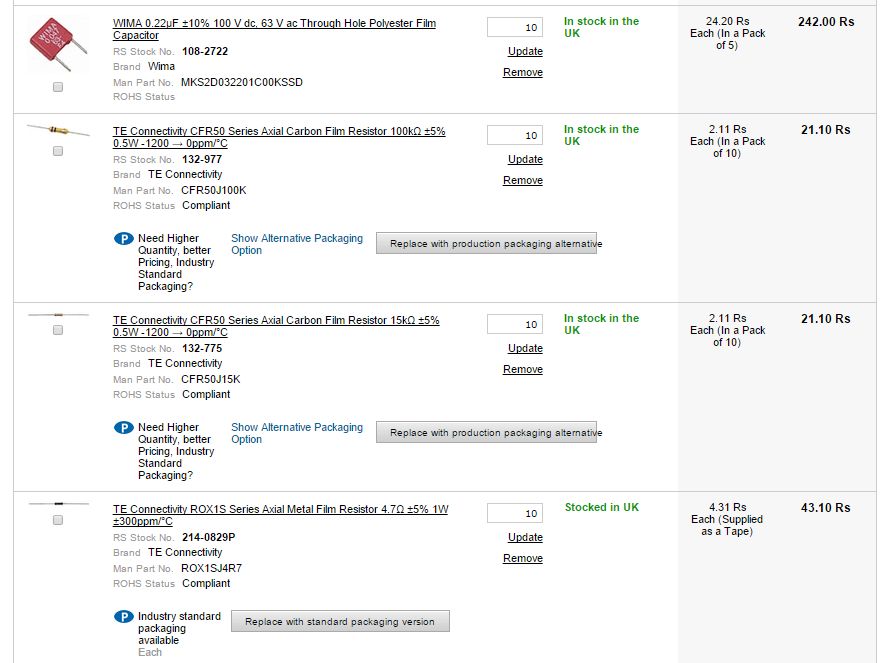

Carbon film resistors are generally not suitable. Metal film are better and as a second choice Metal oxide.

Hi Andew,
Thanks for the reply. even I feel that the Y5R specs are wrong 1000V?... its for the 680pF caps as per the apex audio schematic on page 1 of the thread. I will try and see if I can get hold of metal film resistors.

The sch does not tell me which is the 680pF !
I'll guess, since you didn't tell me either, that the 680pF is the RF attenuator capacitor C2
This can be a silvered mica, or a polystyrene, or a polypropylene, or a NP0/C0G ceramic. I would choose either a polypropylene, or an NP0.
Now show me what the duties and operational voltages of the other capacitors are and I will try to guide you.
