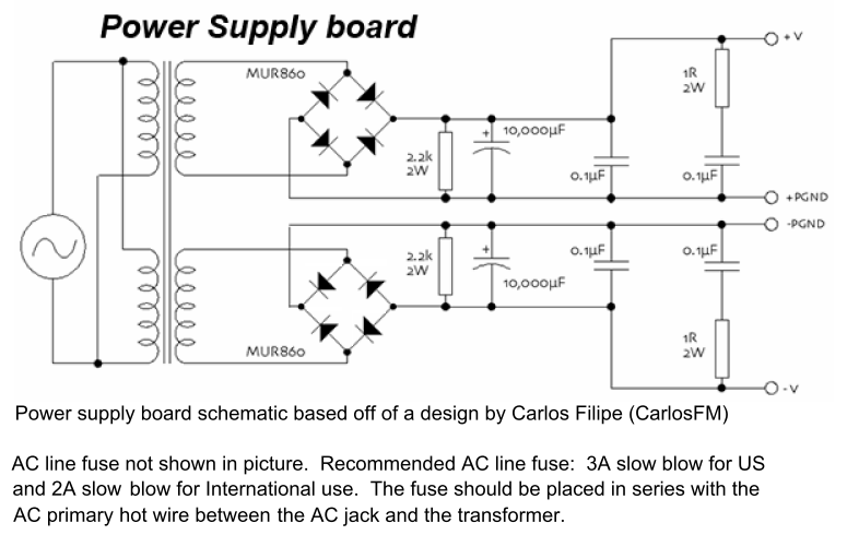

Hi Guys,
Thanks for the help Prasi.
I am looking for power supply design. If possible any one has some good design to feed 35v dual supply with components list then share it to me. It will be a great help for me.
Thanks and Regards,
Namdhakumar
I did something similar to this.
