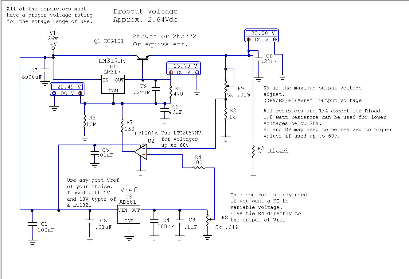

I will post my Final circuit that I have made for the regulator although I have not made the HV version yet but all that will be required is the use of an HV opamp such as an LTC2057HV in place of the LT1001.

That is the same circuit that I have been working with only using more transistors.
It's load regulation is not very good.
I tried adding a resistor from the output to the adjust input to the LM317 and this help but it still was not rock solid.
So, I added a simple opamp and a new Vref and the thing is rock solid now and it does not drift what so ever!!
I have had it on for days and it has never drifted even when a heavy load is connected to it drawing as much as 3 or 4 amps!!

Here is my final circuit with some notes.
R2 & R9 may need to be resized to higher values so that they don't burn up as per Ohm's law.
They don't need any significant amount of current flowing through them as they are just voltage dividers that provide for a gain adjustment (feedback) of the circuit to set the highest voltage level at the output.
I tried to keep them at a lower value in order to keep the residual noise and input impedance to the opamp at a minimum.
Cheers !!!!

Here is another circuit exactly like we are discussing.
0-28V 6-8A Power Supply (LM317, 2N3055)
I noticed the use of the Diodes in order to offset the 1.25v minimum output of the LM317.
I have thought about doing this to allow the output voltage to go all of the way to 0v, But I have not tried it yet.
If this works it is easier than trying to implement a -V that is required to make the LM317 into a true 0V to+ V output regulator when you don't have a means to do so.
Finding this does show that it should be working fine, but it doesn't cover the Load regulation issues I have discovered with this circuit.
